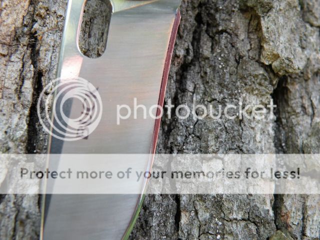

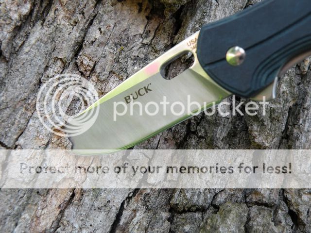

Forgot about taking pics, took me about 15 minutes to do this new paperstone vantage, bit more strop time for mirror polish, but not far off, hair poppin sharp.
Not the Best at photography, Nikon Coolpix P80 I have yet to read the manual on

Wow ok that looks great. I think I'll try Mothers just to see how it does. I am always in pursuit of a sharper edge!
