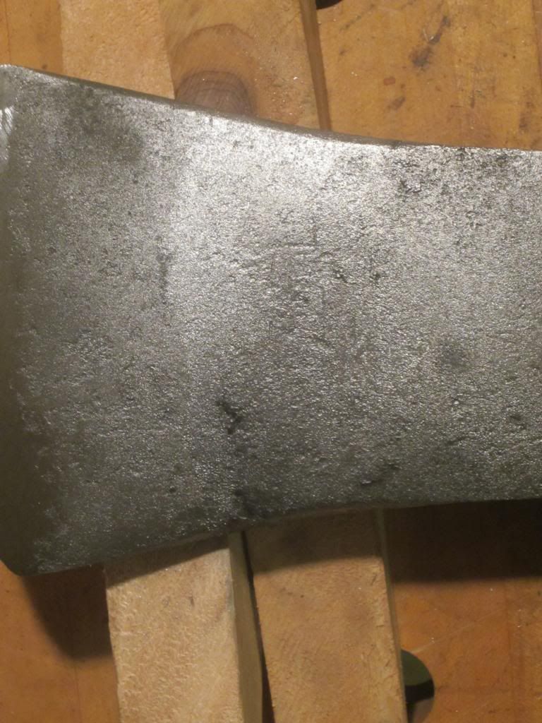

I cleaned out the eye and hit it with a wire cup brush. I wasn't very happy with how it was looking and could find no makers mark. I mean the profile looked good but the patina did not, so I gave it a vinegar bath. After a couple days in the bath and cleaning it up I noticed the very faint remnants of what looked like a Plumb stamp. It is really hard to see and does not photograph well at all.
Anyway, the finish quality of the top and bottom of the head, profile and that faint stamp all lead me to believe that I have a Plumb DB here. It weighs in at 3lb. 7oz., measures 10" from bit to bit and the bits measure 4" from heel to toe. I have yet to look into what pattern this is.

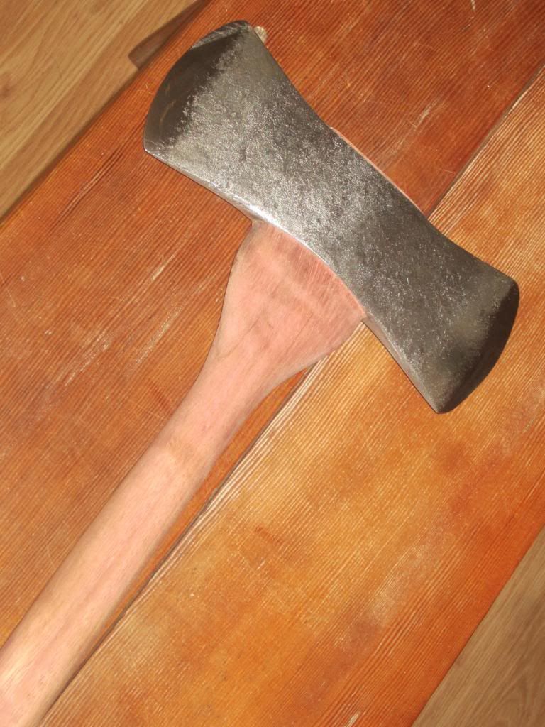

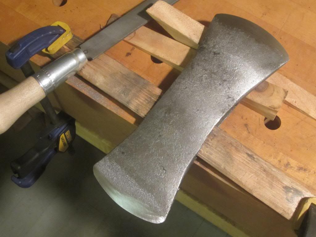

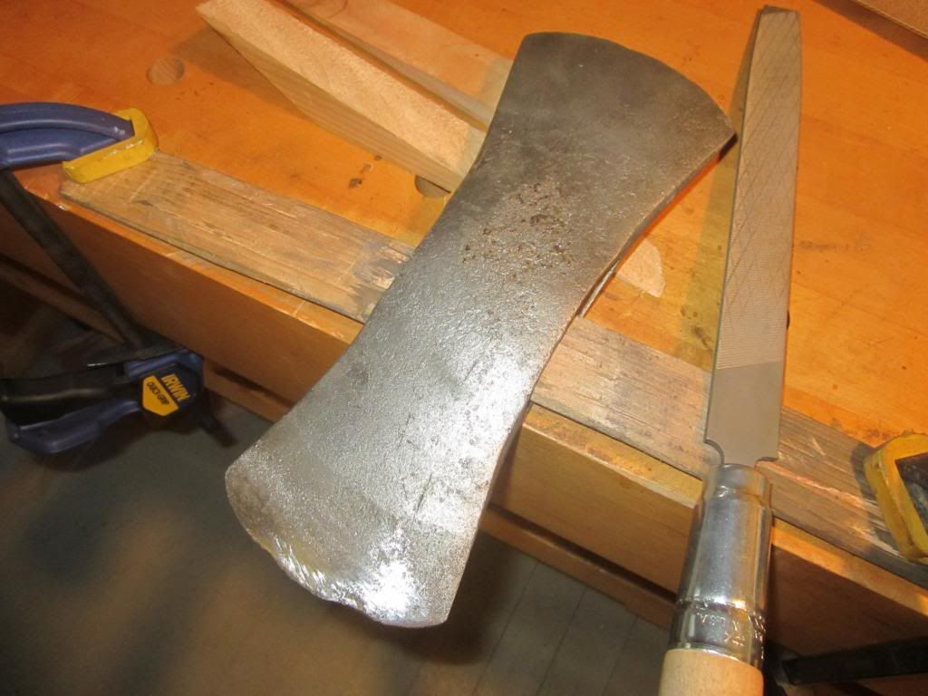

Today I began filing the bits. They were heavily dinged up, even chipped, but I saw no evidence of a grinder being taken to it.
The bits cleaned up nice and once I got past the pitting and chips the metal was quite nice to work with.

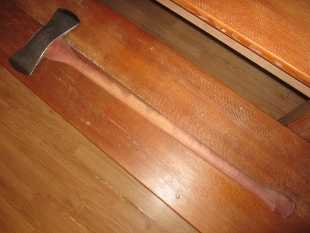

About a week ago I was gifted a piece of purple heart that was long enough and thick enough to fashion a haft out of. The grain orientation was not good but I did what I could with what I had and it was free. I would not have picked poorly oriented purple heart for this full size axe but since it came to me at no cost I figured it would be a good experiment. So I carved it out and hung it.
I will let it sit around for a few days and let it turn more purple before I put a finish on it but this is what the axe looks like now.

Your setup for filing is clever. Clearly it's allowing you to put a nice grind on an axe. And it looks like you found a fresh Multi-kut.
Thanks. I recently bought the Simonds Multi-Kut file brand new at Tacoma Screw for about $16.

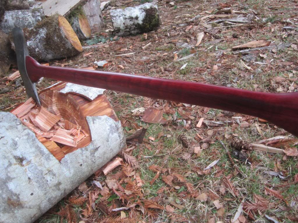

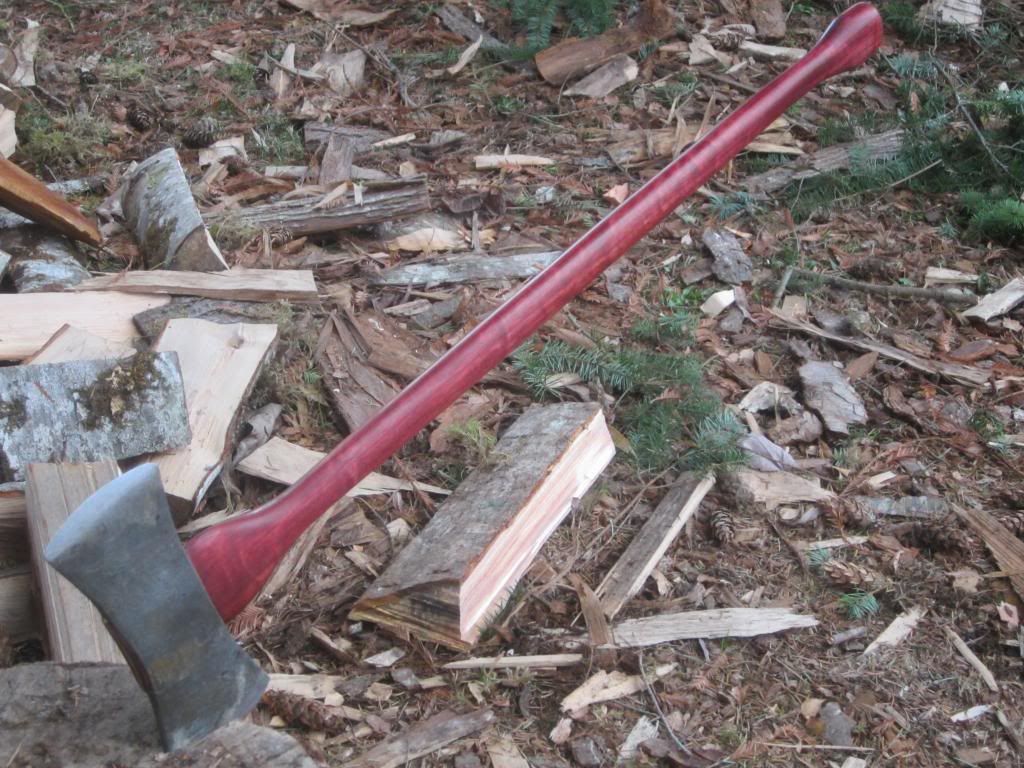

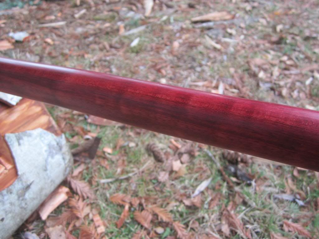

I put 5 coats of BLO on the haft followed by 4 coats of tung oil. I like how it brought out the figure in the wood.

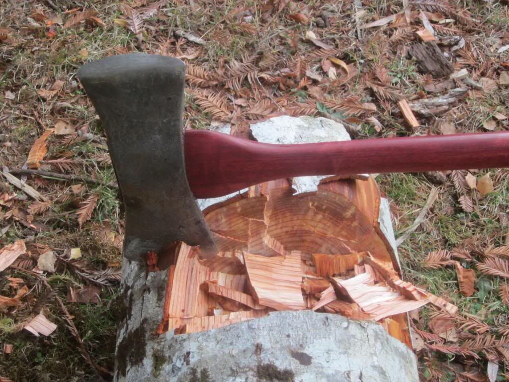

I took it for a test drive and it seems to chop well. This test was performed on an alder round that was bucked up back in early September or so.

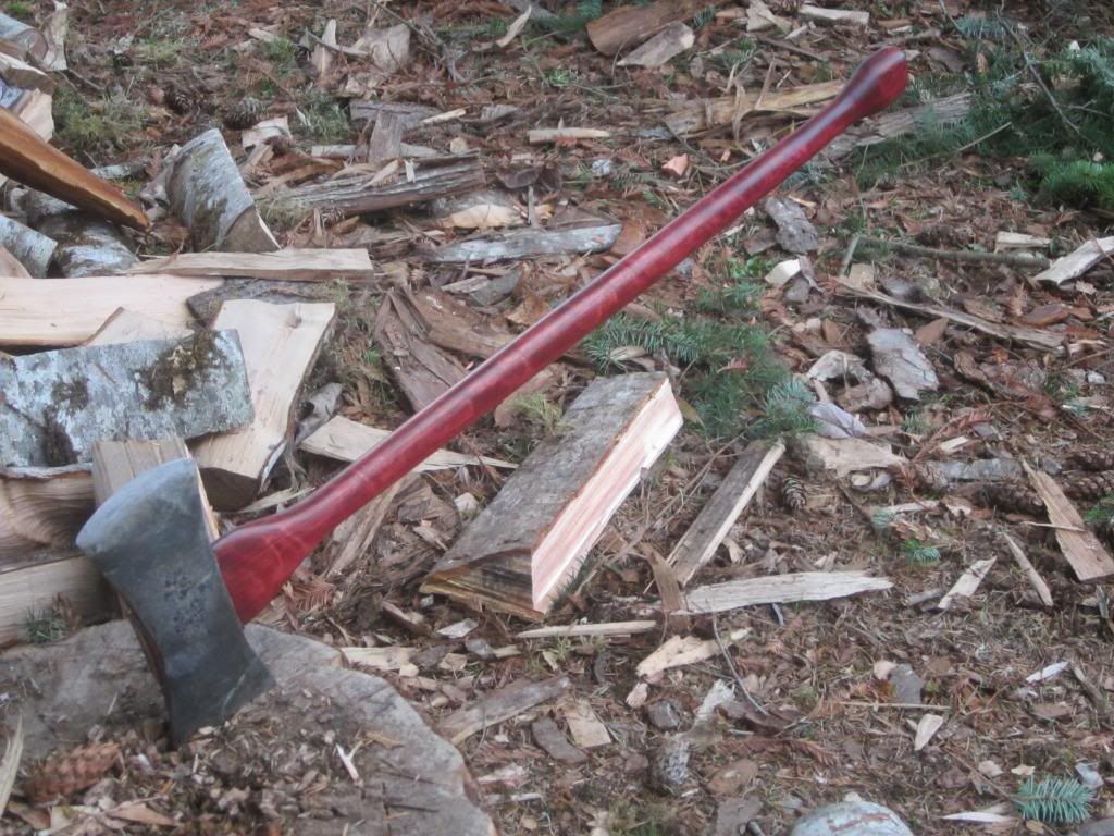

The haft feels good. I made it a little thinner than my last db haft and at 34" its a little shorter too. With this being purple heart I was conscerned that it would transmit excessive amounts of vibration but I did not notice much vibration at all on impact.

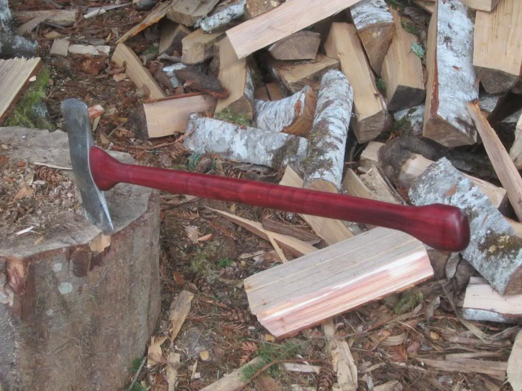

Would I make another full size haft out of purple heart? You bet I would. Would I buy purple heart over some other more conventional wood used for hafts? No. This was a fun experiment and even though the grain is not particularly well aligned I am glad this piece of wood came my way. This stuff feels solid I doubt the grain alignment will ever be an issue.
I like the overall look and feel of this axe. It will make for a good chopper. Now I just need to wait for the day that I need to chop something.
Oh, almost forgot to mention it is most definitely a Plumb.
It's gorgeous and the purple heart is just so appropriate for an old Plumb. It matches that color that Plumb used to stain their handles.
With that slim handle and large swell I bet it feels good in the hand, too.
