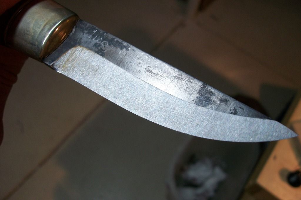

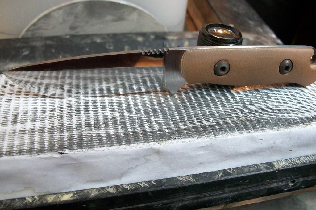

The Scandi below was done on a wet wheel with a jig that allowed 1.5° shift from shoulder to edge, terminating at 12° (IIRC). The convex beneath it was done on a belt grinder with a jig and goes from 0° at the spine to 12° at the edge per side, finish stropping will get it up to the 26 or so needed for better edge stability. As with every grind, making it thicker at the edge is never the problem.
