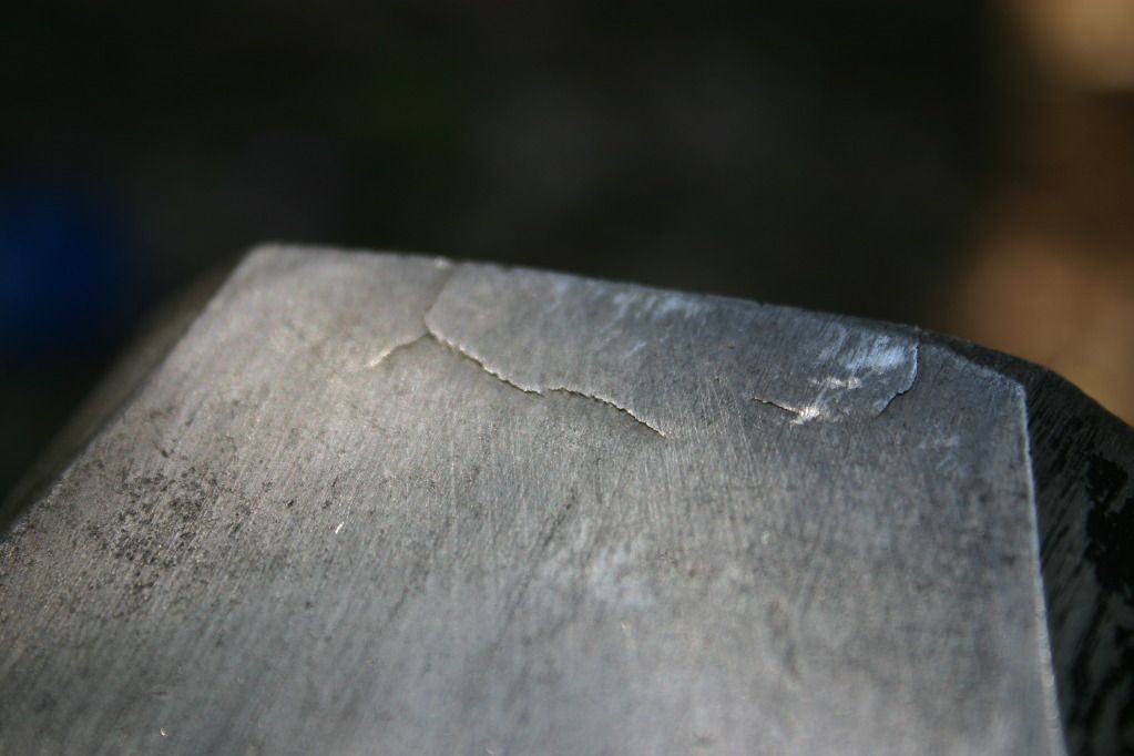

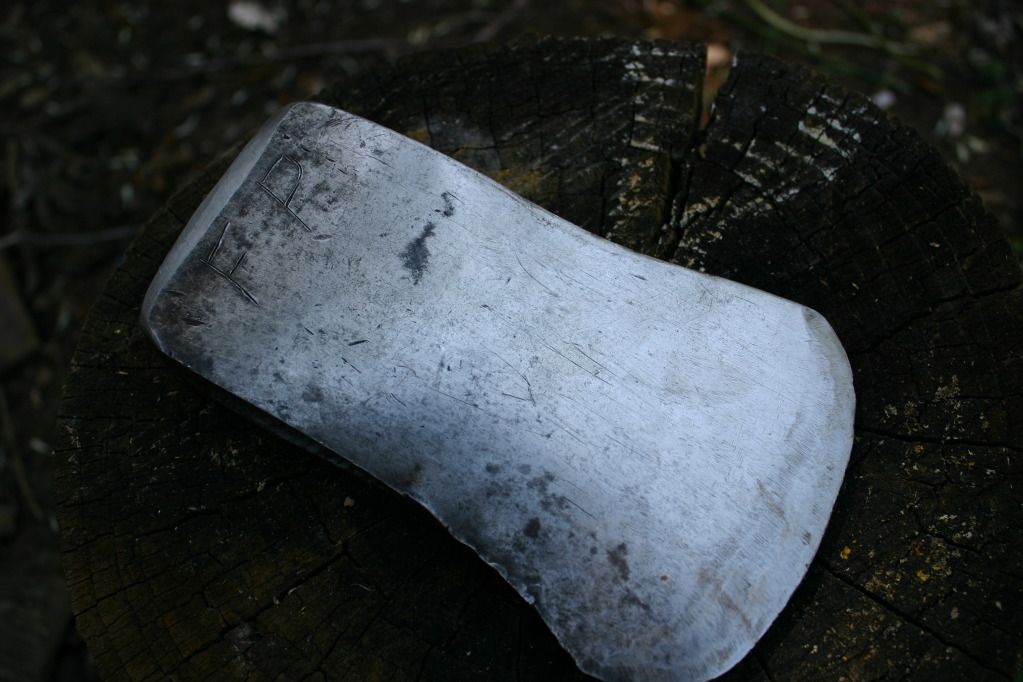

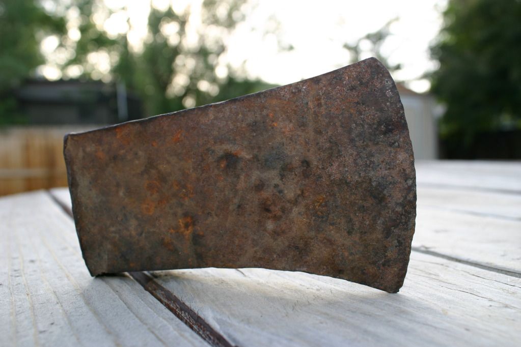

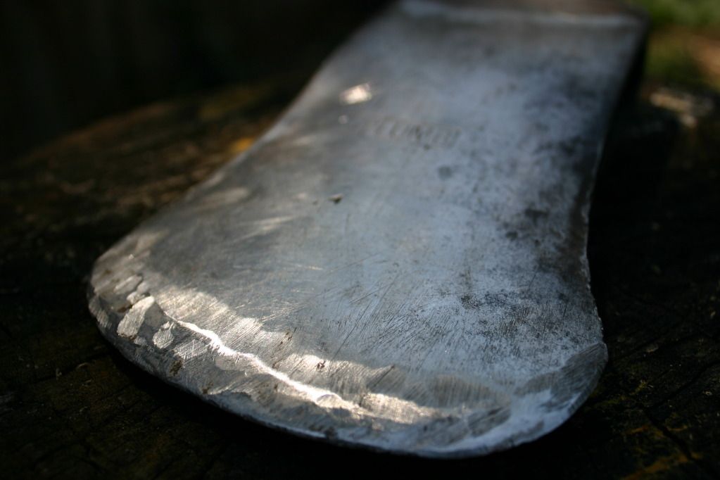

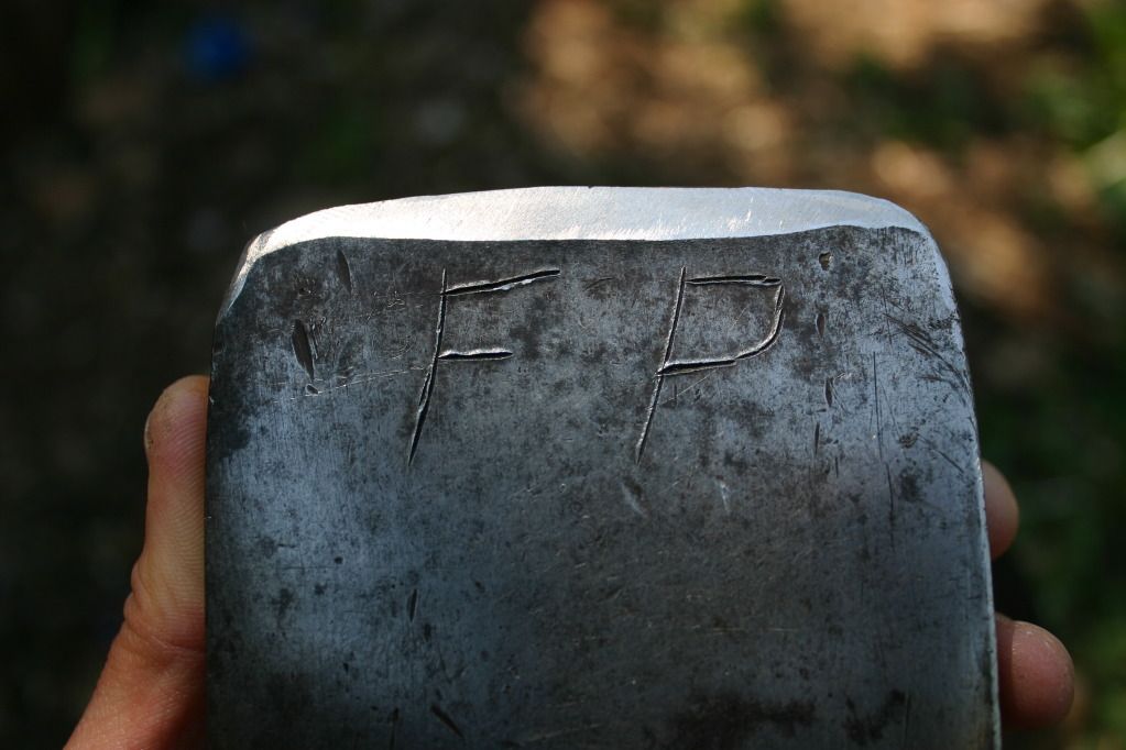

Here is the first Plumb that I found. I have begun to take care of the mushrooming and rust, but I still have some work and cleaning up to do.
My grandfather scratched in his initials, as you can see. This guy will never leave the family....

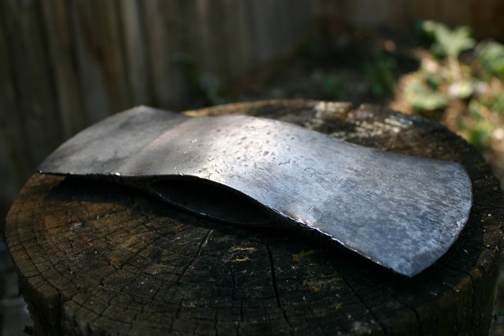

It looks like Grandpa Ferdie took this old girl to a bench grinder :eek:

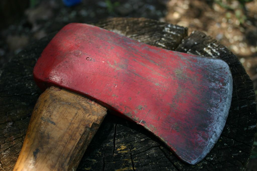

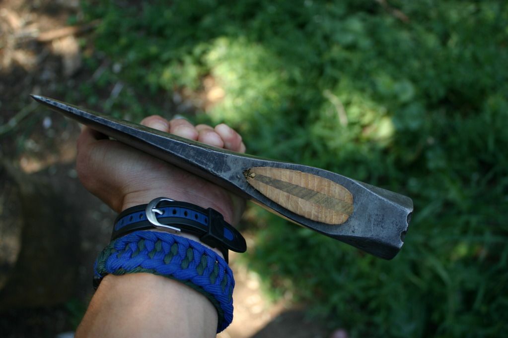

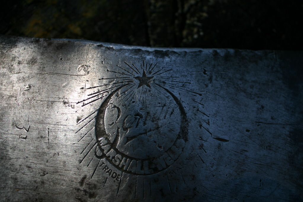

This Zenith Marshall Wells was found at a garage sale last weekend. I got her for $5, and she was hung on a single bit handle. When I tugged on the head a bit to see how loose she was, she came right off!!!!!
If you look where my thumb is, she is stamped with a '4'. She also has a stamp of 3.1 on the left bit, but I forgot to take a pic of that...sorry fellas!

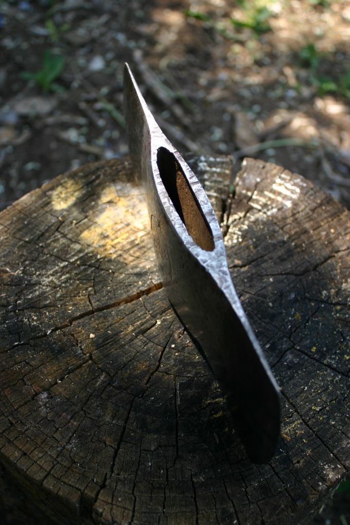

I have been filing out the mushrooming in the eye, I though for sure that I would have had to had her re-drifted, but it looks like I was wrong.

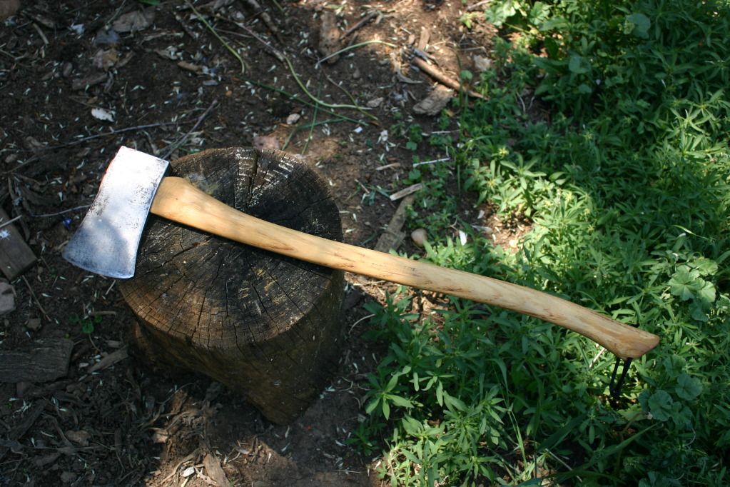

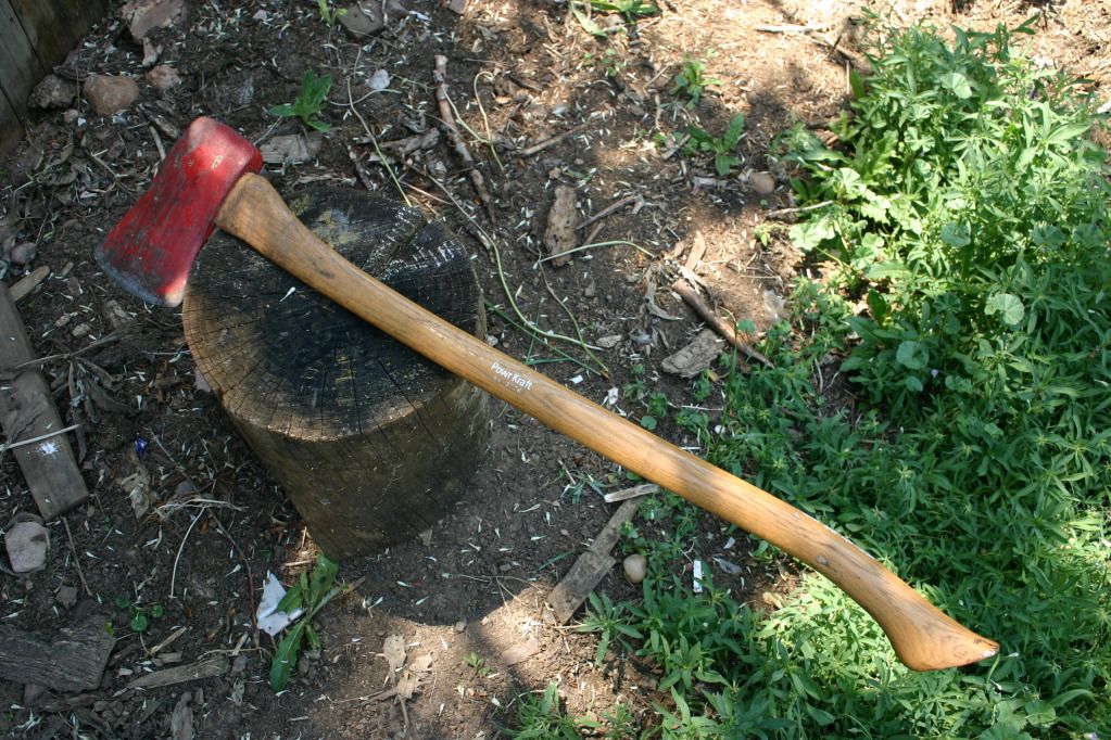

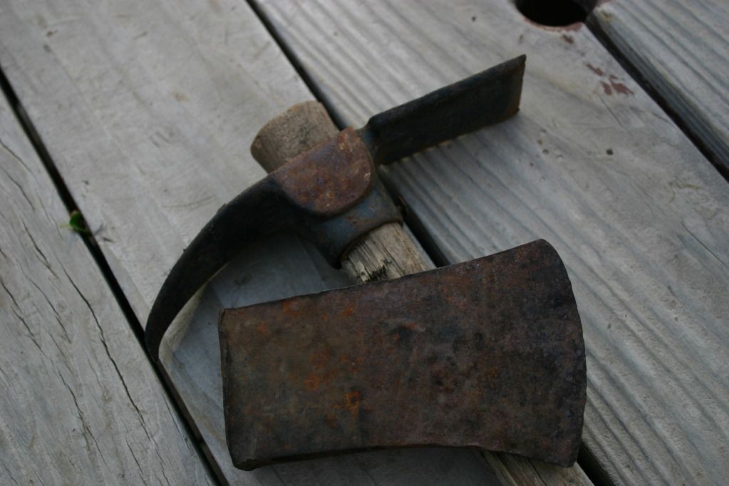

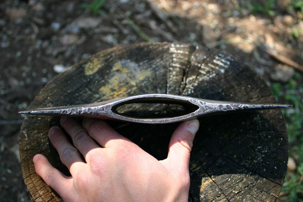

This No-name was acquired at the flea market for $7 and is now my backpacking axe. I estimate that she is roughly 2lbs, but I have not measured.

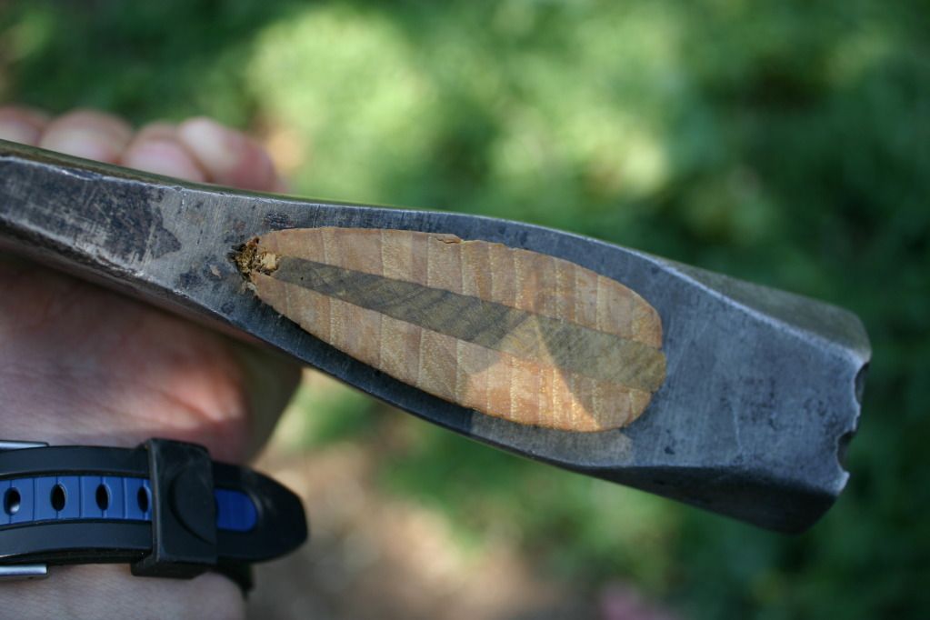

I was trying to put the metal wedge in a little crooked and when I hit it with the hammer, the darn thing rotated counterclockwise and split my darn wedge!! Looks like I will have to do it again...

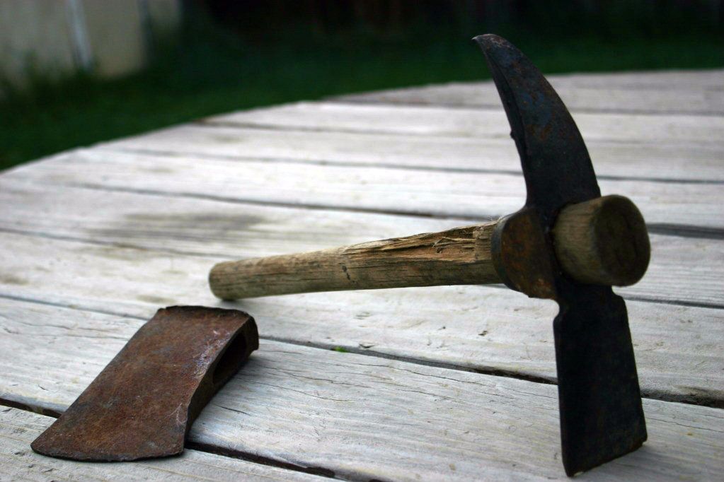

This here is the second Plumb that my Grandpa gave me. I threw on the only handle I could find so I can show him his axes before he passes; the grain is horrible, but I just wanted to get it done. This was also my first hafting job as well!
He used his tools hard, I suppose.

Very nice start to your collection. Your Zenith, made by Marshall Wells is a quality axe. It should serve you well. Your first Plumb is also a quality axe Reprofile its edge and you'll be all set. I really like the Plumb that you got from your Grandfather...It is called a rafting axe and a 5 pounder is a rather large one. Rafting axes are not that common, and as a matter of fact, it's the first 5 # rafting axe that I've seen. Many rafting axes had hardened polls. That maybe why you can see a crack in the metal on your poll instead of the poll being mushroomed. A family keepsake and a rather rare axe, so SWEEEET.
My regards, Double Ott

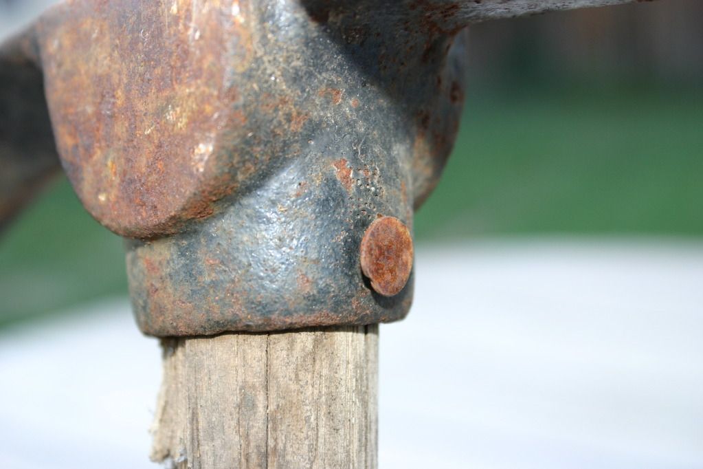

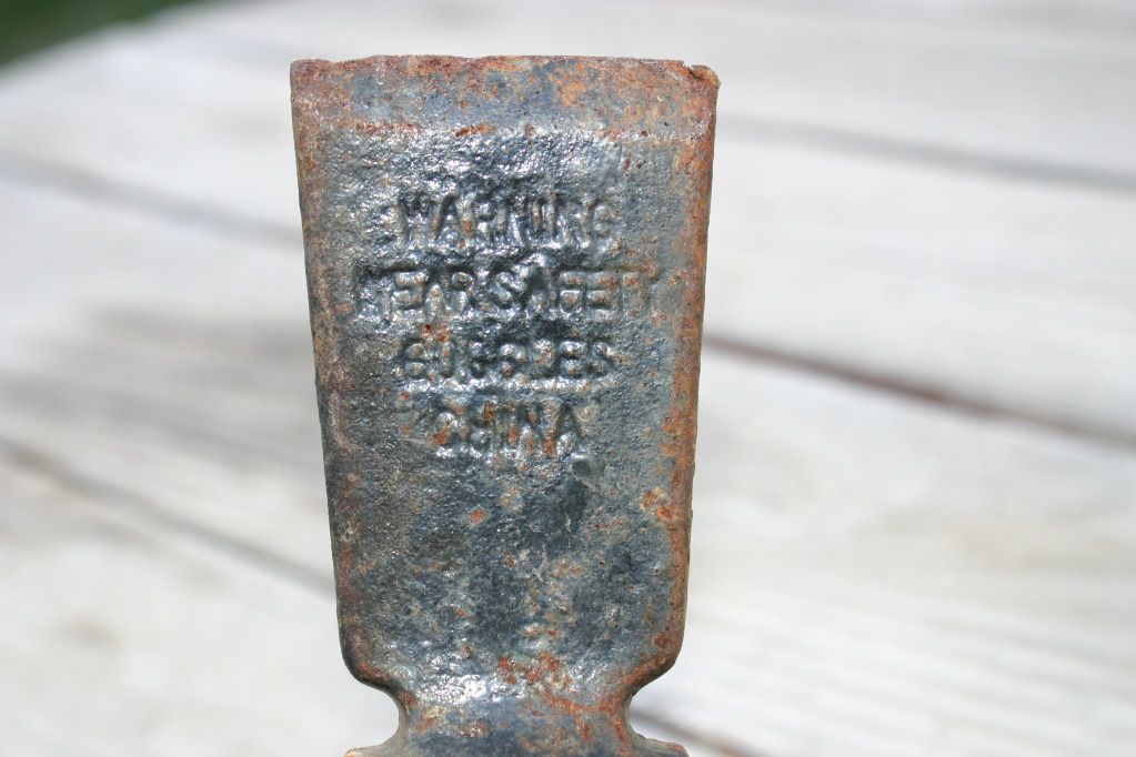

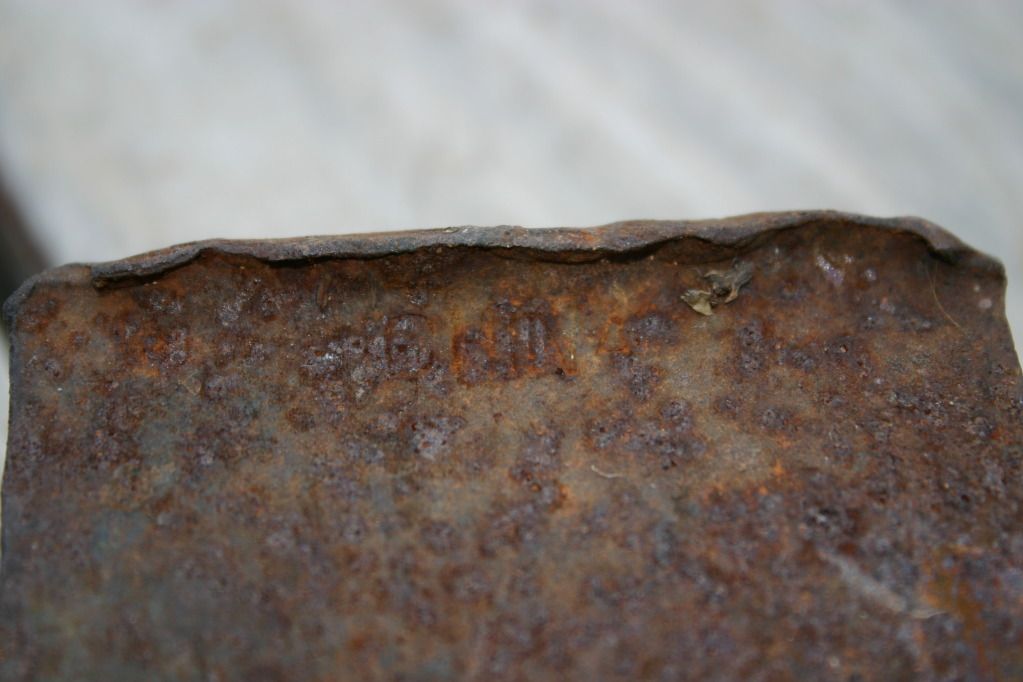

Here are some pics of my haul today, I now have two more tools and, potentially, a new friend in the neighborhood!
Stamped 'China' and warns to use goggles...meh, I still love it
You can barely see it in the pic, but it says 'China'...ah well:rolleyes:

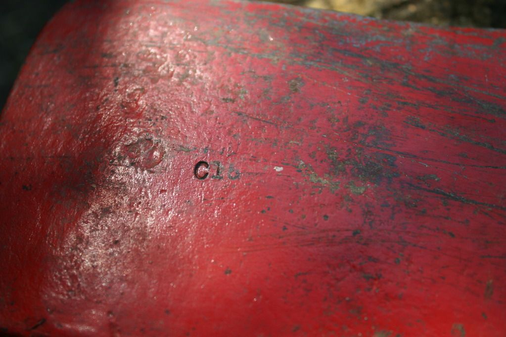

sweet collection. i have an axe with C-35 stamped on it. its a Dayton pattern, also red. my Dad was not an axe user. it was my first axe, and my favorite. its not as nice as my Plumb Boys axe or my Collins. i'm dying to find out what these "c" axes are... cant find out........ help

I have been trying to find out myself, but to no avail.
C axes were most likely from the Kelly Woodslasher line. They were pretty common, painted red, and usually had ribs in the eye. The "c" designations - I don't think a lot is know about those - why exactly used. Kelly did a lot of that with letter markings - you will find various axes c22, c47, and then in hatchets you will see many combos - thtf, etc. Not sure what they mean.

thank you, Operator. i searched for an answer probly 20 times. i knew someone here would have answers. i really wish i had a camera, so i could share my small collection.
