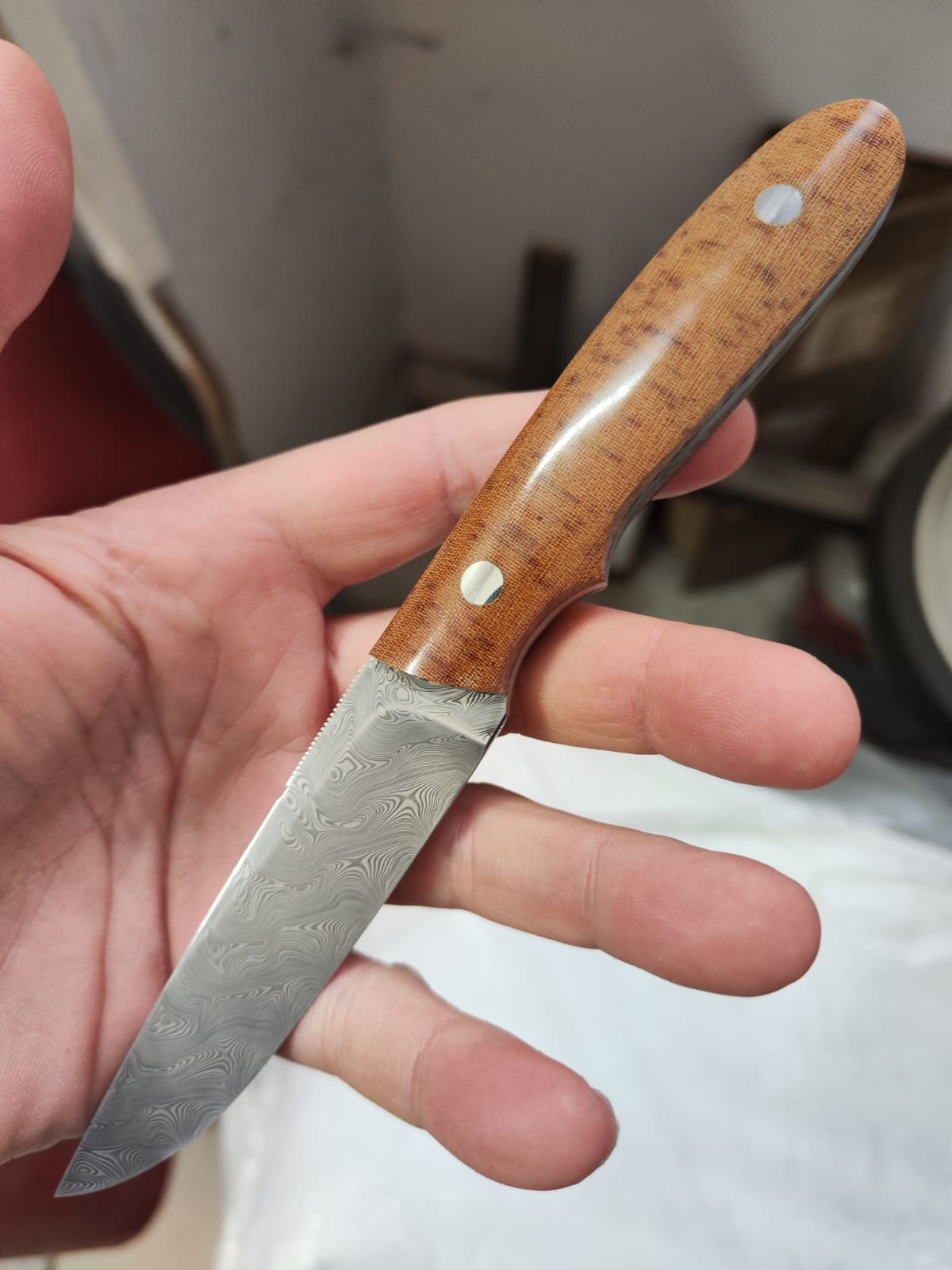

Good afternoon Guys (it's afternoon here in Italy), it's been a while since I posted but I always follow the discussions with interest. I have a question for you: has it ever happened to you to work a micarta that was initially of one color and then turned out to be a very different color?

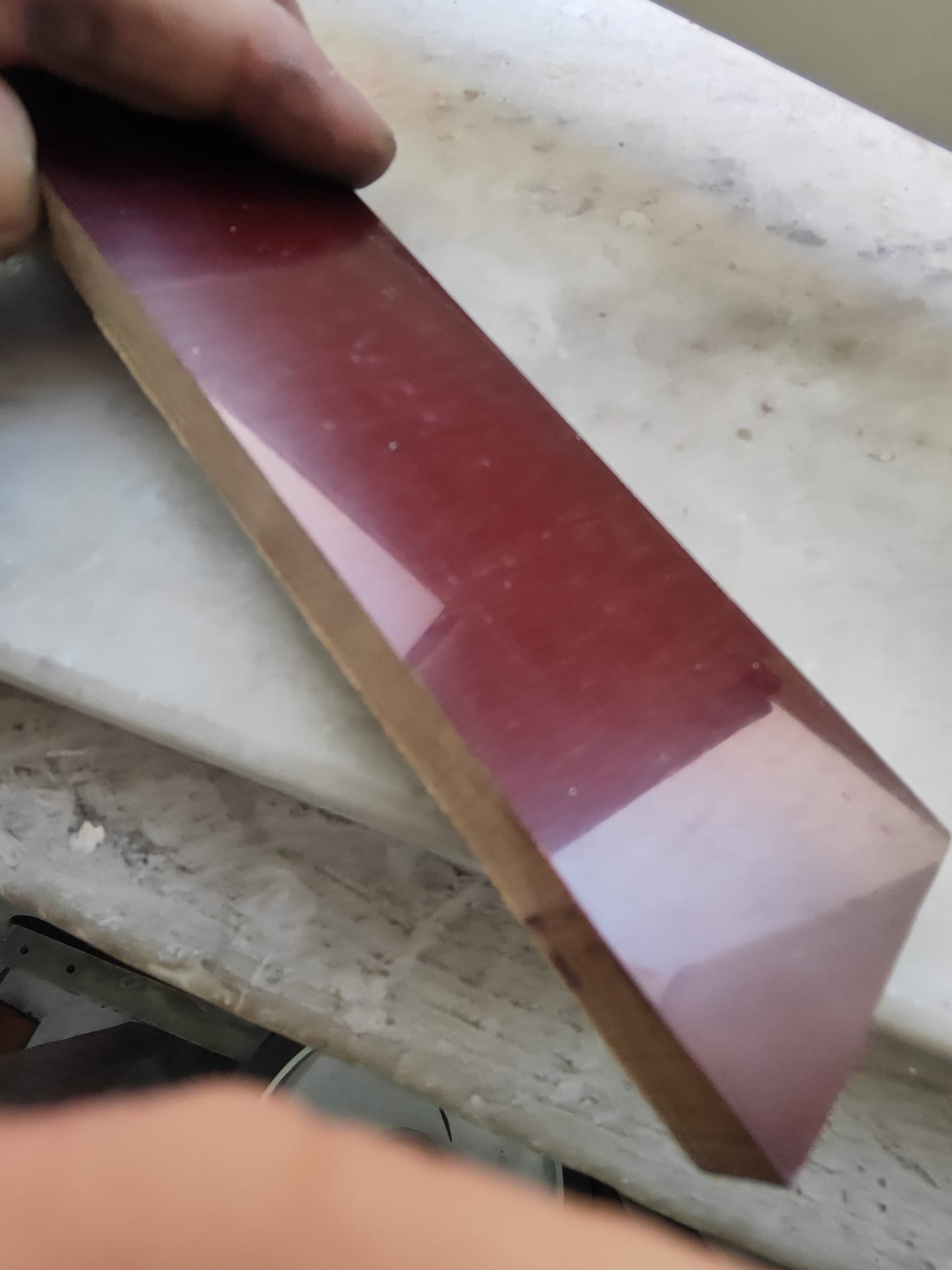

Basically I had some burgundy micarta purchased at the Blade show many years ago (15 years I think), initially the piece had its beautiful Burgundy color but when I started working it I realized that something in the color was wrong, I wanted to complete the handle anyway and you can see the result in the photo, I must say also a beautiful color but completely different from the one desired.
Starting point

the handle has already been disassembled and I'm waiting for new burgundy micarta but I'm still curious because in all my years of knifemaking this is the first time this has happened to me.
I've seen that some micarta will discolor with age and exposure to UV and develop a "bark" on the outside. You can sometimes tell that this is the case by grinding the edge of the scale at an angle and check the depth of the "bark"
Welcome to the joys of Micarta! The burgandy color you saw is the patina layer on the outside; its most likely natural micarta. The phenolic resins patina and darken with age/UV light exposure. As you cut into it, you expose fresher micarta that hasn't patina'd yet, so it looks lighter. OD green typically darkens to brown. Natural is a lighter color and turns darker over time. There is an actual burgundy that was made that was burgundy all the way through.
Beautiful knife by the way! The handle will darken as it ages; in a few years, it will most likely be mostly dark brown.

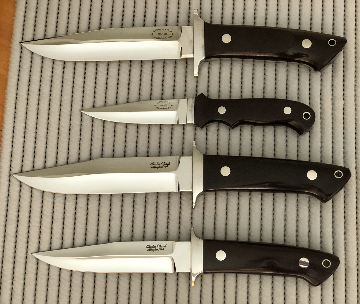

Clearly it was not what it was advertised as. I have a lot of Burgundy Micarta knives made by makers from all over the world over a long period of time, and none of it looks anything like that.
Proper Burgundy Micarta is absolutely solid throughout. I have handled many Loveless's and Johnson's with Burgundy going back to the '70's and they are all a solid colour throughout.
Here are a few of mine..........
