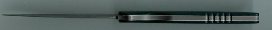

Here's a scan of the edge of my new Sea Wolfe. It's 1/8" stock, with what I would guess is 1/8" G10. It's REALLY thin. Still getting used to it, but I think I'll like it more as it grows on me.

I meant to order the 1/4" scales but I goofed. Not really goof but I just meant to buy 1/4". I kind of like the thin handle like the pic above, it looks pretty sleek.

The edge profile/proportions looks fine to me. I tend to think a thin blade calls for a thin handle just for asthetic balance. No doubt it will feel different to the hand, not that there is anything wrong with that, just different.
