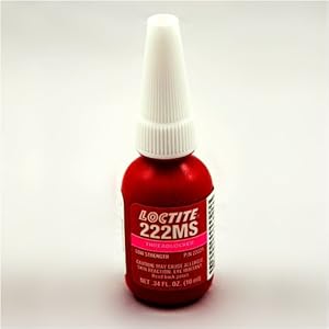

I would not glue the scales. I would use Loctite purple (222MS) on the screw threads only. Be sure to clean the threads of the nut and the screw very well before application. Then assemble the knife. Back the screws out a bit and with the nuts up, pool some 222MS in the hole in the nut where the screw goes. Tighten and loosen the screw 2 or 3 times to get the loctite on the threads. Then tighten the screws down as tight as you want them and wipe away any excess 222MS with a dry Q-tip. Let it set for 24 hours - DONE!
From their PDF >>> "LOCTITE® 222MS™ is designed for the locking and sealing of threaded fasteners which require easy disassembly with standard hand tools."
$12 at Amazon
