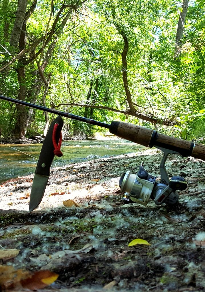

I've been wondering about this for a while... Micarta is probably my favorite handle material - it's so tough, good looking, easy to work, light, strong, etc. But, how long has it been used in knifemaking? I have a Buck 501 from the 70s that is done in Micarta, but I'm sure there are older examples. Wikipedia says Micarta dates back to at least 1910, so I'm thinking the odds are good that somebody started using it before Buck. Does anyone have any solid info? I'd like to have something seriously old to fit in with my ever-growing Micarta obsession.
Here are just a couple pics, because threads without pics are boring ;)

I pressure tested it once by pinning a messed up blade between two 1/8" slabs as a mock pivot. The blade snapped with no damage to the handles or pivot. Im a believer, if you couldn't tell... I've thought about jigging some on the next shadow pattern I put together, just to see how that looks. Another pic for good measure ;)
