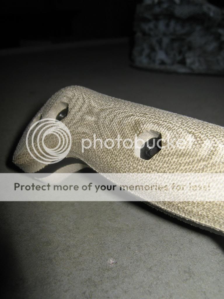

I just purchased the micarta handles from KA-BAR on 1/20/2014 and this problem does still exist. Here is a closeup of the grivory hadles with the factory bolt. Notice the bolt extending beyond the nut.
Here is a closeup of the bolt after I installed the micarta handles. Notice that the bolt does not extend beyond the nut nor is it flush.
Really disappointed that KA-BAR has still as of January 2014 not addressed this problem. Well, I am off to the hardware store to get some stainless!
Just added the stainless steel bolts. The aesthetics of the stainless really bothers me. Will have to remove, mask and paint them to get this blade back to being more tactical.
