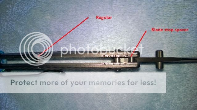

Hi all,
Opened up my new 950 yesterday,, absolutely LOVE it.
Quick question though,, the axis screw was VERY tight out of box,, so I loosened it to the point that I could comfortably deploy it with either the thumb stud, or flicking it open. When I do get it to that point,, there is a VERY SMALL amount of vertical play,, almost impossible to notice unless you really pay attention.
My question is, is that normal? It really doesn't bother me, but if its a problem that could become a larger issue later on, I'd like to exchange it for another 950.
Thanks for any help!
I'm not sure how lose you made the pivot screw. If you lose it enough, it is normal to see some horizontal blade play. I like to tighten up enough for the blade to not to drop down with gravity and light enough for quick deploy.
Hope it helps.
(edit) me bad, didn't see "vertical" Play. Make sure the barrel spacer right above pivot point is the right one (There are 3 in Rift, and it may be wrong one in there)

Yes, it's normal provided it is a small amount and that the play presented itself after you loosened the pivot. Most production knives are going to have blade play and more so if the pivot or any of the stand offs are loose. Making sure the pivot is tight as well as the standoff/spacer screws is the first thing to check, usually. While the pivot has a more direct role in horizontal (side to side) play, it can also affect vertical play as well. Exceptionally dirty knives can also sometimes develop superficial play coming from a less-than-perfect lockup, but that probably isn't the case here given how new the knife is.

To add to what pnsxyr has kindly mentioned, I have added the picture to indicate the size difference in spacers.
Funny things are that 2 regular spacer and pivot stop pin can fit in lines. Does your Rift has any space between blade detent and the pin?

Hi guys, thanks for the info.
I did ever so slightly adjust the pivot screw to where to blade wouldn't drop by its own gravity, but would deploy easily enough,, and sure enough the play is gone.
I think I may have just taken it too loose. No space between the blade indent and the pin though..
I never had and horizontal play,,just a VERY small amount of vertical.
