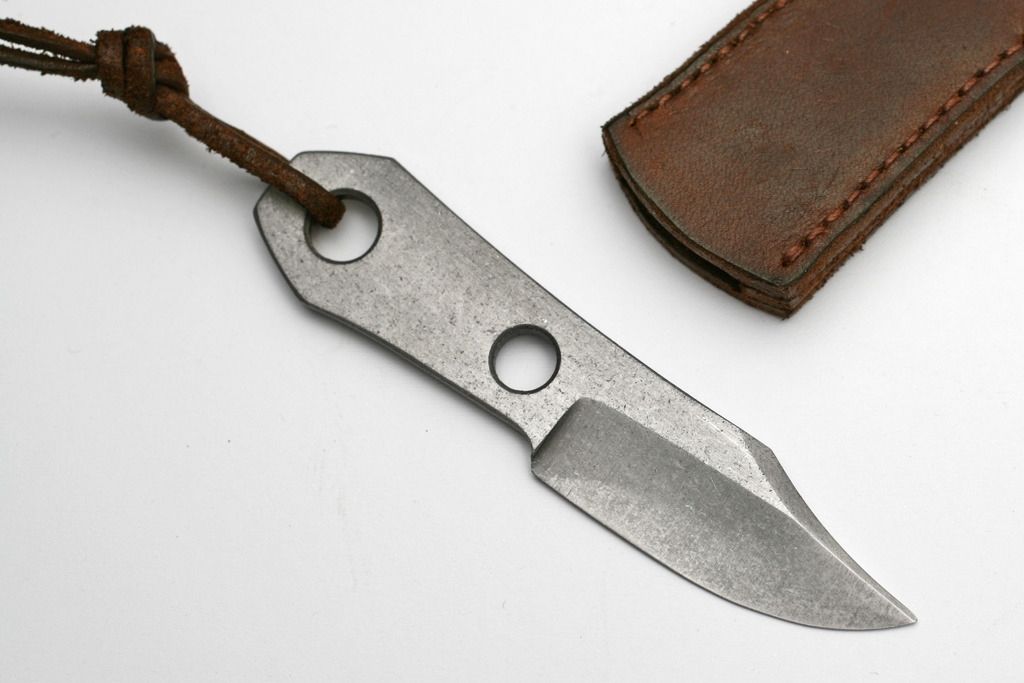

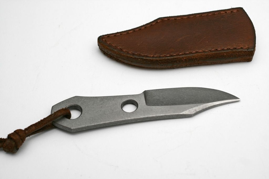

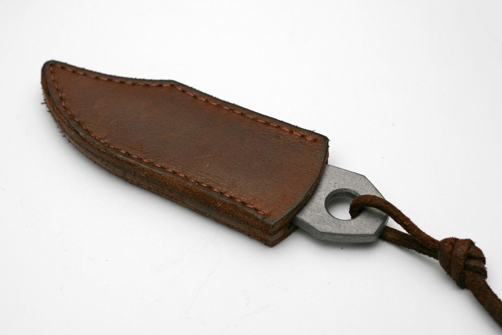

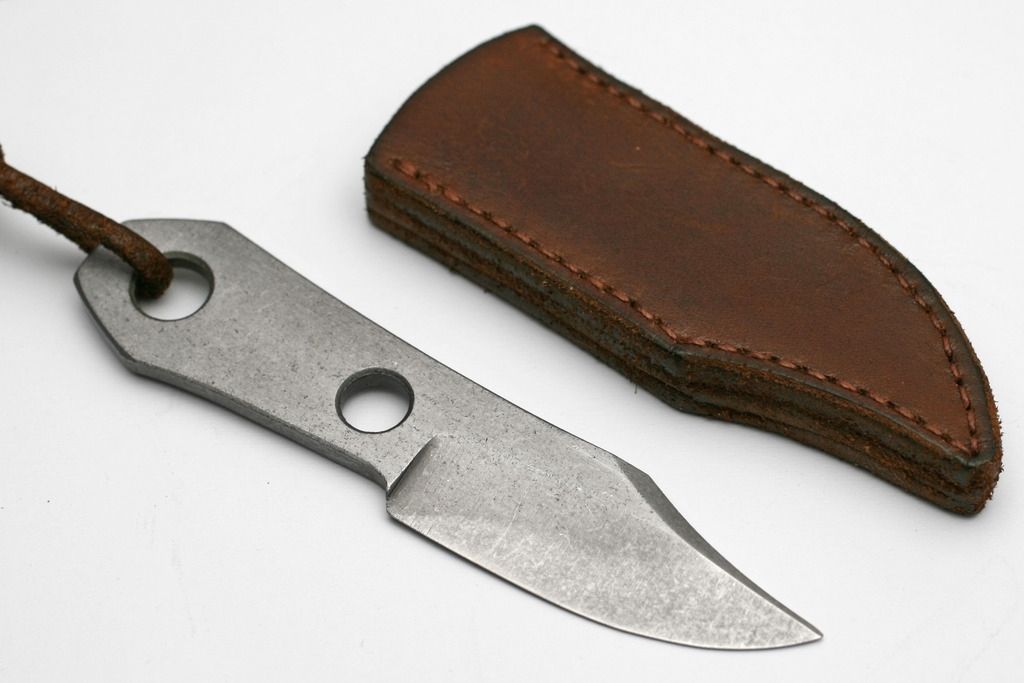

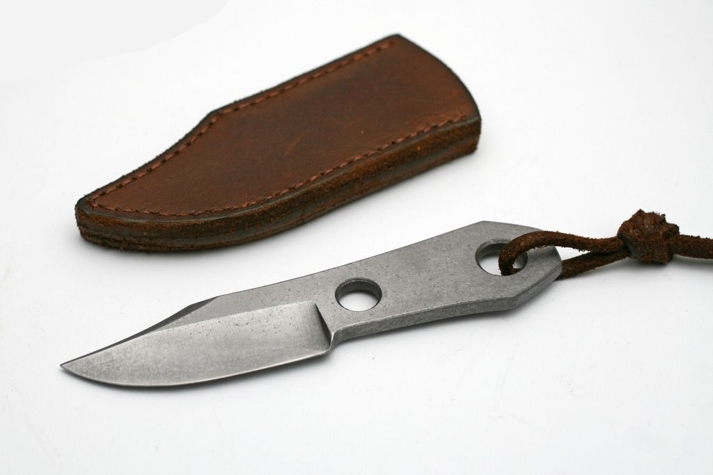

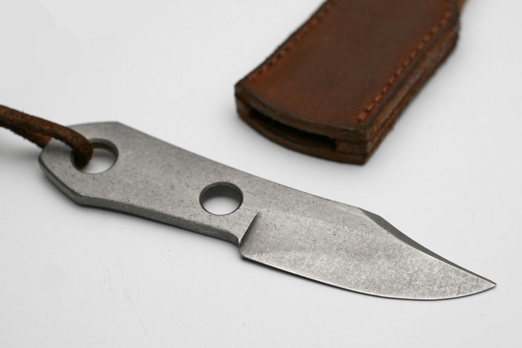

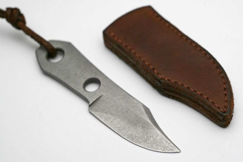

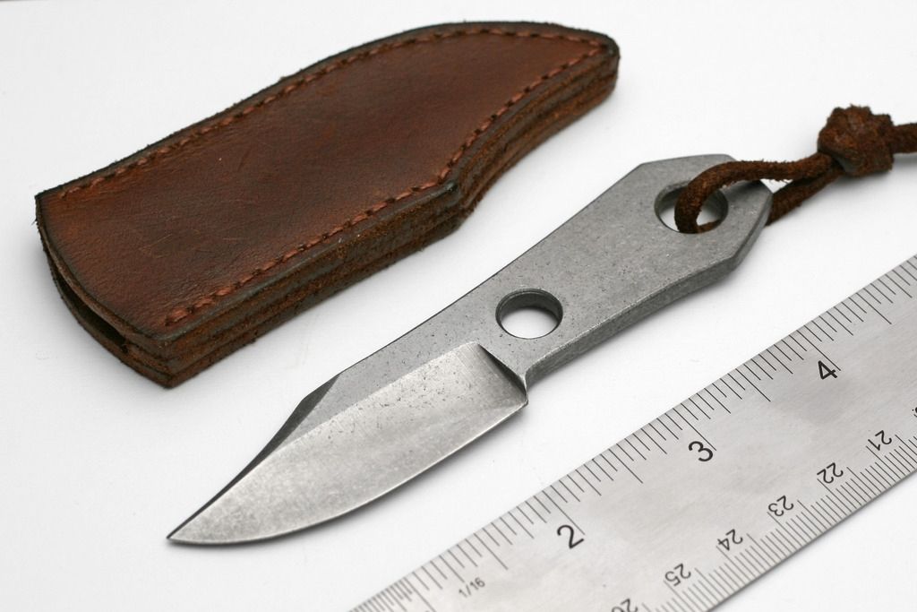

Just finished up the sheath a thought I would take a few pics before putting the final edge on it tomorrow. It's 4.5" inches of 4mm O1, deferentially hardened with visible hamon, 2.25" Blade, freehand hollow ground. Acid etch with a tumbled finished. My first time working leather and credit to all those makers that use it, it's harder than it looks but I'm pleased with the results.
Enjoy!
