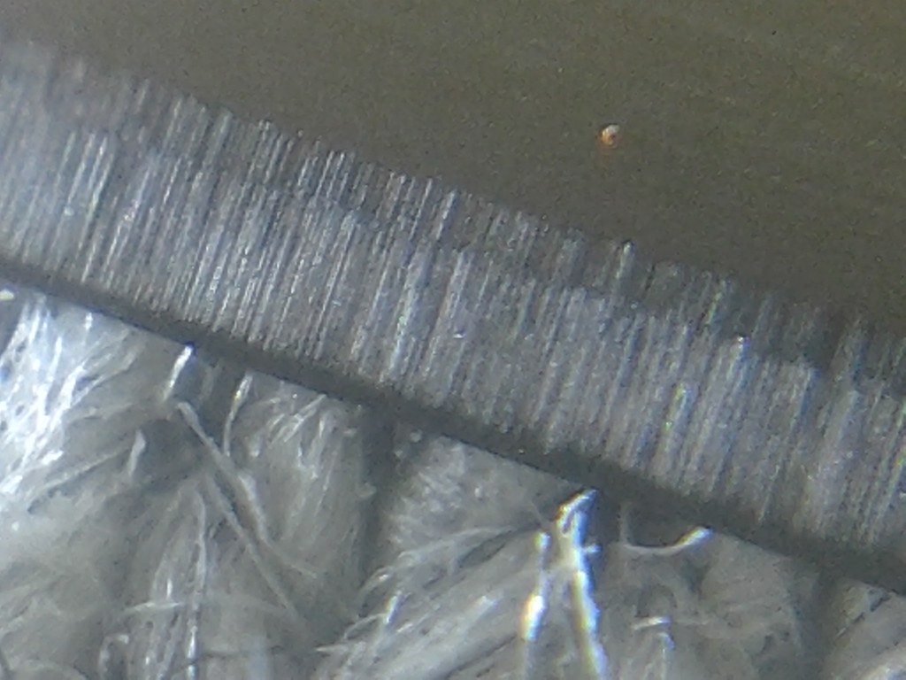

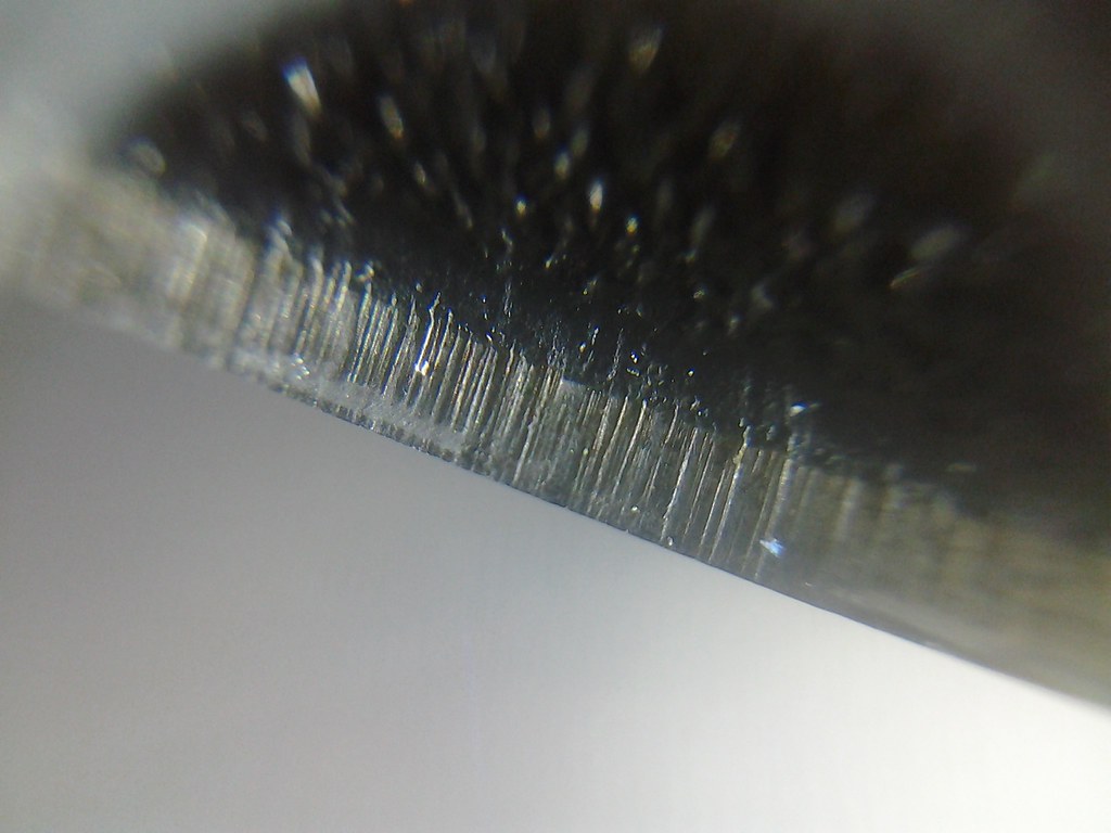

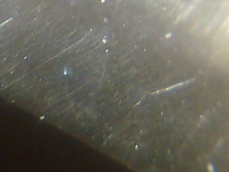

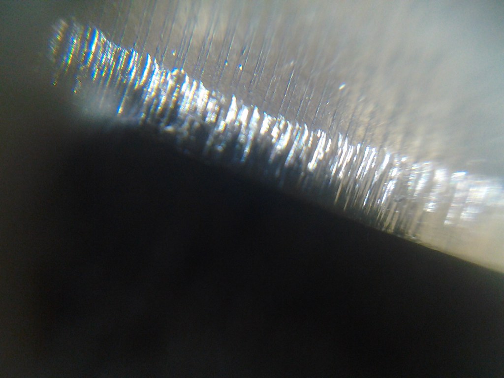

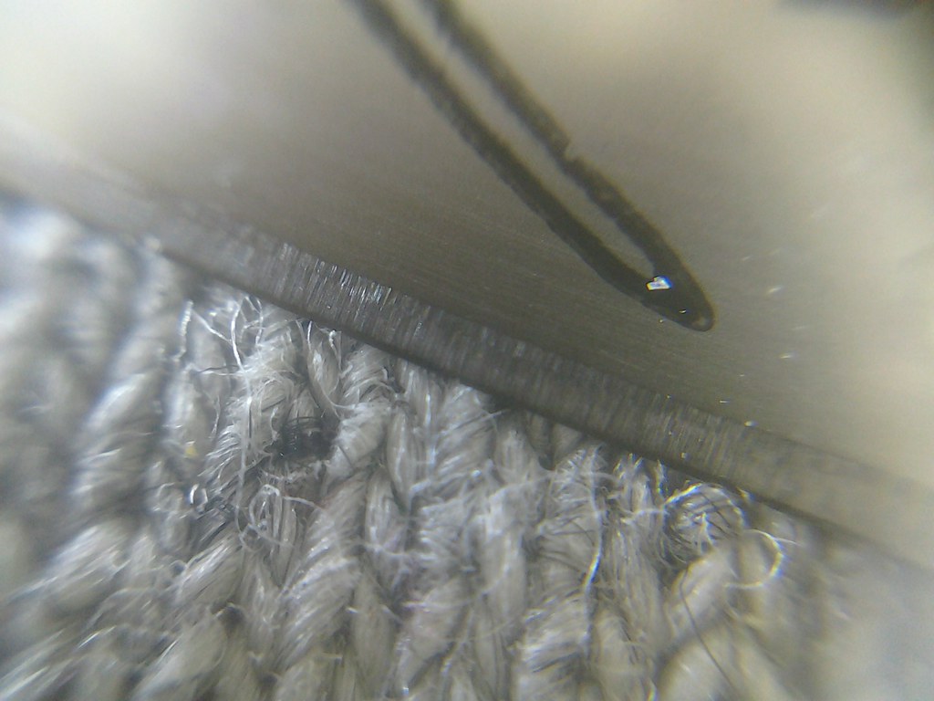

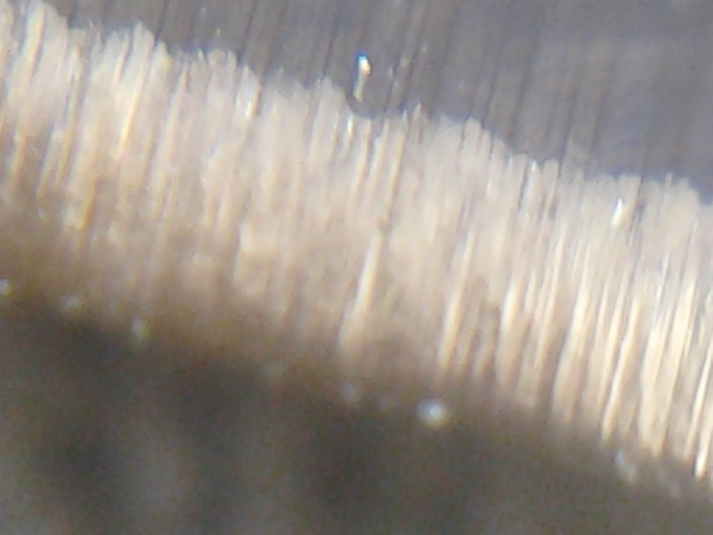

Due to interesting happenstance, my house currently contains one stock edged BK-24 D'eskabar, used only for pressing sheaths, and one near stock edged BK-15 used for pressing sheathes and cutting snacks. also, I have all kinds of razor blades as I'm into the whole DE and straight shaving thing.
What I've done here is to take pics comparing the three at different magnifications, the conclusions I drew were one thing, but I suppose A picture is worth more than my words.
A quick note on the apparatus: I used a lens out of a laser pointer and press fit it into a piece of wood that I tape over my phone's camera lens. it's probably not as clear as some methods, but it's significantly cheaper and more accessible. My phone has a 4x zoom. I took one pic at each magnification as best as I could while shining a flashlight onto the edge of a knife I was wrangling and still take a picture of. --I'm not a great photographer, and due to the cheap plastic lens, it's a little out of focus at the edges, but this should prove interesting.
Now to the fun part, THE PICS !!!!!!!!!!

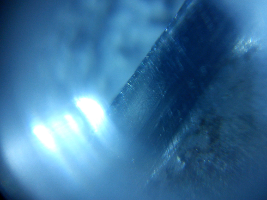

BK-24 at stock magnification:

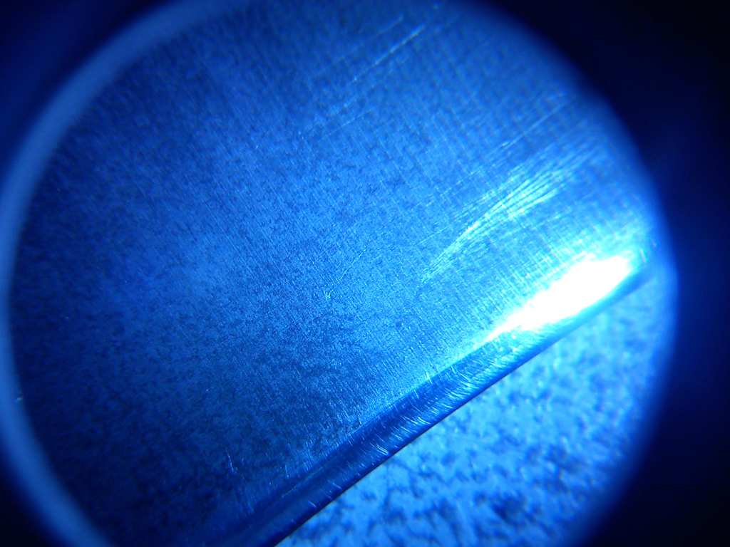

BK-24 at "4X":

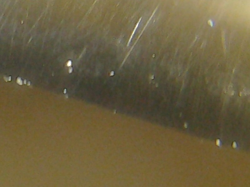

BK-15 at stock magnification:
BK-15 at "4X": the lighting is a little strong, but the scratch pattern is what we're after here

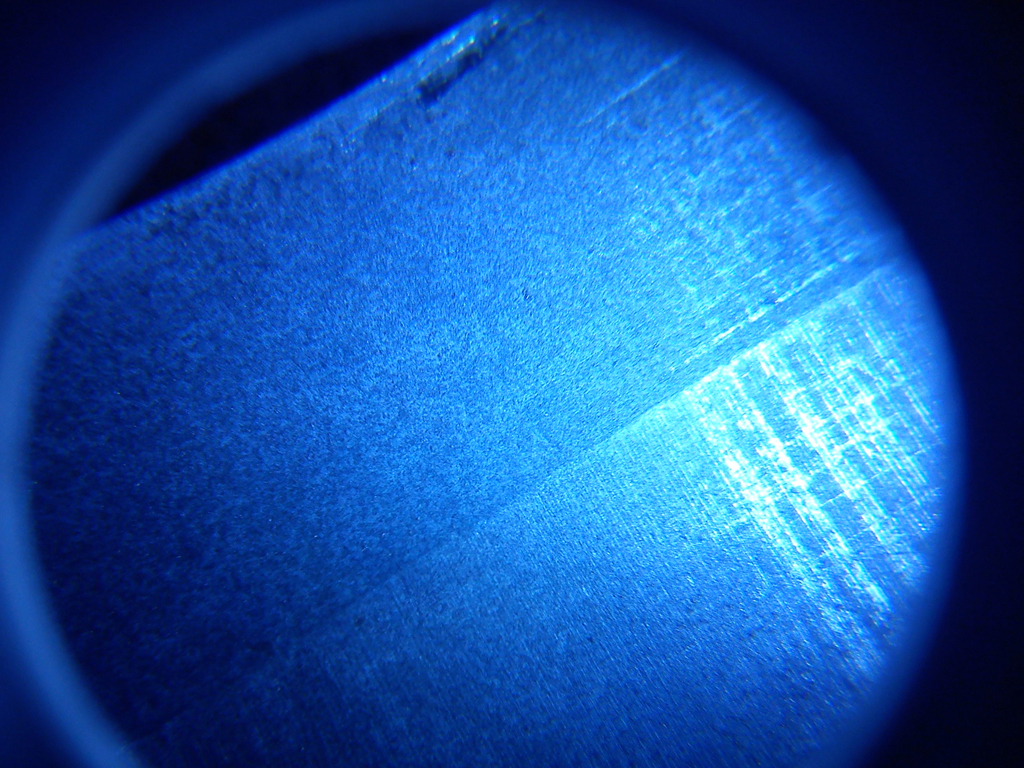

DE blade at stock magnification:
DE blade at "4x":
The thing I took home is just how similar the scratch patterns are (similar grit), the main difference to my eye is that the DE blade has a clear back bevel (seen here as the not quite as scratchy part) and microbevel (seen here as the darker part at the very edge). The stock Becker edge seems to have slightly deeper scratches than the razor blade, accounting for the more "toothy" edge. I don't see a reason a microbevel and some stropping wouldn't create a visually similar edge, but I'm not an expert.
We must also consider the striking difference in stock thickness here: The BK-24 pictured measures 0.164" at the fat part of the ricasso, the BK-15 clocks in at 0.186" with coating at the fat part of the ricasso, and the DE blade at just 0.00035"

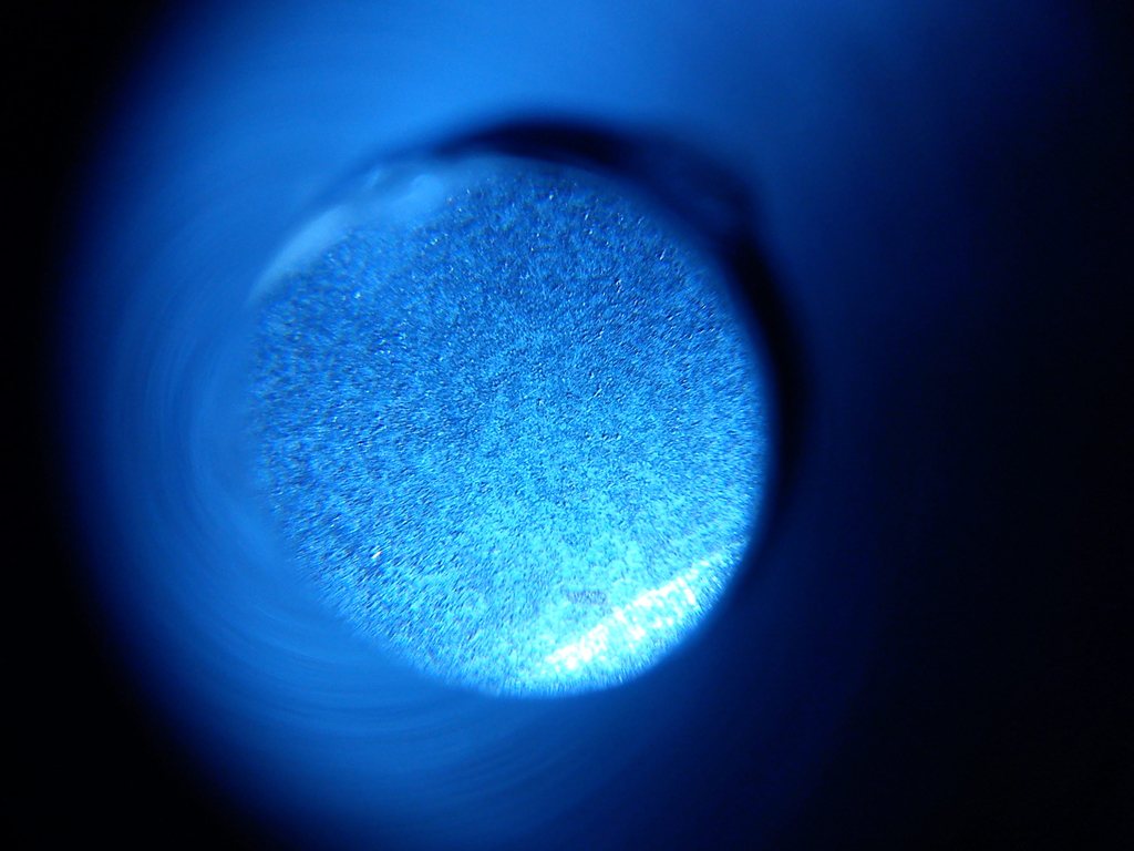

BK-9 at 1x-- you can still see a bit of the factory bevel grind's scratch pattern (I think) then you can see it smooth out about 2/3 the way to the edge from the shoulder.
BK-9 at "4x" this is a look at a chopper that will shave. I believe the same transition is still visible.

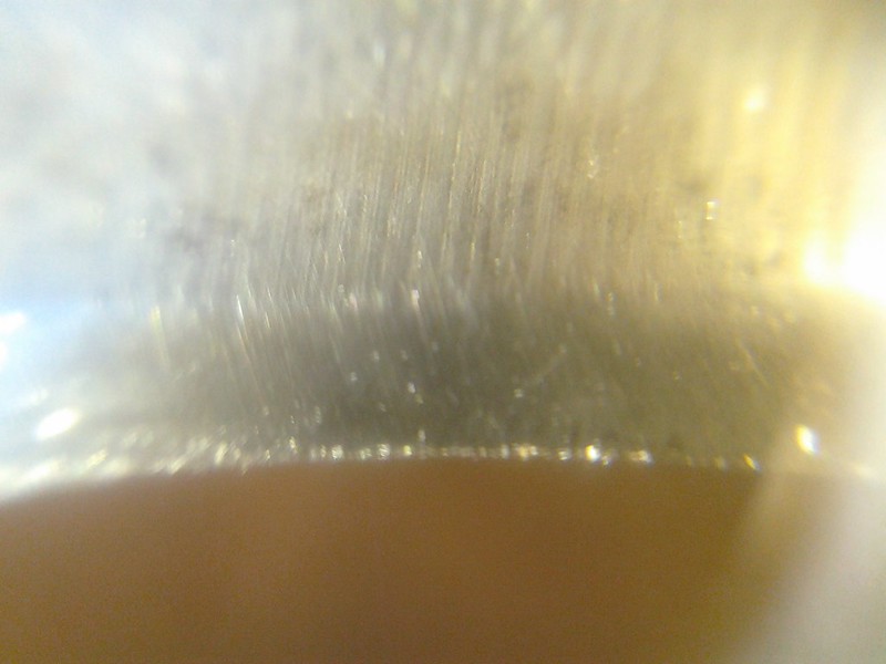

BK-16 at "1x" you can see the flat grind clearly, and then the smooooooth convex my alternate cycles of use and TLC have produced. Also, there's some bonus pitting... she is very much a user.
Same edge, In close enough to see a scratch pattern('4x'), the giant more out of focus bits of white are dust. Guess I should dust my edge first next time. :D
Sorry for any out-of-focusness; I am no photographer, and these photos are a dynamic balancing process of holding a knife, flashlight, and cellphone and positioning all three with precision and all before my coffee in this case.
