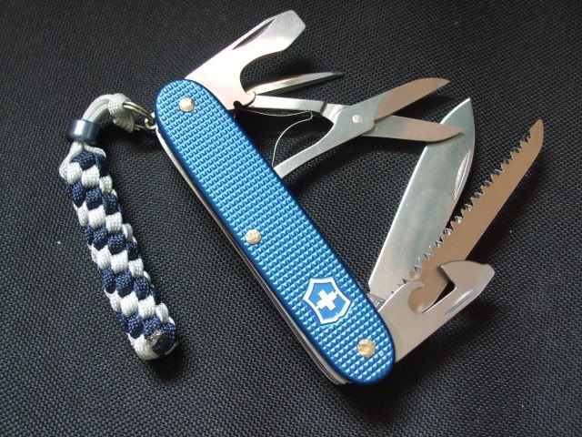

Or you can add scissors (if you can find any) to a Cadet. This is a lot easier than Scibeers mods as the spring and scissors don't need worked on to fit in the 84mm frame. Like this:
The only reason this isn't still possible is that Vic have stopped making (and have no plan to start again) 84mm scissors.
