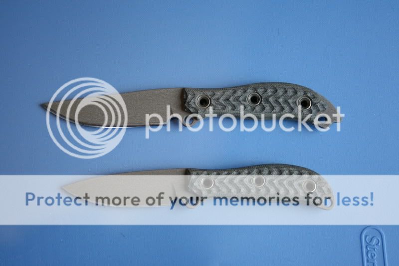

Hey fellas,
Another Hog and I are trying to determine if a blade is an original Heavy Duty or a more recent Miliganza AD in black/black.
Is there an easy way to tell for sure without calipers? Like comparing them to another blade?
thanks!
My HD was .20, while the milies were .187
I don't think the black on black millies had the Busse logo and the HD did?

Eli - I've had the same problem telling them apart. I have a black/black AD and a black/black HD that are almost identical except that the AD is .20 and the HD is .21 and talon hole on the HD is a little smaller.

The best way without calipers is the size of the talon hole, as ceiw stated.
The plunge line is higher on the HDs than MADs.
and I think Steelnut is right, the blk/blk MADs were sterile, I'll check when I get home, I know my HDs have logos.

I had a Heavy Duty and a couple of Mili's at the same time. One distinguishing feature was that the distal taper started earlier on the Heavy. The Mili's saber grind was a good bit further out and maintained the stock thickness of the blade closer to the tip. Because of this, the Heavy actually had a finer point to it (not that it would matter much in use).
