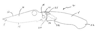

well, this is a stop lock....
No. It has been patented (probably where that drawing came from) but it has not yet been released into the wild. I've looked at the drawings and read the description in the patent application, but I just can't seem to visualize exactly how it works, so I'm waiting for Sal to sell me one so I can see.
Looks like an eccentric cam surface locks into a "shoe" surface and that unlocking will be awkward. Think how a vice-grips works.
Harder you grip, the stronger the lock, though.
I don't think I'd buy a knife with that lock, though. Looks like you pull up on the back of the knife to unlock.
If you look through the design drawings there are several opening methods depicted. That is the part that has probably taken Sal all these years to develop.
I bet it'll be just as usable as anything else out there, and just as reliable as the Compression lock.
(I love it when the owner of a knife company is a mechanical genius.)
I don't like the compression lock, either.
Read the specification : http://www.google.com/patents?id=obMTAAAAEBAJ&printsec=abstract&zoom=4#v=onepage&q=&f=false
Gets around the ARC patent, but the concept is the same. Throwing in levers for actuation is an addition.
I do like the combining of functions to include a blade stop, though. I guess that is novel.
Probably we'll see a lever or slider actuated version, so the thumb can actuate it.
I wonder how wear affects the design. Not a simple design to play with.
