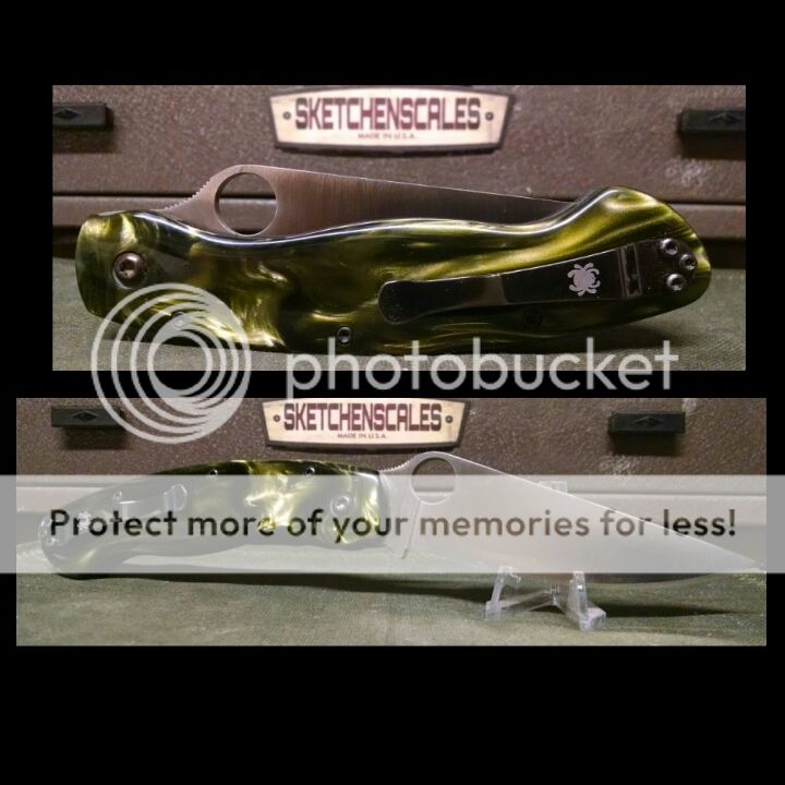

The newer military models do have steel liners on both sides, and there might be enough space for clip holes if you want to go tip down. With the curve on the stock clip, you'd have to use a different one though.
Glock_566, send me an email at Sketchenscales at gmail.com if you'd like to discuss.
