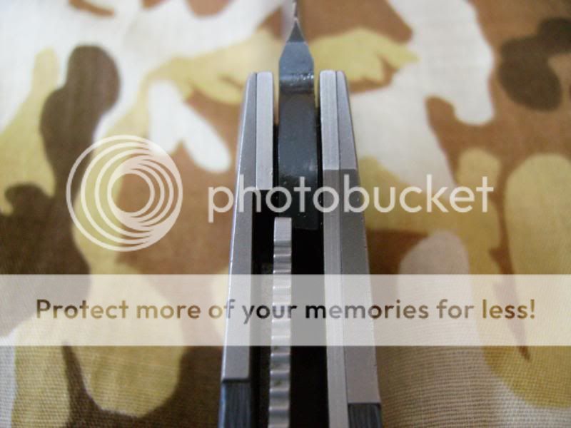

IMO if the lock is in full contact with the lock face of the tang and no more that is perfect lock up. It is what most here call early lock up.This is what I look for on all linerlock and framelocks. It gives some play for wear and seating in as the knife gets some use. Nothing worse than buying one with late lockup only to have the linerlock travel all the way across and touch the other scale after a month or so. I did have this happen on one of the original Wengers once. It did not develop blade play but had no more room at all for wear.
Here is what is IMO near perfect lock up on a framelock.

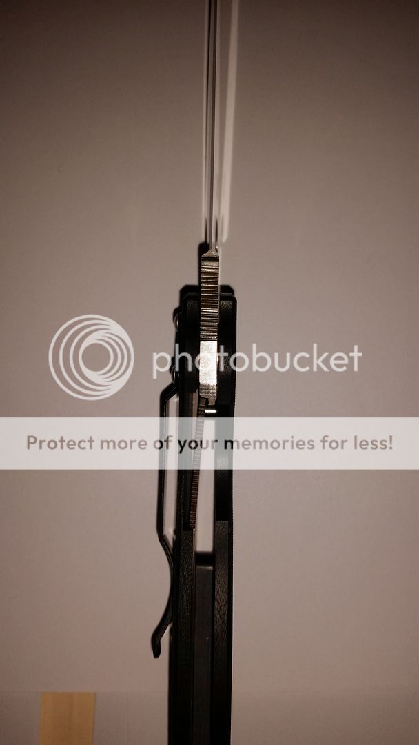

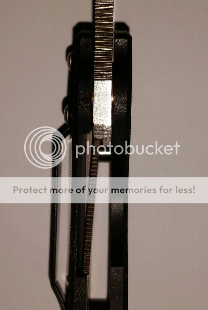

First off, thank you all for your input and help. I'm not sure it's how I'm opening the knife that's causing it (I have large hands and deploy the blade rapidly, but not so quickly as to use the whip-cracking motion.) What u812 said makes sense: maybe it's just because it's a new knife and hasn't "broken in" just yet. Regardless, here are a couple pictures of the knife. Again, I apreciate your help.
For me that lock up is dead on perfect. I pass buying knives that is much more than that.
I'd consider that ideal lockup. 100% of the lockbar is engaged but just barely. I'm not picky but it doesn't get better than that in my opinion. Enjoy it, the military is my number one choice for folders.
