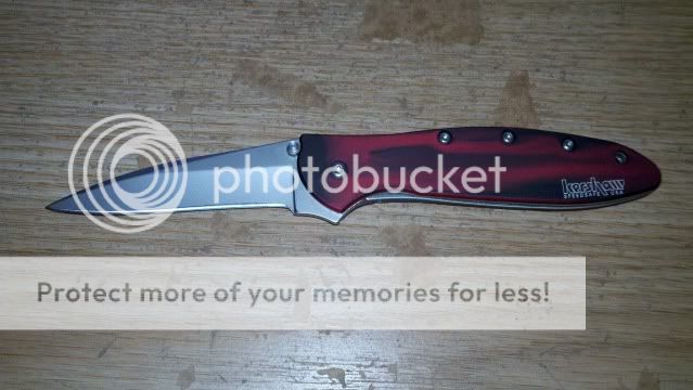

I actually do have 320 and even 220, but after damaging my Leek, I'm a little worried about using rough grits on my knives.

BTW here's my ruined leek:o

I'm very sorry about your Leek, Trugracie. Looks like you needed a little more practice before attempting that. We all make mistakes. Try not to feel too bad, and chalk it up to experience gained.

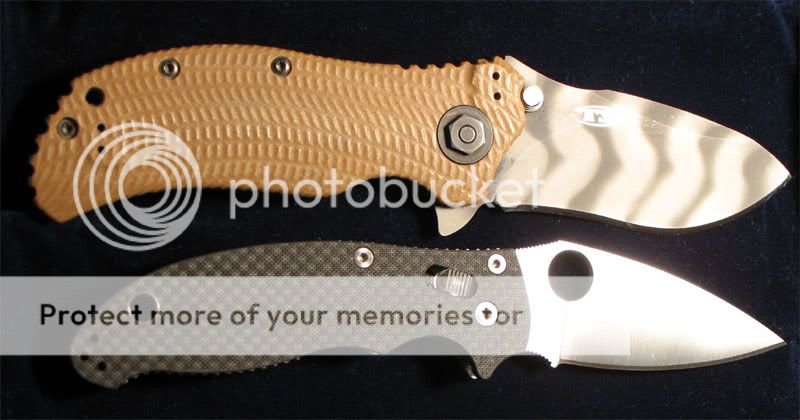

Here's my wife's manix2 S90v that I sharpen on the belt sander. I touch it up with the 20 micron belt and the leather belt w/green compound.

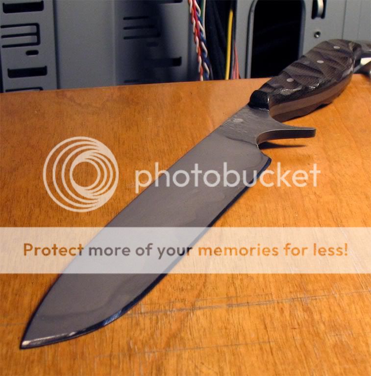

I wanted a lower angle on this Humphrey W2 blade, so I reground it with the 120 grit zirconia, then the 320, then 20 micron, then leather belt w/compound:
On bigger blades I use a 20-degree bubblejig on top of a lee valley machinist clamp. The magnet on the bubblejig allows me to spin it so I can sharpen both sides without removing the clamp:
FYI, If you contact Kershaw customer service, they'll replace that blade for you free of charge.
Reeeealyyy!
I need to go ahead and do that then. What should I tell them though? That I messed up the blade on my belt sander?
If you're having issues with leather belt flop on the HF sanders, try using the platen. The tension adjuster on the HF is horrible. I use the platen and set it about 1/16" away from the belt. This little space allows it to give some and keep the convex shape. FWIW, I haven't found convex or flat beveled blades to cut differently enough to notice. I just use the HF sander without a platen behind the belt because it's easier to avoid heating the blade that way.
As far as I know Kershaw is the only manufacturer in the industry who warranties blatant customer mistakes. Sometimes I with they would draw a line, but it hasn't happened yet. Sounds like you owe them another purchase :)
