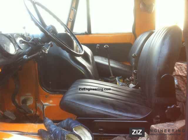

Swiss military surplus Unimog 1968 or 1969 vintage. I drove this for a couple of years and loved it. The company I worked for bought two of them for around $10k each. It never broke down while it was assigned to me, I wouldn't hesitate to buy one for myself if the opportunity ever presents itself:
Only one gripe with a 'Mog...if you're taller than 5'8", it's extremely cramped in the cab.
Funny, I don't recall being cramped and I'm 6'. Is it possible the older ones had a bigger seat?
My only gripe with it, besides the top speed of about 90 km/h, was having to wear hearing protection while driving! Forget trying to have a conversation with your passenger!
Two 6'+ guys trying to enter/exit the vehicle made us look like an opening act for Barnum & Bailey.
This is a 416 cab (as an example)
