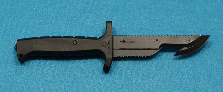

Interesting story at the U.S. Army Public Affairs site. Here is the link for commercialy sales if any one cares to check it out. This is a damned ugly knife if you ask me, of course performance is not always elegant now is it. :D
ASEK knife commercial site
The sheath looks kind of cool.
The site below states they are indeed made by Eickhorn in Solingen. I thought that squirrel looked familiar. I have seen similar one on bavarian sabres on ebay.

It seems remarkably short sighted to me that airmen will be issued a blade so singluar and specialized in purpose, and so severely handicapped for other, ordinary knife uses.

I count 4 seperate edges on it - top "sawback" which doesn't really look sharpened, rear spyderco-style 2-step serrations, the tip, and the inset blade behind the hook. Wonder what the rationale is for each piece. As well as why the blade looks like it's put together with allen screws.

I know looks dont count....and I havent handeled one...but....looks like a piece of crap to me!!(IMHO)
Those 4 edges threw me for a second, I thought Schick finally broke into the "tactical" market:barf:
No freakin way would I have used that. I have spent many rides in the egress simulator in Pensacola and Cherry Point. The last thing you want to do is pull out a knife when the helicopter is inverted and other crewmen are kicking, crawling, or fighting their way out of it.
Here's a clear case of the blind leading the blind. How hard is it stick a 99 cent seat belt cutter somewhere on your gear, just like every other aircrew member I know has? Common sense... Then your knife can be a knife. Sure, the aviator survival knife could use some modernization, but that, sir, is not it.
Is that a joke? You hook the belt and pull, and the sharpened front edge cuts your suit and possibly your body? And there are two portions of the blade attached with screws?? Whoever designed this knife, and whoever approved it should both be fired.
The funny thing is, if they just came here to BF and posted a thread stating their needs, 48 hours later they would have a near perfect design for real world use. For free. Instead they paid some idiot god knows how much for that design.:confused:

"The ASEK comes with a crushed diamond disk for precision sharpening."
The Edge is probably as dull as the inventor of this knife, but unlike him it can be sharpened...
"With this special seat-belt-cutting blade, pilots can escape from downed aircraft faster." Maj. Stephen Long :rolleyes:
Excuse me, but this thing is about a foot long. You want a pilot in a high stress situation trying to unsheath it and attempting to cut free of the seat belts? While possibility hanging from said seat belts? And, of course, not cut him/herself, which would attract sharks if it was a water crash. :eek:
Wouldn't attaching a $5 brightly colored seat belt cutter to each set of seat belts make more sense? It would certainly be easier to use. Same cutter, same place, on any set of seat belts. You could train with it and know that it was always in the same place no matter what type of aircraft you were in.

But I think you guys said it all. How are you supposed to keep from killing yourself while trying to save your life. Any way you point that knife there is a sharp edge aimed at you.
I have to add that helicopter restraint harnesses (seat belts) are very thick. And depending on model of helicopter, the harnesses are 4 to 5 straps to a buckle (4/5 point harnesses, like race cars). I don't think that a rescue hook would work very well due to the thickness of the straps. And the flight gloves would cause dexterity loss trying to grab such a small piece of metal in a water crash, expecially at night.
Depending on the unit, or stan team, you are not allowed to attach unauthorized equipment onto your flight gear. The reason for this is that you need to be streamlined in order to egress from an inverted helicopter in the water. The survival vest worn by crews were tested for this exact reason; no projecting equipment to get hung up.
Granted, we were issued the Ontario/ Camillus Pilot's Survival knife, but we only carried those on our winter flight coveralls on the right leg. Now crews wear dry suits ( like scuba divers)during winter/cold weather operations.
The only crewmembers allowed to wear knives (strapped to thier legs) were the Rescue Swimmers. I heard that they are now issued the Benchmade automatics.
