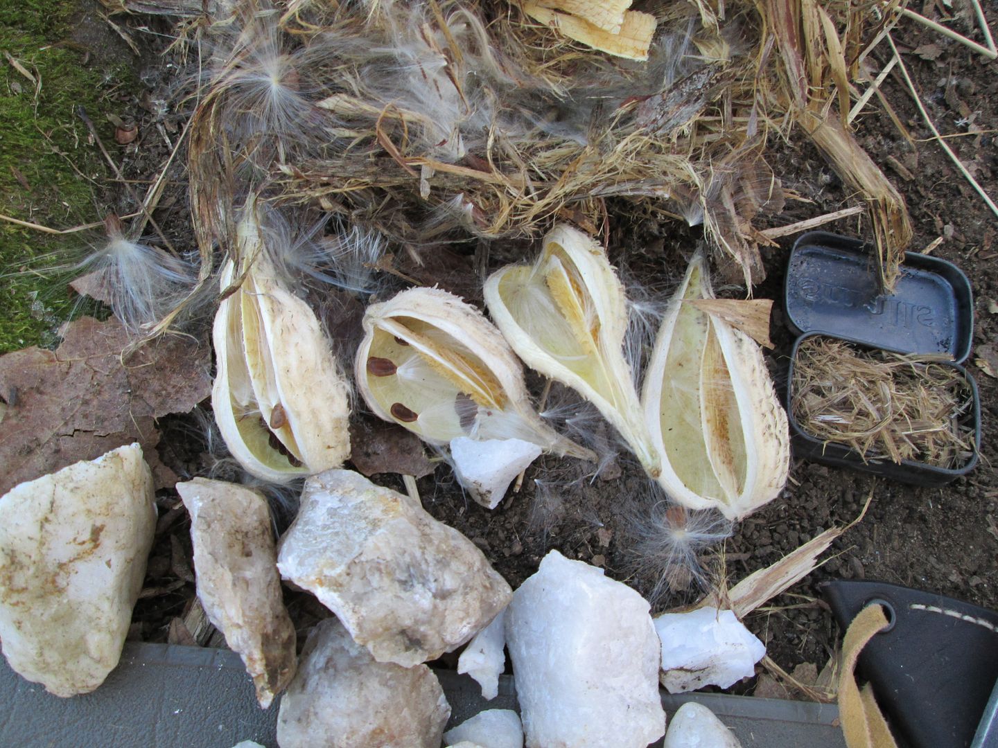

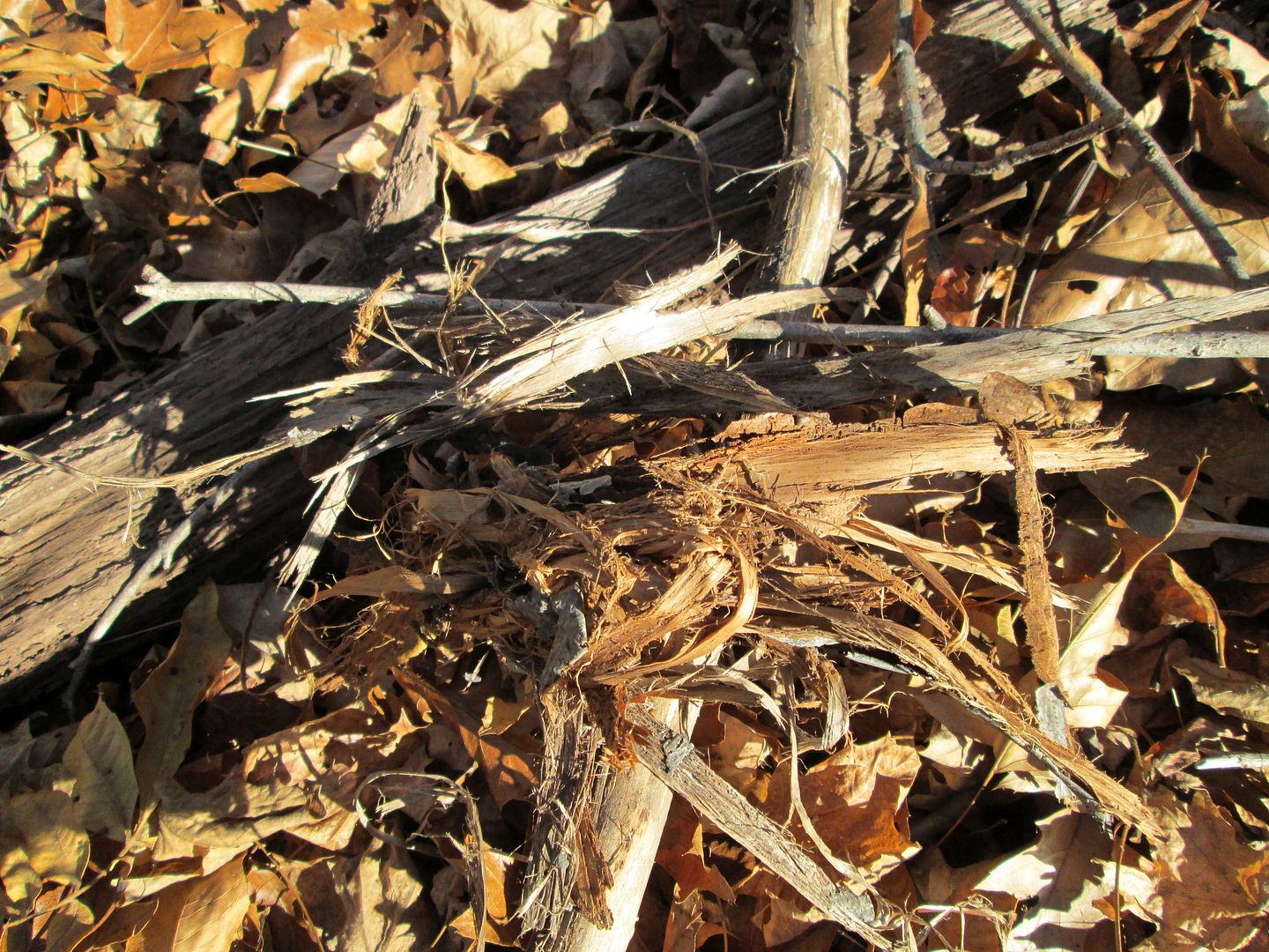

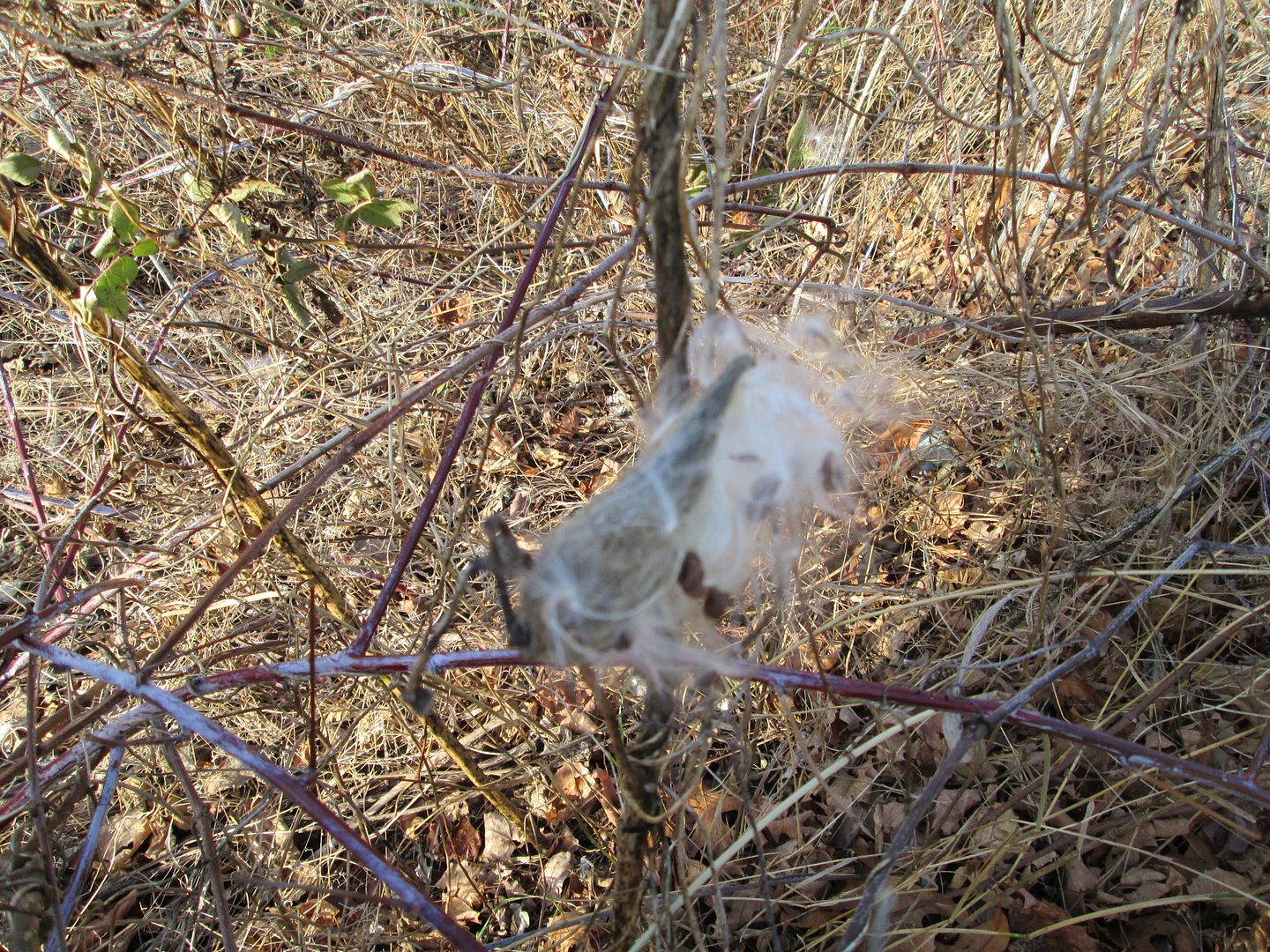

I gathered some milkweed pods, dried grass, dried fluffy weeds and cedar bark but this caught my eye. Not sure if the wood was hickory or oak, guessing maybe oak. Luckily the bark was stringy. Perfect for tinder or potential charring. Into the mix it would go.

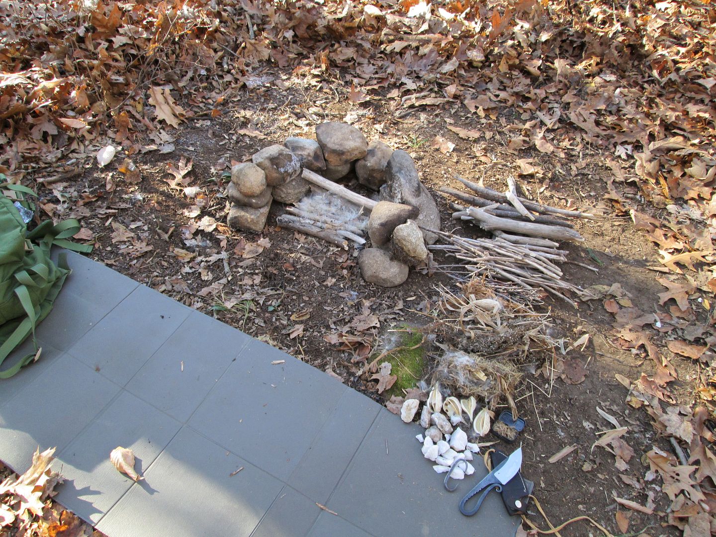

The 1/2 or 2/3rds fire ring is my preferred setup when looking for easier access to the coals. The ground was frozen therefore put a small platform on the bottom with raised backing to prevent my tinder bundle from being crushed. In keeping with the milkweed theme extra fluff from the pods was spread out on the platform. Not sure if that did anything but couldn't hurt. It is hard to see from the photo but the tinder, kindling and progressively larger wood was resting on two long sticks. I didn't want to expose the tinder to the frozen ground or accidentally scoop up frozen dirt some of which developed that ice crystal effect.

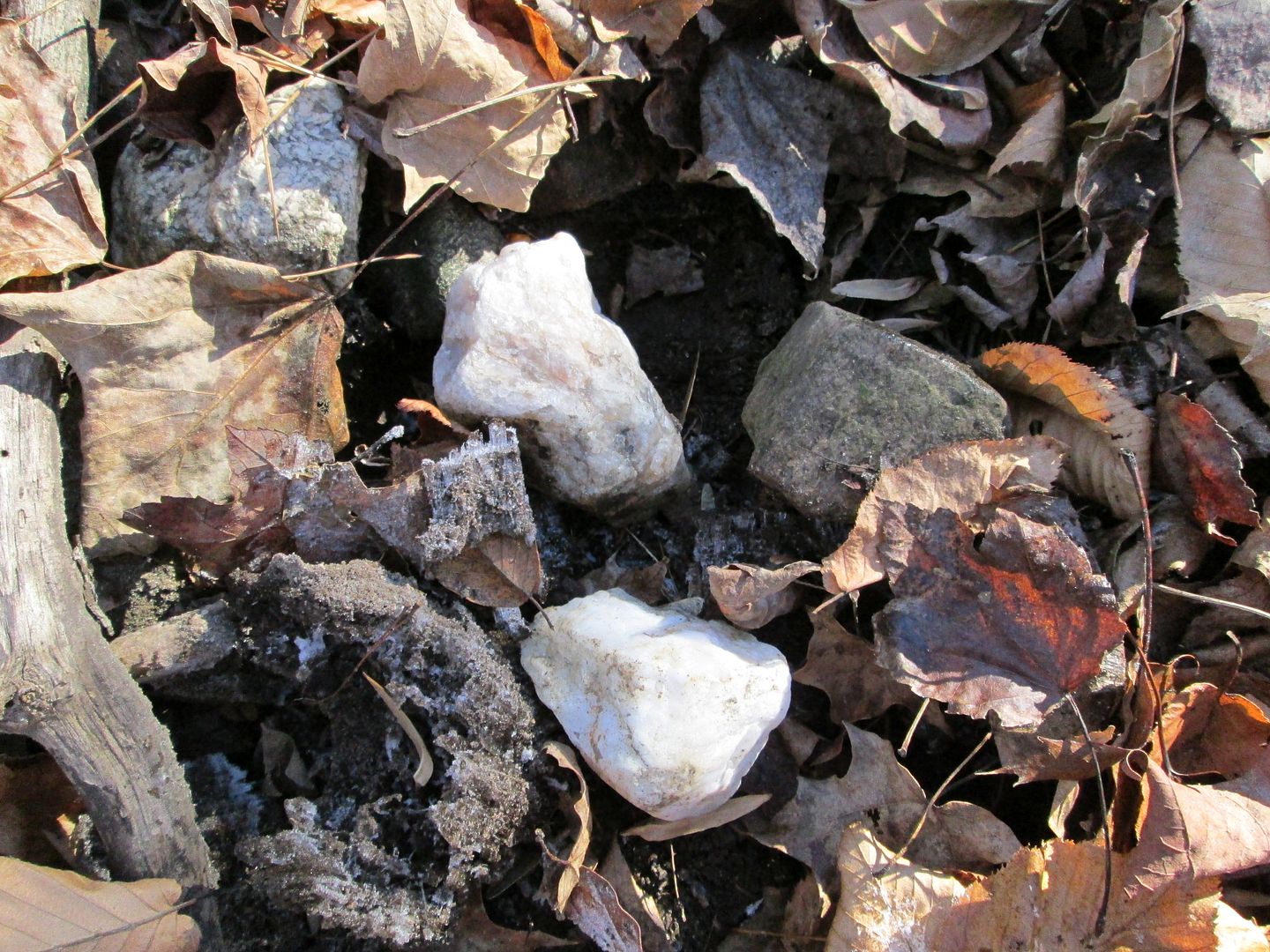

The knife, simple C striker and quartz crushed up a few minutes before.

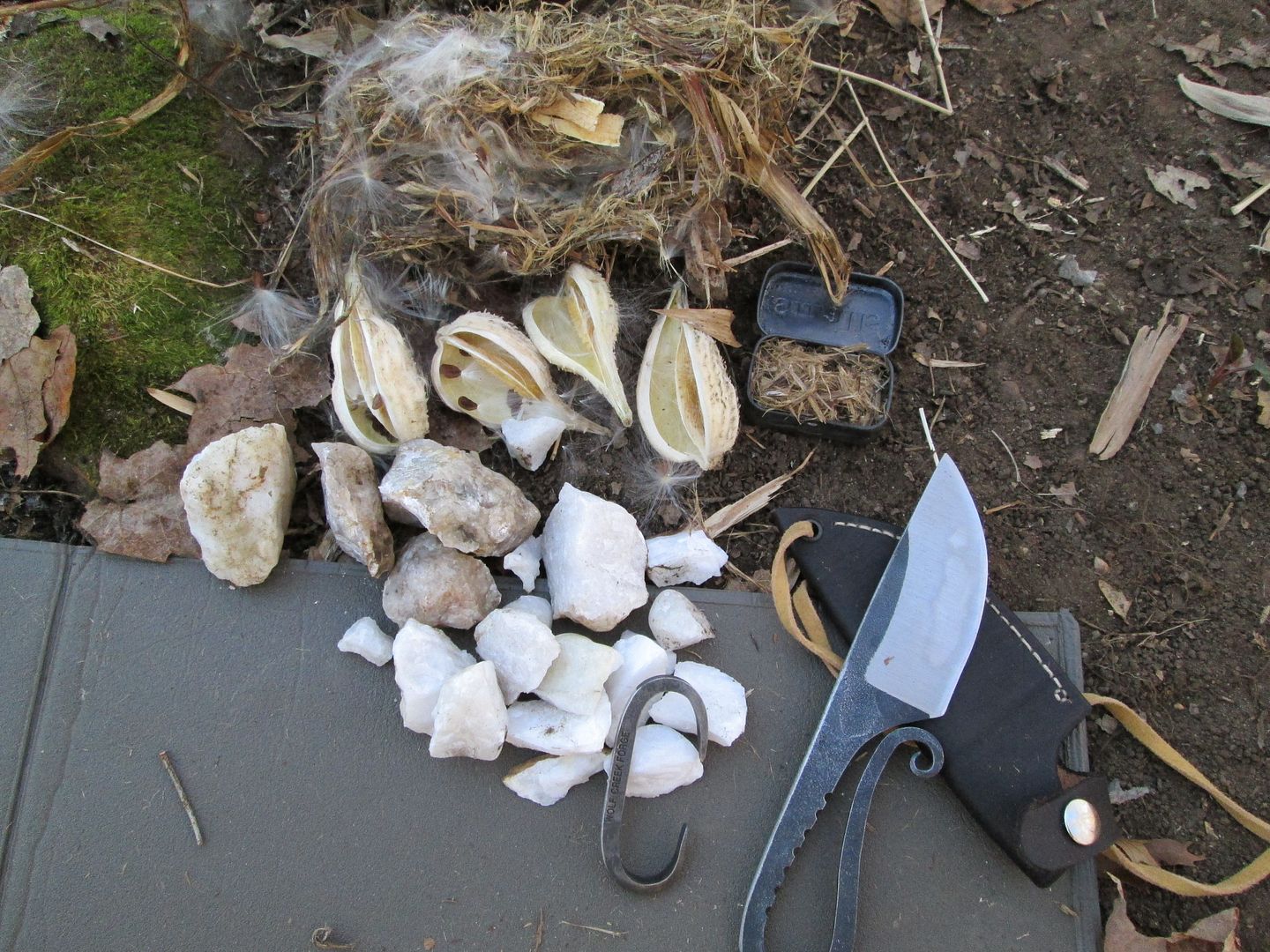

The milkweed pods gathered that day. The mini Altoids tin from my larger flint and steel kit with just added cedar bark ready to be charred. My intent was to ignite a secondary tinder bundle to complete the first link in the chain then return the tin to the traditional kit with remaining char ready to go for the next fire.

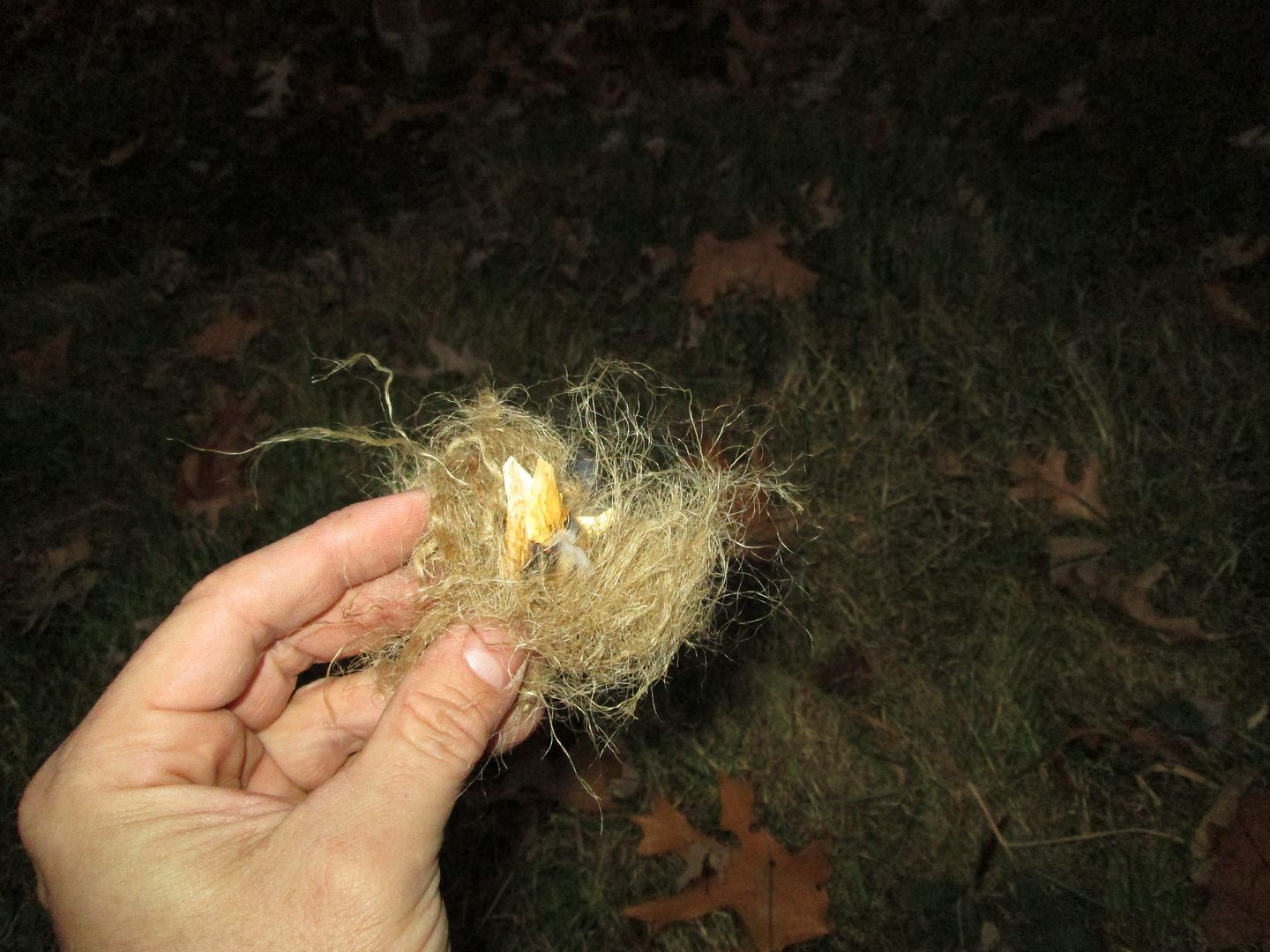

Fluffed up cedar bark with milkweed fluff mixed in. I added an extra milkweed ovum in the center as coal extender. It won't last like a chunk of punkwood but should expand the initial coal increasing my chances of success.

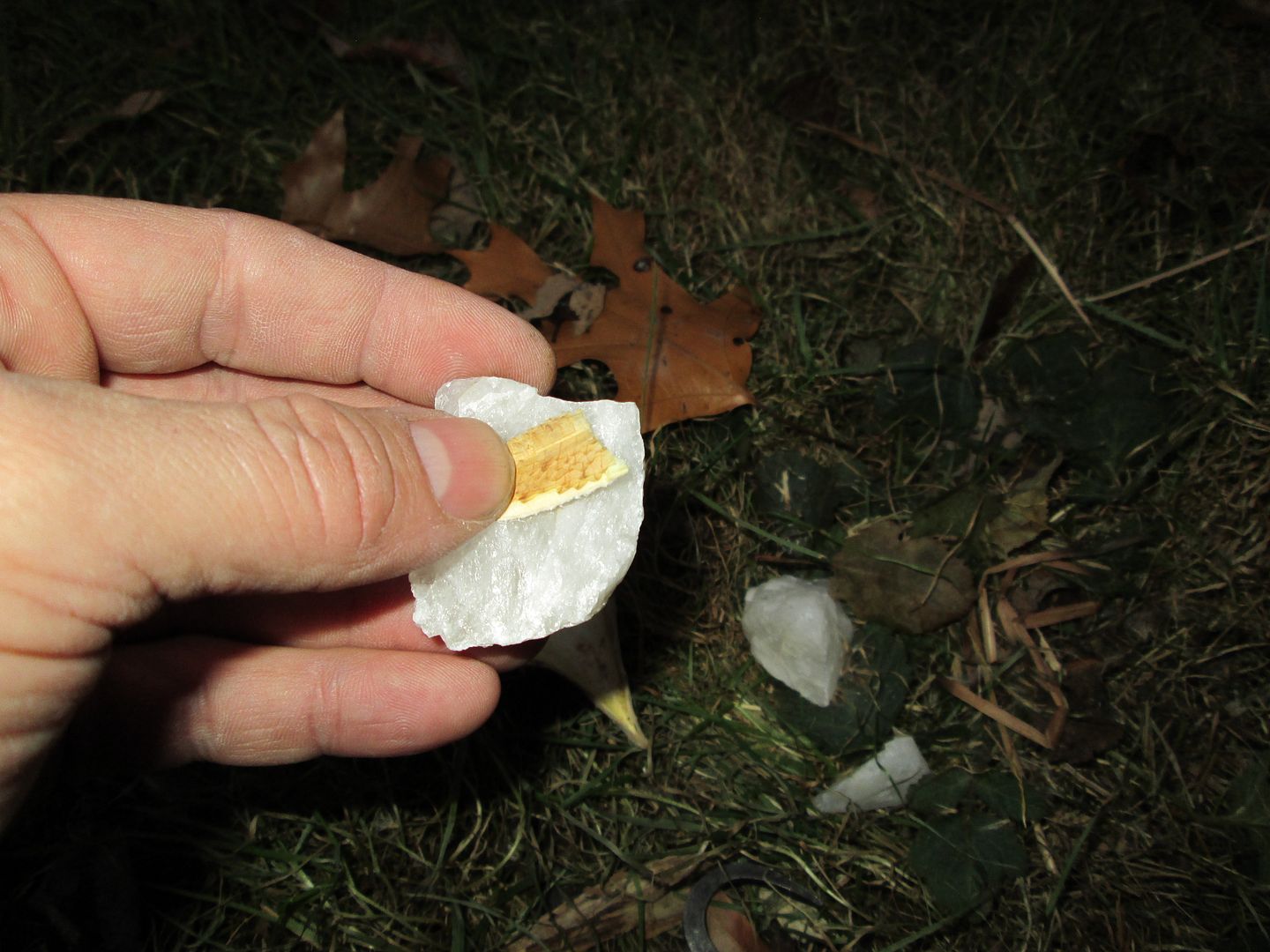

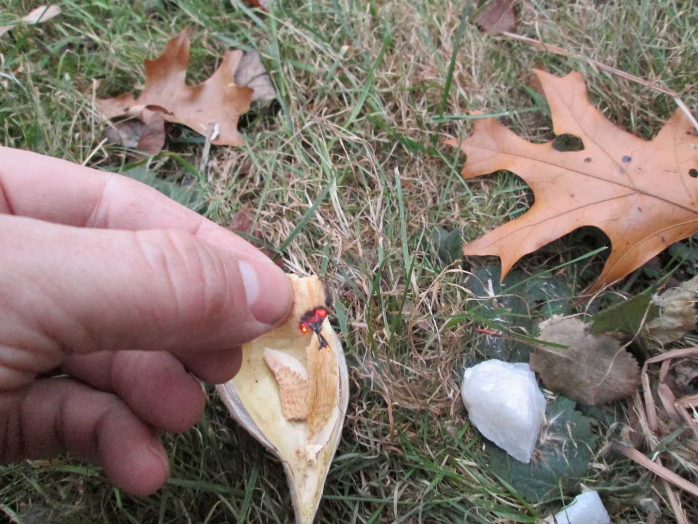

The ovum removed plus local quartz. I found the pod to be a nice little holder. There was a great deal of fluff still in the pods. Guessing that would make for nice flash over tinder.

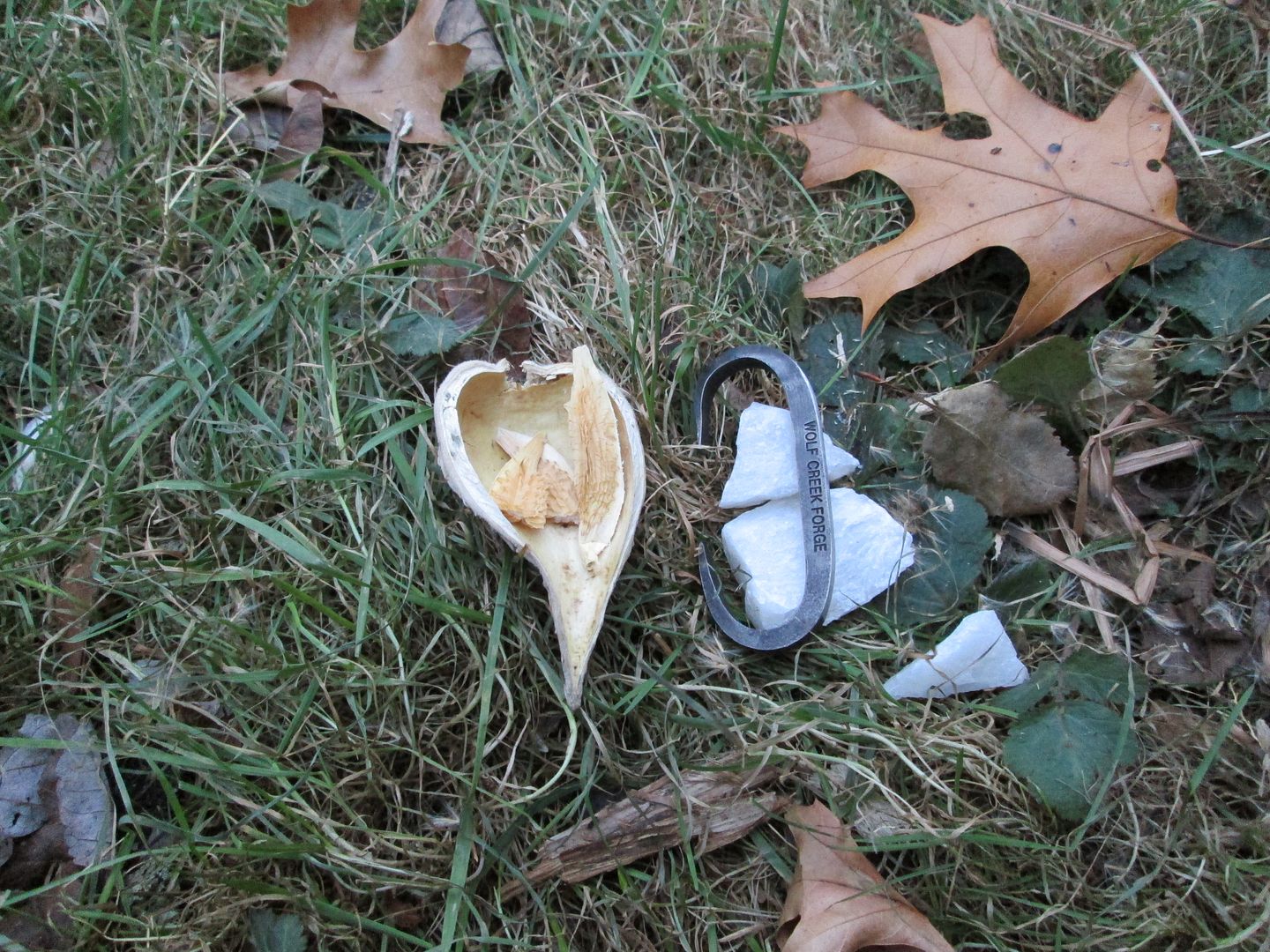

My larger traditional fire kit has two carbon steel strikers, MP knives 1095 colonial and Wolf Creek Forge O1 simple C. The MP is my primary because it tosses good sparks and is the most comfortable. The WCF is the UL backup. I tired using the MP for maybe an hour. I got some near success but nothing that held. Decided to change out the ovum and try the WCF. Within a few minutes I had a coal.

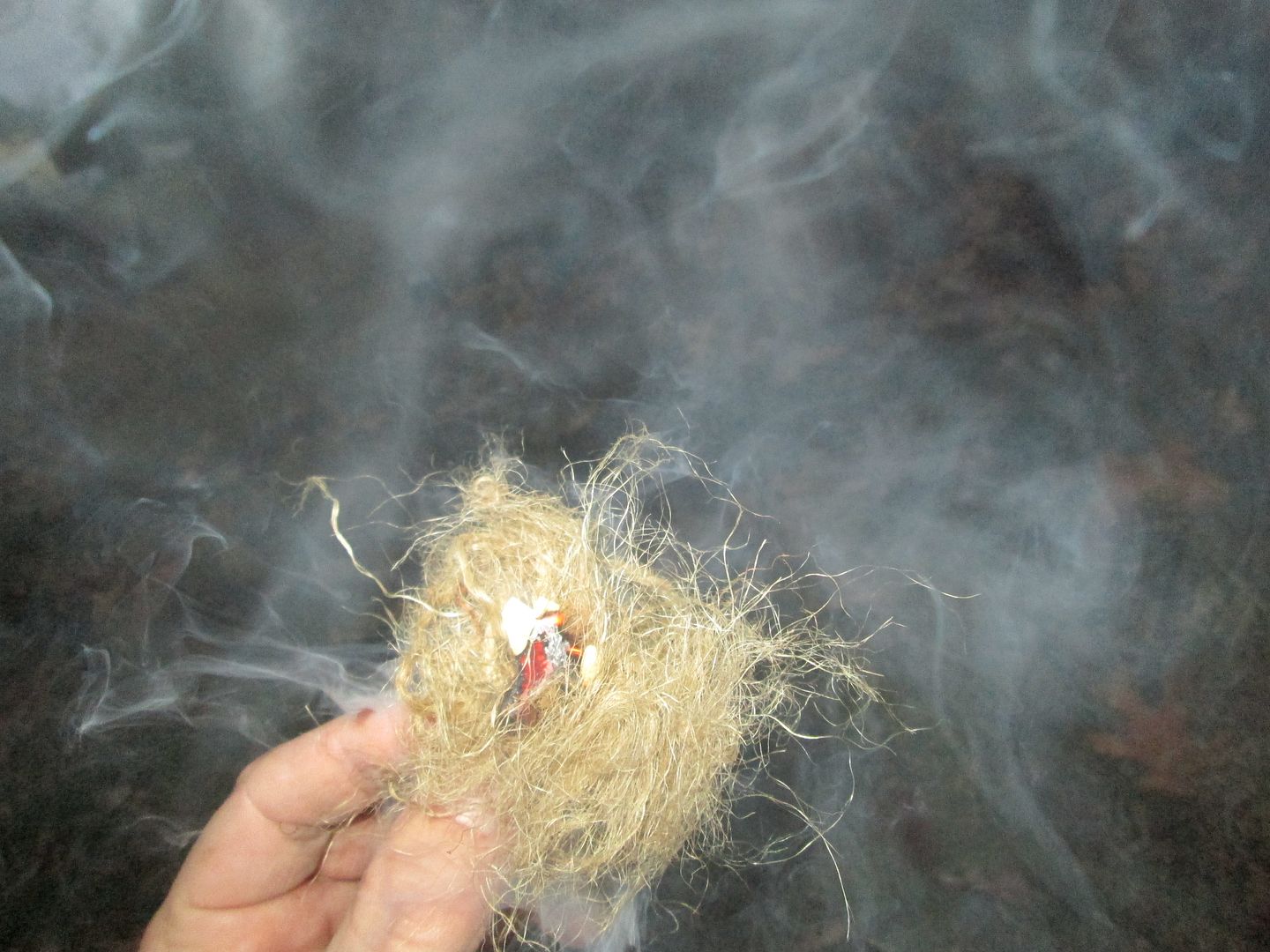

O1 seems to toss very good sparks but really think changing to a new ovum is what did the trick. In any case if WCF offers up a striker made from O1 my advice is to get it. The coal burned fast. Personally I think it would be best to add punkwood or even another ovum into the mix for a larger coal. I didn't have a natural tinder bundle ready but there is jute cordage within the fire kit. The light was fading, wind and cold increasing tossed another ovum on yet another rock with jute tinder bundle ready
Got a coal in a few minutes. Added another ovum to the tinder bundle to make a larger coal.
