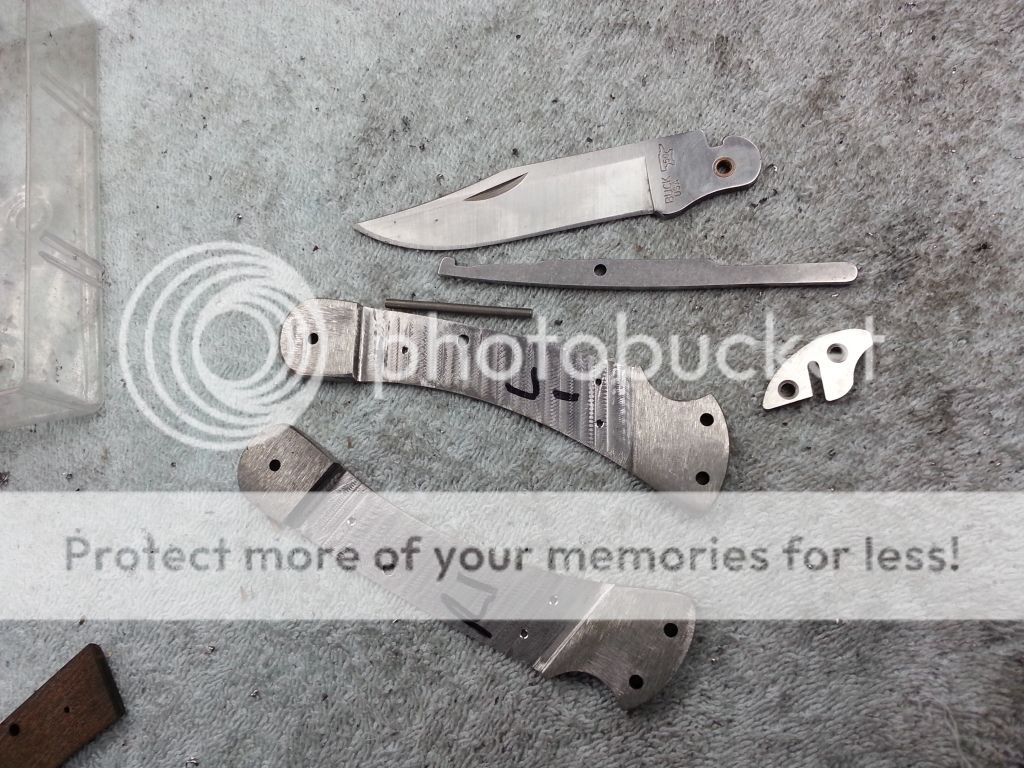

Milled blanks on the bench and ready for "shaping" (lots of drilling, hacksawing and sanding)

Is the cross milling actually cutting out where handle covers will go?
I've got a number of your knives and always wondered what processes you had to go through to make them.
Interesting stuff. Would love to see a work in progress in this thread. :)
Mark, that's the void for the scales. It takes about 200 passes with a 3/8" carbide bit on the titanium to get the .170" void.

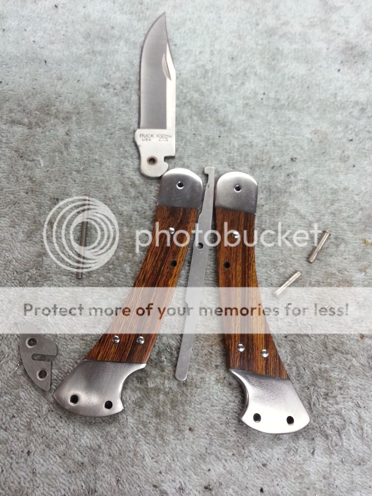

Below is a picture of the bolsters rough shaped. I'm not sure what to put in this one, but I'm thinking some wood or Elk Stag with scale pins.

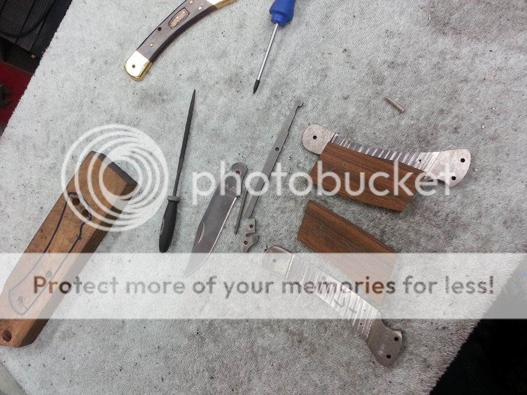

I managed to find some nice sections of Ironwood and fit the scales today. Scale pins are really growing on me.

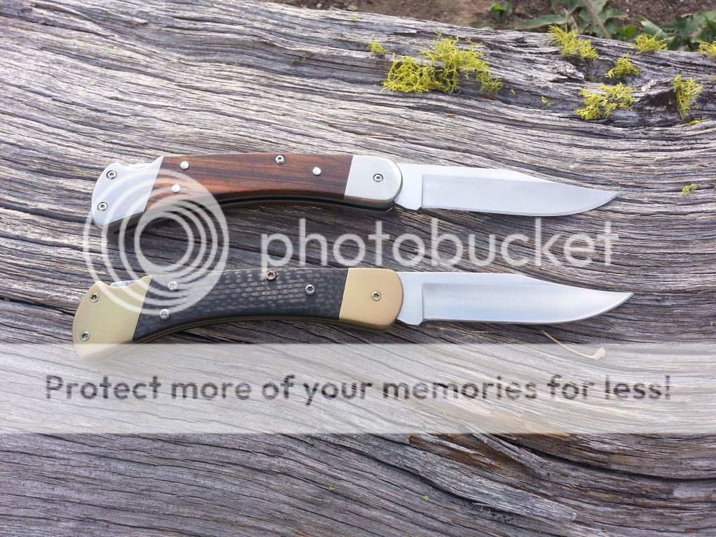

Here it is finished, along side a gold anodized titanium bolstered with titanium screws. It's not quite done yet.
