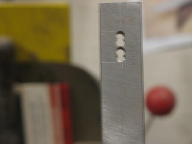

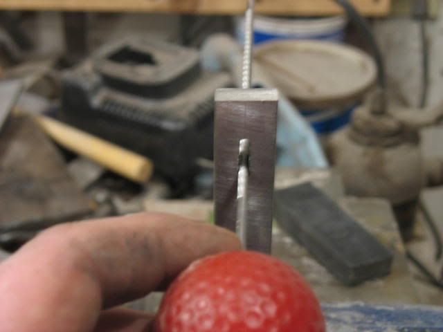

start by takeing your guard material and scribeing a center line. then i mark the width of the tang and find a chisel that is the same or close to the same width. Then punch or mark the tang location with the chisel.
then i take a drill bit approx .005 smaller than my finished dimension and drill a series of holes accross the width of the tang hole in the guard material useing the chisel mark as my center punch it is more of a trough that keeps you from slipping side to side.
i then use a small round file to remove the webbing from between the holes
then use a flat file to square up the sides.

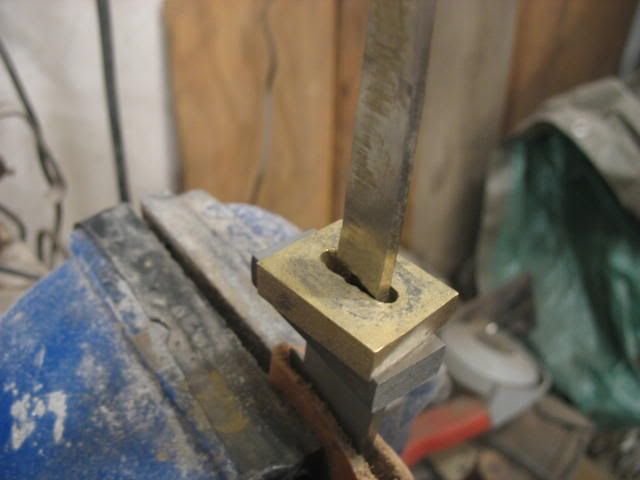

http://i13.photobucket.com/albums/a284/tacmedic45/047-2.jpg
get it close to almose slideing into place
http://i13.photobucket.com/albums/a284/tacmedic45/039-2.jpg
then take a piece of sacraficial material that is softer than your guard material to drive the guard in place
you then have a press fit guard
