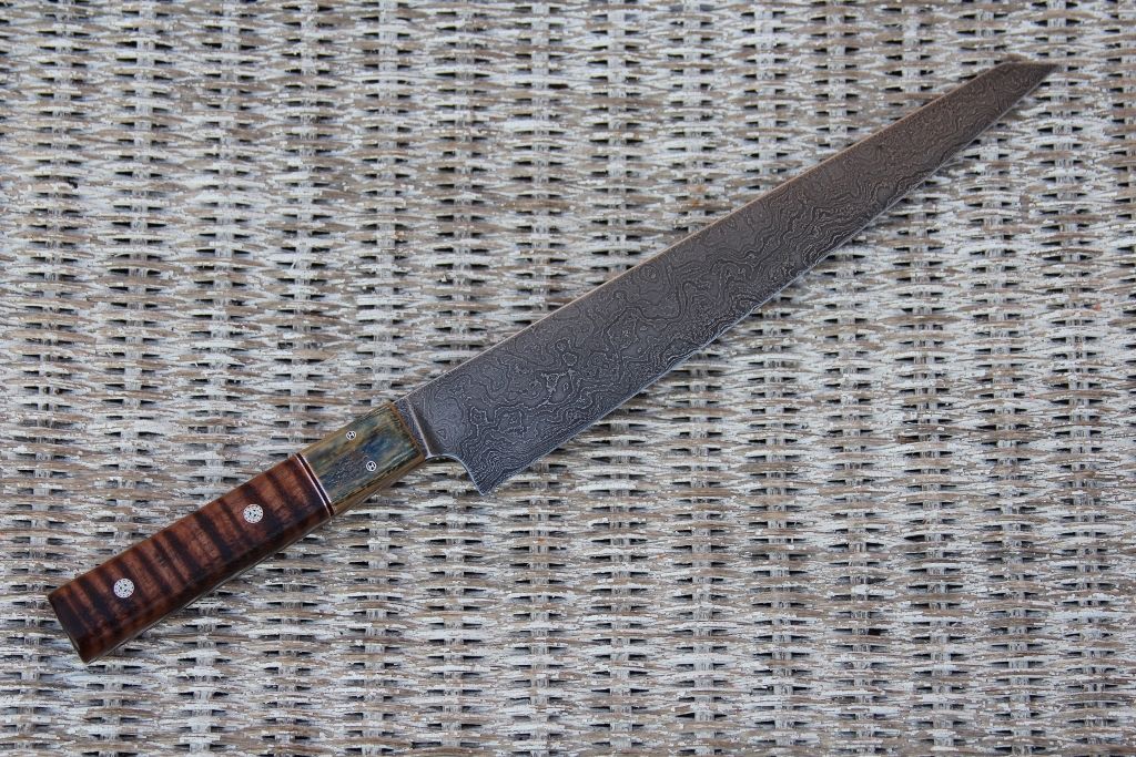

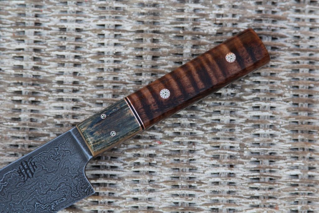

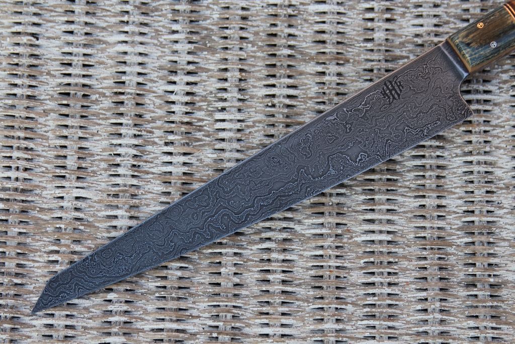

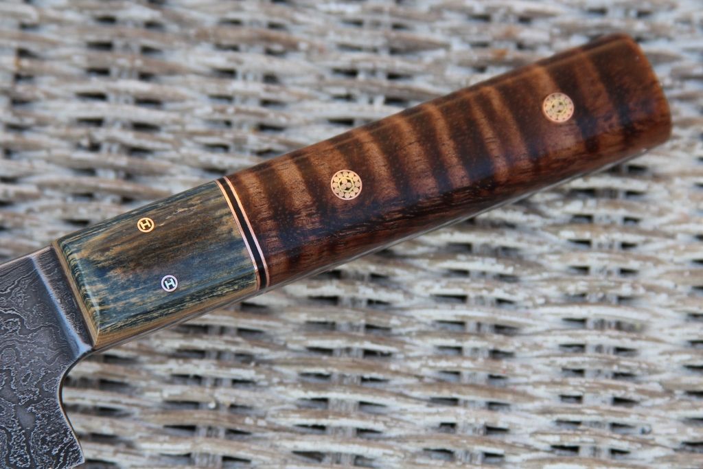

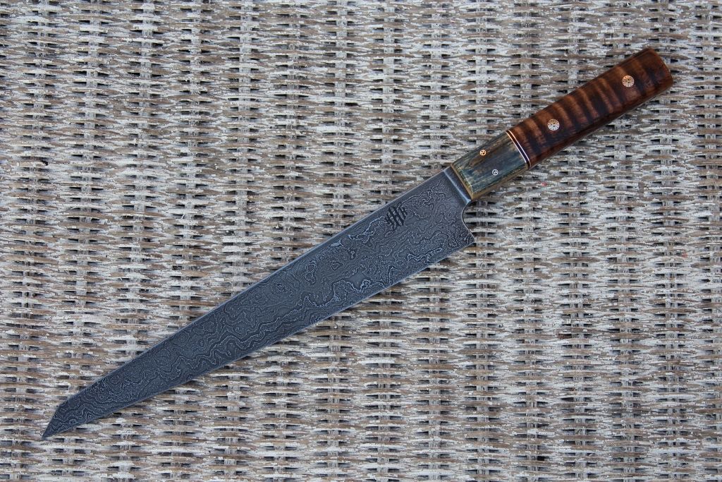

Heres one We made using the first million++ layer billet that Randy Jr forged. Its got Koa and mammoth ivory handle.
Thanks for looking.
Randy
At about 50 thousand layers we added 8 extra layers which gave us some visible pattern after reaching a million!! :)
We did a WIP showing the forging process on this billet on KKF and KD if ya want to search for it its out there!! :)

The way We develop layers on this is probably different then you might be thinking. It was really not in the forge as long as you might think. Only a couple more weld heats then most other billets we forge.
RC 60. after HT and Temper.
Im not a Metallurgist I am a knife maker. So I cant speak to that carbon migration question. Maybe someone with more knowledge then I can state there opinion on that. What I can say is that the finished steel is perfectly suited to be used as a knife.

The specs for this one are OAL 15 3/8”
Blade is 10”
