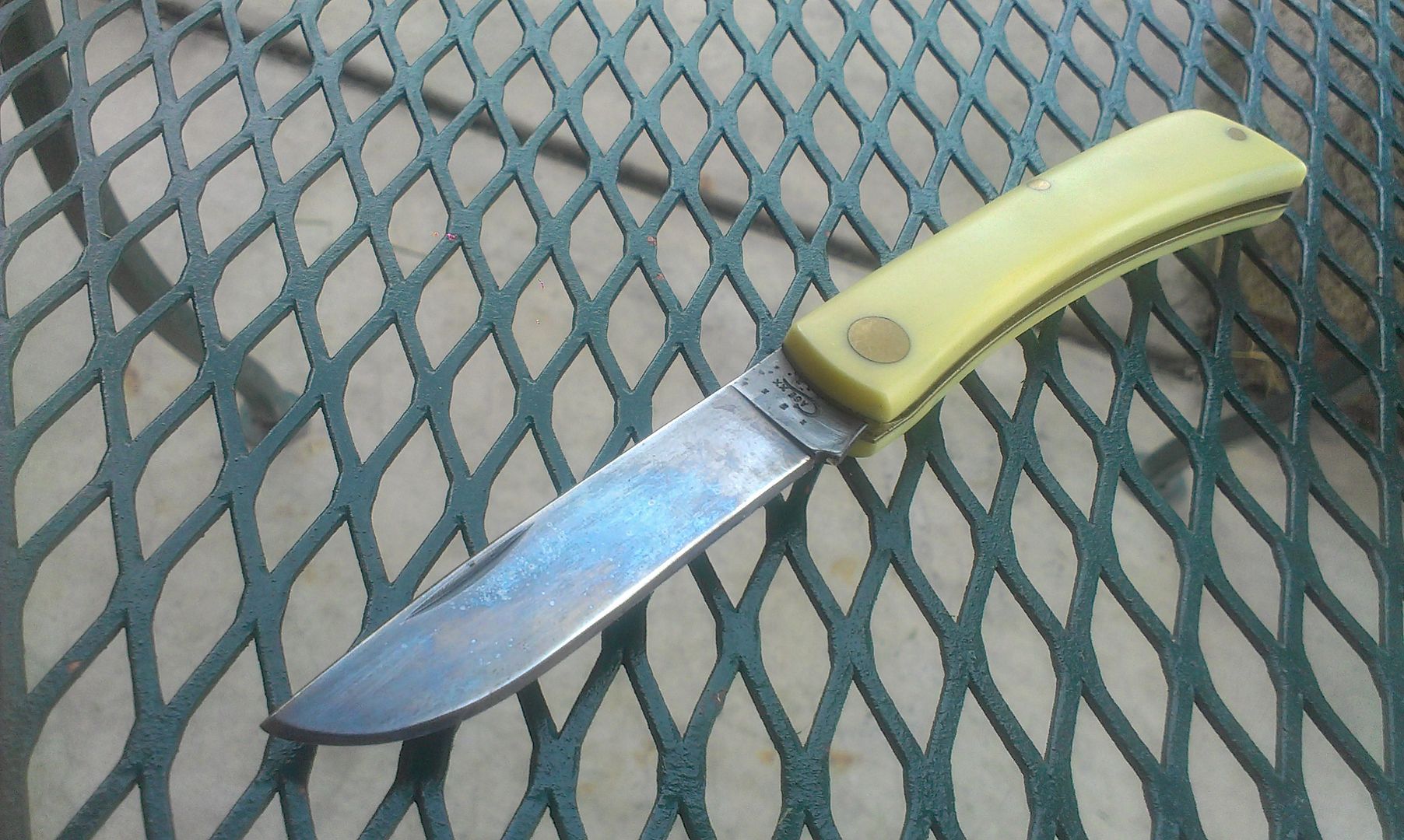

I use this Sodbuster for food prep all the time. It's had a couple of forced patina (that I've simply sanded away), but this natural patina is gorgeous. Probably can't see it but it's got a bunch of blue swirling.
