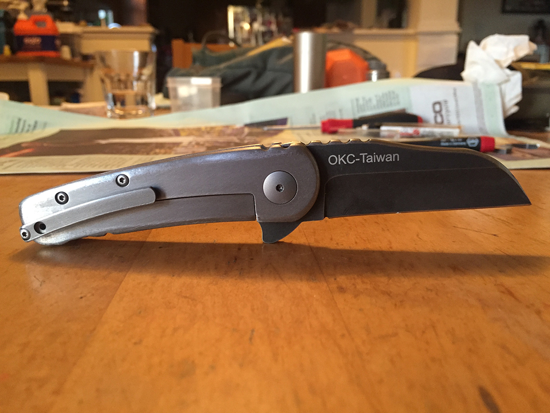

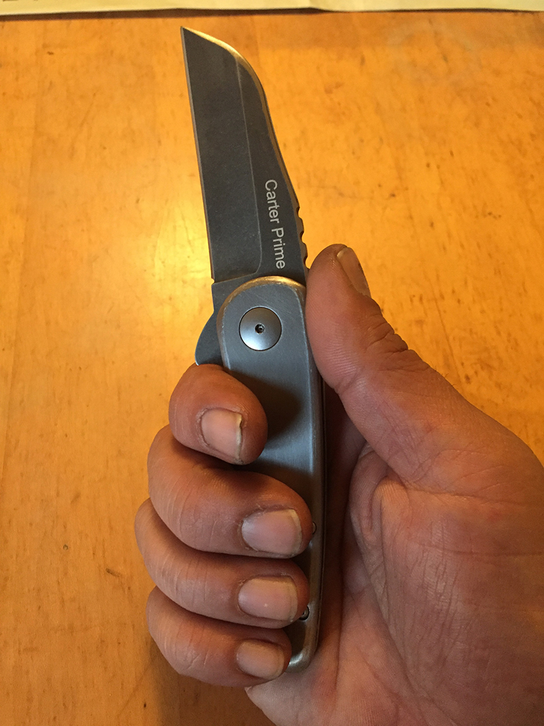

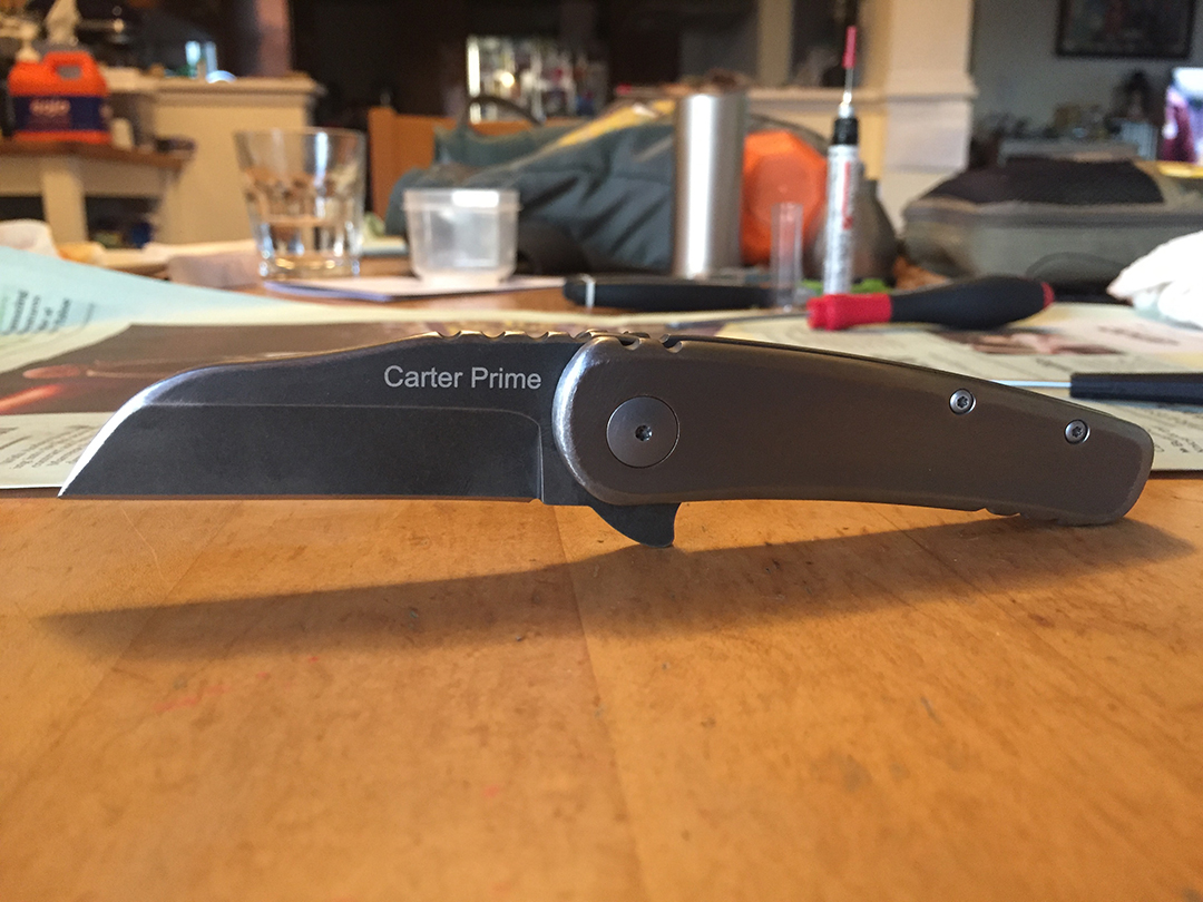

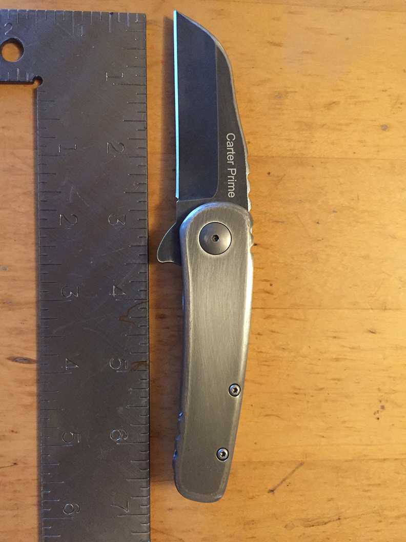

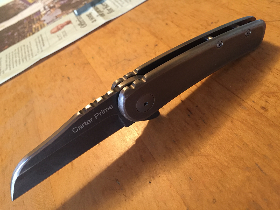

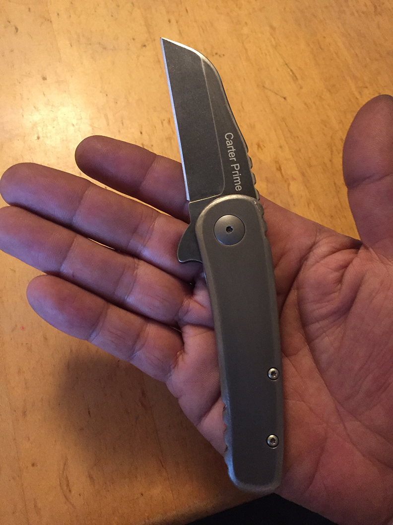

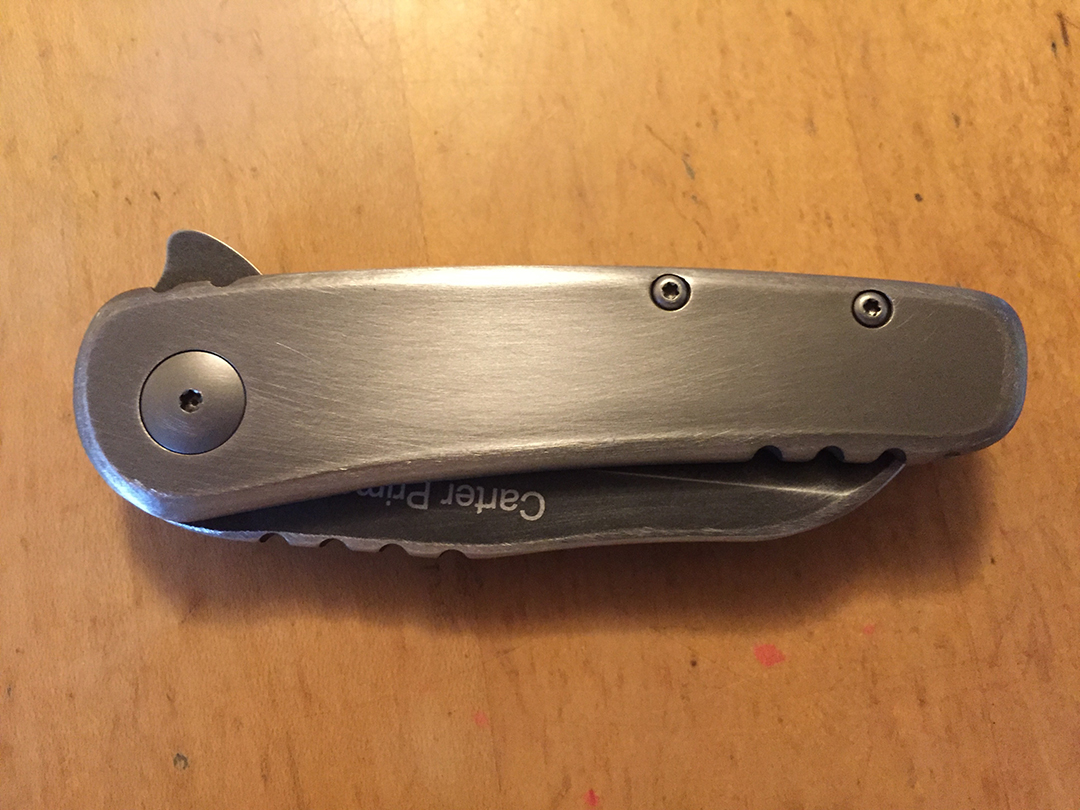

I received the Carter Prime a couple days ago, and really love this design. I was realizing though, that the size and weight are reducing the likelihood of actual edc use, and decided to chop it into a more pocket-friendly, lighter mini version. Here's the process:

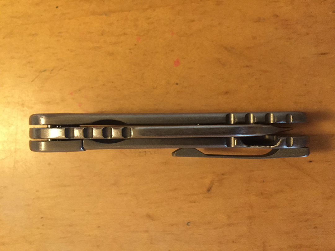

1. Chopped about a half inch off both handles and blade (dremel) 2. Rounded off edges on handles and blade spine (belt sander) 3. Sanded like a maniac (60-150 grits by hand) 4. Removed backspacer, using the barrels only. 5. Cursed the loose ball bearings into oblivion (warning all ye who tread down the disassembly route - these things are NOT caged!!!) - Might also round out a true finger choil, since it seems like the design already accommodates this hold, but may benefit from a lil more finger groove/protection. This knife is now pretty damn close to my ideal edc. Weight is substantially reduced, and the size is now hella friendly in pocket.

That turned out really nice. I keep coming back to this knife because I'm a big fan of sheeps-foot blades, but it was just so long it seemed to defeat the purpose. Now though, I may have to pick one up and do some modding. It would go nicely with my Byrd Cara Cara that I turned into a reverse tanto.
