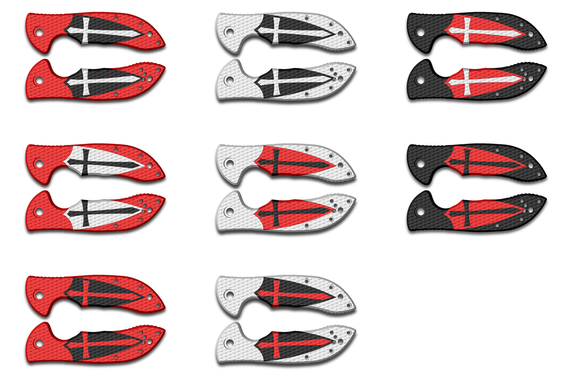

It was just requested that I map the Crusader Cross onto the Mini Commander platform... so I spent the morning doing just that. Once I had the machining files all coded up for the typical black scales with white shield and red cross I began to play with the three colors to arrive at variations on the theme... all are doable... but some variations just aren't that appealing.

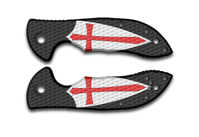

So here's the first set of Emerson Mini Commander Crusader Cross scales off the machine... in the typical black G10, white G10 shield, & red G10 cross... I placed the CAD render beneath the actual scales for comparison. When using a round tool to mill inlays and pockets you can not achieve crisp sharp corners that you can in the drawing. You will always have rounding equal to the radius of the end mill bit. I use a .0394" end mill which is the smallest diameter bit I have.
