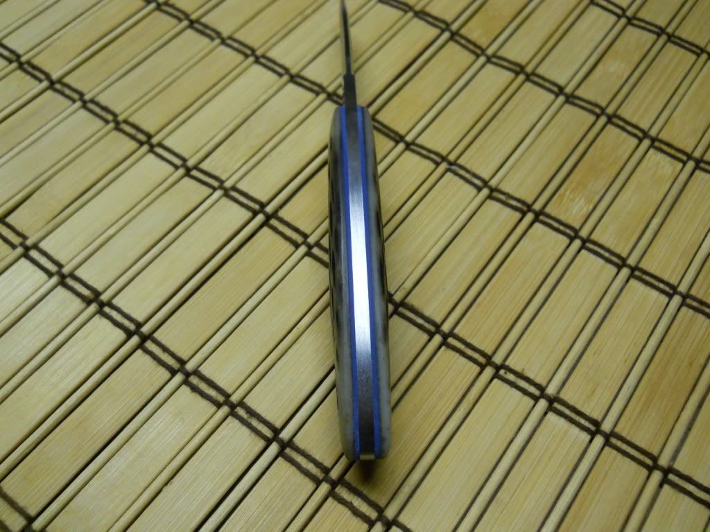

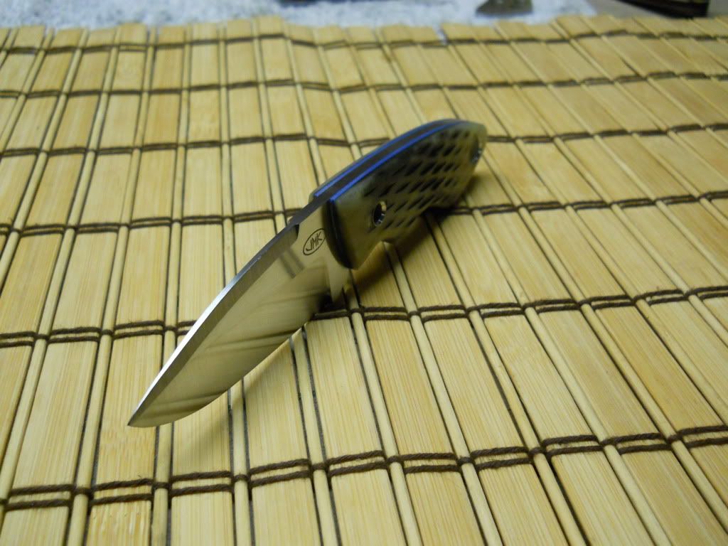

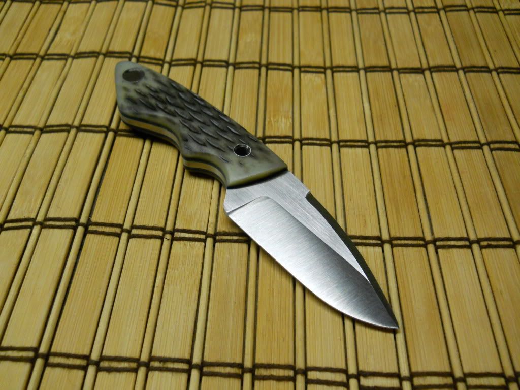

I'm really liking working with bone lately. Here is one of my Mini Drop Point XL's with root beer jigged bone handles with blue G-10 liners. Had a piece of N680 nitrogen stainless steel that Chuck at AKS gave me to try out a while back and this is what came of half of it. If I recall it's supposed to be comparable to 440C. It finishes nicely. I had Peters harden it to 59RC.
This one still needs a sheath and sharpening and some more fine sanding/polishing on the handle but it's pretty much there.
