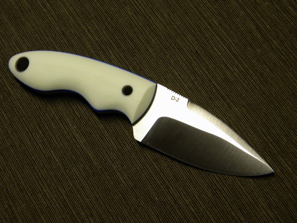

Just finished up a Mini Drop Point XL in some nice thin .115" D2 that I ground down very thin. Should make a wicked pocket slicer. I tried a new handle combo, white G-10 scales with thick blue G-10 liners, hand sanded to 600 grit then bead blasted.
I usually like thicker blade stock, but this thin stuff is fun sometimes, makes for a very light, agile knife.
Thanks for looking.
Merry Christmas all!

For an EDC I prefer something that can cut deeper into everyday stuff - hard cheese and apples, for instance - without splitting them like a wedge, which takes more effort and leaves a ragged surface. I'm in the process of thinning out my smaller blades for that reason. 3/32-1/8" depending on length profile and grind height seems like an ideal thicknesses range to me.
You could produce a similar effect on the thicker ones by trading the swedge for a higher grind that nearly reaches the spine at the plunge (but you know this!).

Thanks everybody! I thought the white was going to be a pain to keep clean, but I always wet sand my G-10 handles using windex and a quick rinse with Dawn detergent kept things pretty clean. It would probably get dirty with use, but maybe then it will just look "antique":D I'll have to make a knife for myself using white and do some testing....

Salem, yes indeed! If the white micarta that you've used is anything like what I've used this is 100 times easier. The white micarta I have is slightly off white and is paper. It gums up belts so fast it's not even funny. Hand finishing isn't too bad but rough shaping on the wheel is just a mess. I like the white G-10 so much better!!
Yeah, it's funny that G10 is stronger than micarta, but is SO much easier to grind. Phenolic in general gums belts up for me, I don't think I'll stop using canvas micarta (love the look) but white paper micarta may become a thing of the past for me. I'll try some of this stuff with my next AKS order. Thanks for the response, Jon.
