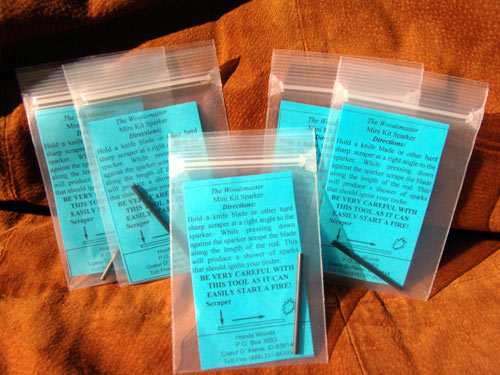

One of you guys posted these a couple of weeks ago:
*Mini Kit Sparker
This 1/8 by 2 inch Ferrocerium rod is specifically designed to fit in the Mini Kit shown in Volume 3 of the Woodsmaster Series. A quick scrape with any sharp object including GLASS will result in a shower of fire starting sparks. Essential for your survival kit. Keep one with you at all times. With instructions. $3.50 each. (or buy 5 for $15)
http://survival.instantestore.net/pd_mini.cfm#
Made a little keychain rig out of some shrink tube, 20lbs nylon black line threaded through the top and melted, and a 0 size miniclip:
attachment.php
Haven't tested if I can make a fire with it yet though. :cool:
