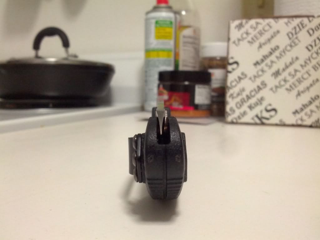

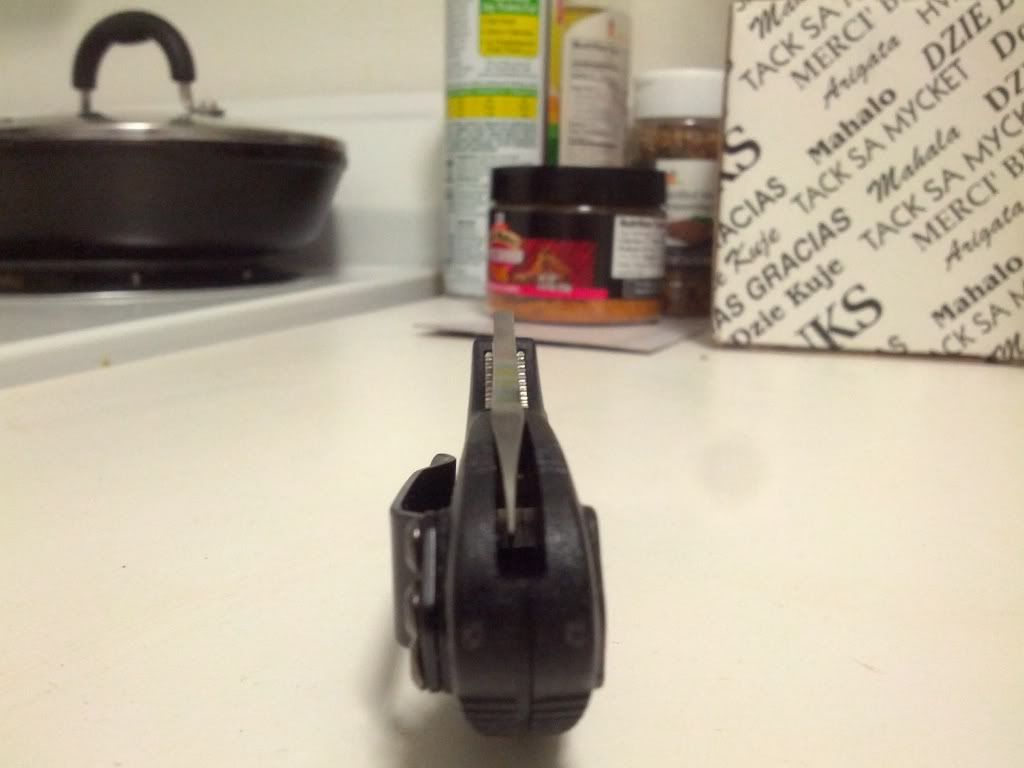

Hey guys, I just my first nice knife after doing a lot of research on here. I went with the mini grip 555hg. I bought it from eBay, brand new, and the seller had a 99.7% positive rating. This was how the blade came out of the box
The blade is basically touching the scale on the left side. I emailed the seller for an exchange, but I haven't got a response yet. You guys wouldn't find this acceptable would you? Should I just return it all together and just buy it from maybe cabelas where I can see it first? Since it functions fine I don't see it as a huge deal, but if I ever wanted to sell it down the road I think it wouldn't be worth as much.

I'd wait a little longer unti lthe seller gets back to you...he might give you your money back. Also, have you tried adjusting the pivot? Sometimes that centers the blade. If that doesn't work and the seller doesn't get back to you, you can always contanct Benchmade and send it out to them for warranty service.
How's the side-to-side blade play (when open)?
And BTW, you'll never sell it, its my favorite knives and was one of my first good ones, I've gotten many more great knives since then yet the 555 gets carried atleast every few days, you'll never sell it (but by all means get yourself a perfect one)
If the seller sticks you all is not lost, a trip to benchmade, tho inconvient, would fix it for the cost of shipping plus $5.

My mini grip came like that too, seems pretty common. You could have seller try and hand pick another one or call benchmade and have it sent in which is what I did. Came back corrected and all is well.

I've heard sometimes the blade stop pin might not be fully seated on one side or the other. Of course most people wouldn't want to take the scales of a new knife, But I can't see this being any more serious. I would think BMs tolerances are fine but the assembly might not. Anywho

All three mini grips that passed through my hands were like this. I have not try'd to correct it myself. I can live with it. The big bulky adamas, all three i've held are fine. 551 also fine. It seems that the smaller knives have this issue more often.

An off center blade does not always qualify as a manufacturing defect. Unless the blade itself is warped then it's usually something with the assembly, in which case it can often by fixed by loosening screws and retightening.
This tutorial on EDCF should help you.
It is a common complaint for the mini-grip/grip blades to be off-center. Pretty much half of what I owned over years had an off-center blade (including Ritter grips).
