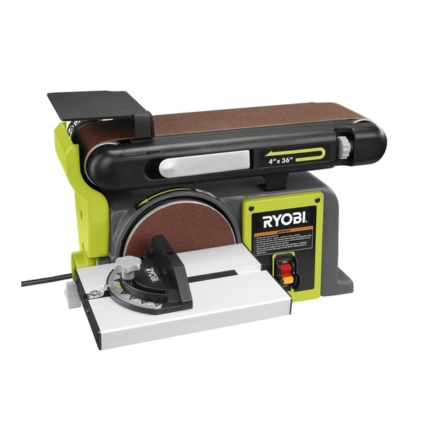

The belt/disc sander we have here is similar to the below... would you recommend the disc portion as the easiest method - laying the blade flat on the platform should ensure that the spine stay perpendicular to the edge I would think? I was thinking that something like a 120 grit would be a good compromise of material removal and smooth finishing to start? Thanks again!
you want to prevent overheating the tip. My steps have been:
- dremel or bigger cut-off wheel, dipping blade very frequently in water, then
- belt sander, with frequent water dip, then
- finish manually with sandpaper

Excellent, thanks for the advice! We've got a dremel here at work with cutting wheels so I'll probably use that to take off the majority of the material as suggested and finish up with the belt sander and sandpaper. Thanks again for the help!
