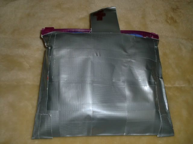

side view, its really thin.

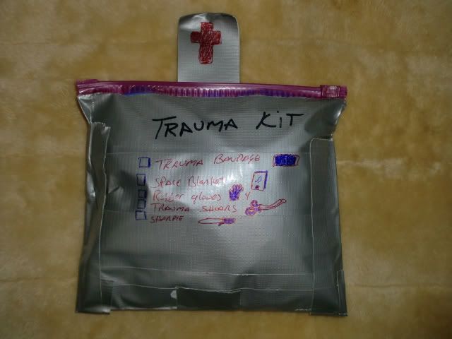

So I put together these little kits. I made five of them. I keep them in the little map holder storage area in each of the car doors, and the last taped to the trunk lid. They fit the smallest area. I have the pull strap to assist in getting it out quickly.
Everyone that drives with me knows where they are and whats in them, I taught my immediate family and friends what to do so if Im the one injured Im not SOL
I also have the emergency glass breaker, seatbelt cutters with light next to each kit.
I recently did the old wrap it in duct tape to add to the durability of the ziplock bag as seen in the pics. Now the sharp edges of the storage area does not tear the bag, nor do the trauma shears stab through.

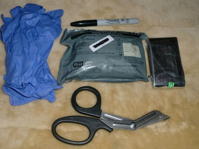

It contains the basics...
Trauma bandage, these things are great!!!!
Trauma scissors
space blanket
rubber gloves
sharpie
I have the pull strap to assist in getting it out quickly. I marked it with a red cross. When I get time I might make the next ones with orange duct tape and a red duct tape pull.

I like the idea , a lot
multiple kits is a good idea also , you have put some serious thinking into it , gratz

as a shooter I have a dedicated blow out kit...SF tourniquet...two Israeli bandages in case of a through and through...Quick Clot gauze....several rolls of Kerlix and Kerlix gauze... NPA tube....Burn Gel....several non adherent bandages... micropore tape....Betadine.... saline and syringe
i keep a couple in every veh. i used actual pouches i had laying around but yours looks good. i would also say add some celox and your could handle most major bleeding issues.
If you have any old sheets lying around you can cut them into 4'x4' squares and then cut them diagonally so that you two triangular bandages. These are awesome for arm slings and even just using as compresses for large wounds. Also for that "stray gunshot" wound to the chest, you can also use something as a simple plastic bag to treat it until ALS gets there. With a bandage over the open wound you can then tape the plastic bag over the wound leaving just one corner untaped. This allows air to move outo of the chest cavity when the patient breathes out,and prevents air from entering the chest cavity when the patient breathes in. This simple treatment can help prevent a tension pneumothorax until more advanced EMS can arrive.

Really good little kit SAR. I commend you for the thought of it. How about some alcohol hand gel for cleanup of the forearms / arms later on ?
