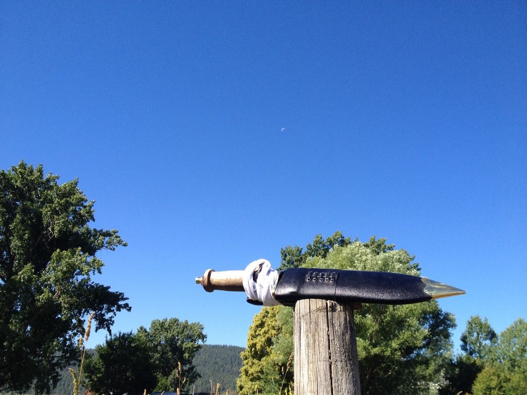

Theres no flowers or volcanoes in this post, besides the knives, just thought id start off with an aloha. finally got the pictures to be displayed properly, so hopefully you can see them! I wrote up something last night but it did not save, thus here i am writing from scratch all over again. This thread i made is a sort of praise, you might call it, to the knives that are shipped from HI to all us eager recipients.

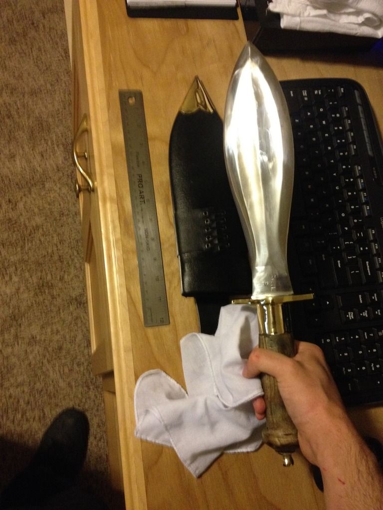

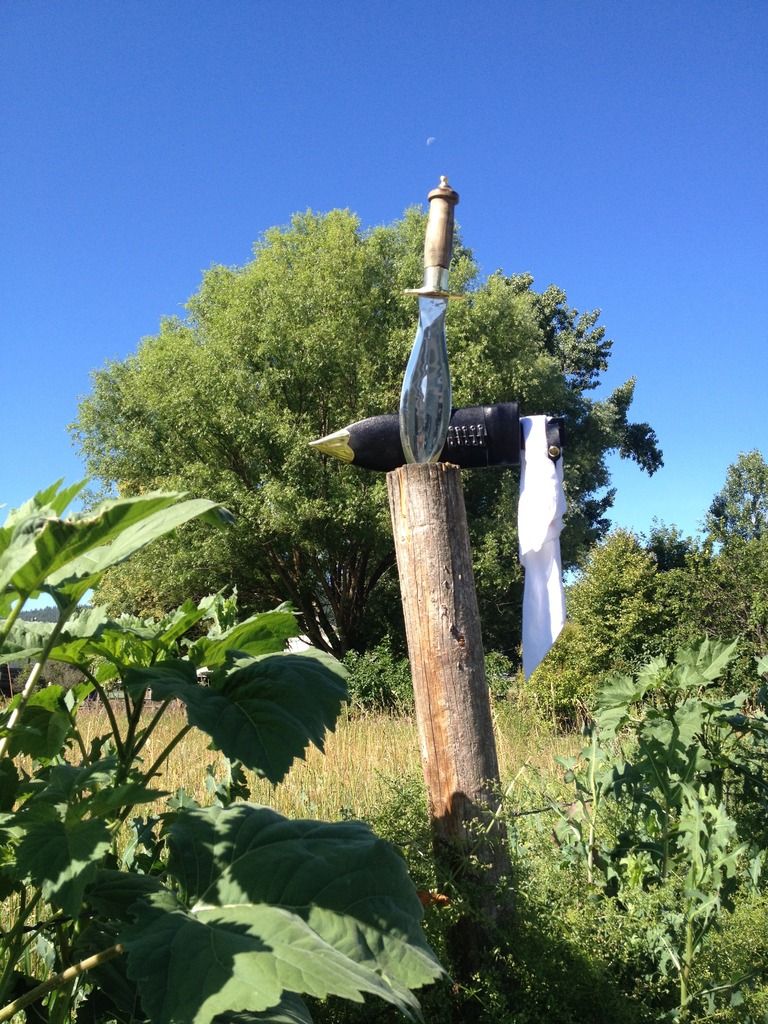

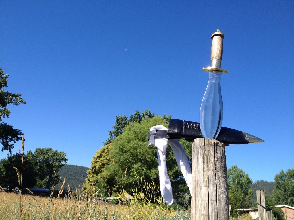

my first knife from HI turns out to be a spear head on a knives handle. Its something you'd hope to imagine an ancient hero wielding. I showed it to a family member who has been in metal and knife making business for decades and he was astonished, calling it an 'armor piercer'. I can tell this spear holds its own to the toughest materials. I like how the blades connect down through the handle and out the end. These are the best knives i have seen! meant for the skilled and are excellent for practice to become better, no matter what level. each blade will help develop different styles, which is the primary function of them for me. not to mention they are exceedingly beautiful to look at. they say samurai use to make sure their blades were clean as possible (for a physical display of their honor maybe), which is little concern for HI blades. They are always polished and in their prime. no other blades compare to these. If only i had what i wrote last night, it appears as if i am rambling.

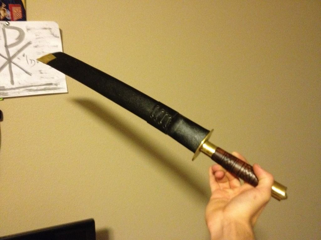

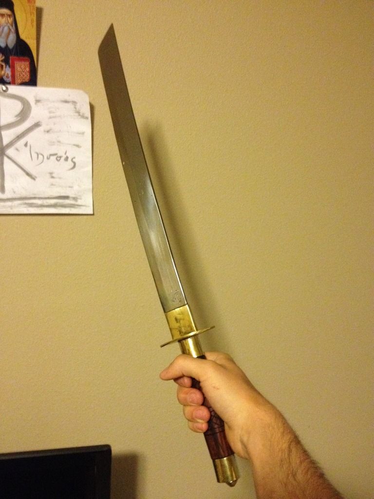

Yangdu herself is an astonishing person to work with. I believe everyone calls her auntie, from what I've picked up. I let her know what i want and she finds the best deals, and i can see she does the same for everyone. Ive requested odd products that may or may not be completed at some time, but the fact remains. i intended on increasing my collection for the martial arts that act as an embodiment of the soul to be at peace. i requested a blade without the handle, and might start getting into making the sheaths and handles until i start making my own blades. The mini wajaski will make a fine gift & the spear may as well be passed on for generations. this being my first thread, i want to say thanks for welcoming me into the HI family!

Congratulations. There haven't been many of these elaborate Spear Valas, and some of them have been a lot heavier for the same length.
This one is mine. It's 18" OAL and 30 oz, made by Sher Kami.
By the way, some people have been calling this model an HI Smatchet because of its resemblance to the legendary smatchet. HI also makes a Spear Vala of a simpler design, without the fullers. Also a very nice knife. Here is one of those, 14" OAL and 28 oz, by Bhakta Kami.
Thank you Auntie! and thanks David! excellent info. lucky you have sher kami make knife. I don't remember who made my blades, but they are exceeding quality.
Your Spear Vala was made by Anil, Keshar Lal's son, and the Wajaski looks like Kumar, but the marking is not as clear. If I'm correct, the left side of the blade should have a Star of David as one of the marks. Regardless, they're both gorgeous!

used the mini wajaski on a cheap thick walled plastic water bottle, thicker than a milk bottle, and was surprised to find it sliced the thing in two no problem. a flick of the wrist and the wajaski gets through. now i need a katana for certain
