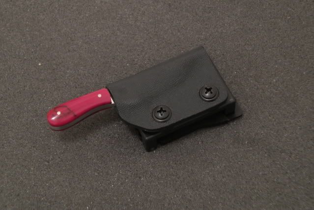

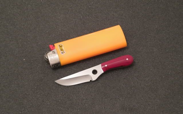

This one is off to its new home! The Tek-Lok belt sheath was built by request. The bevels were hollow ground on a 2" dia. wheel to keep things in proportion. Not bad to grind, but it was a little scary working it on the buffing wheel!
SPECS:
-3" overall, 1.5" blade
-1/8" thick 154CM blade steel; Paul Bos H.T.
-Jasper composite handle scales, nickel silver pins
-Kydex sheath w/ Tek-Lok

Thanks for the compliment! The handle material has black veins in it- there is some on the other side as well, it's just not as visible in the pics.
