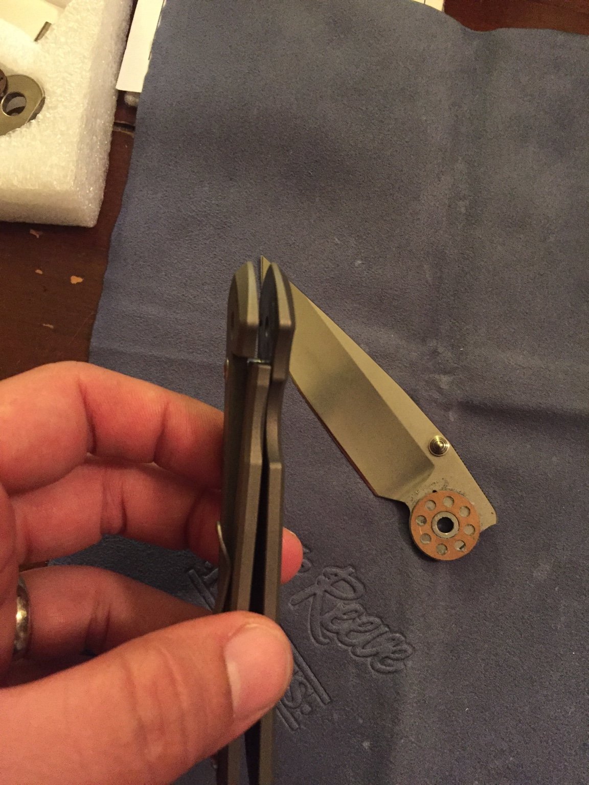

Could be lock bar tension, or lack there of? You can check this by removing just the blade, the lock bar should touch or come very close to the other scale, if it doesn't this can be a cause for lock rock. You could then try bending the lock bar slightly to increase tension.

I think I will try removing just the blade and see how close it gets. I'm not sure I feel comfortable bending the lock bar more if it needs it though!

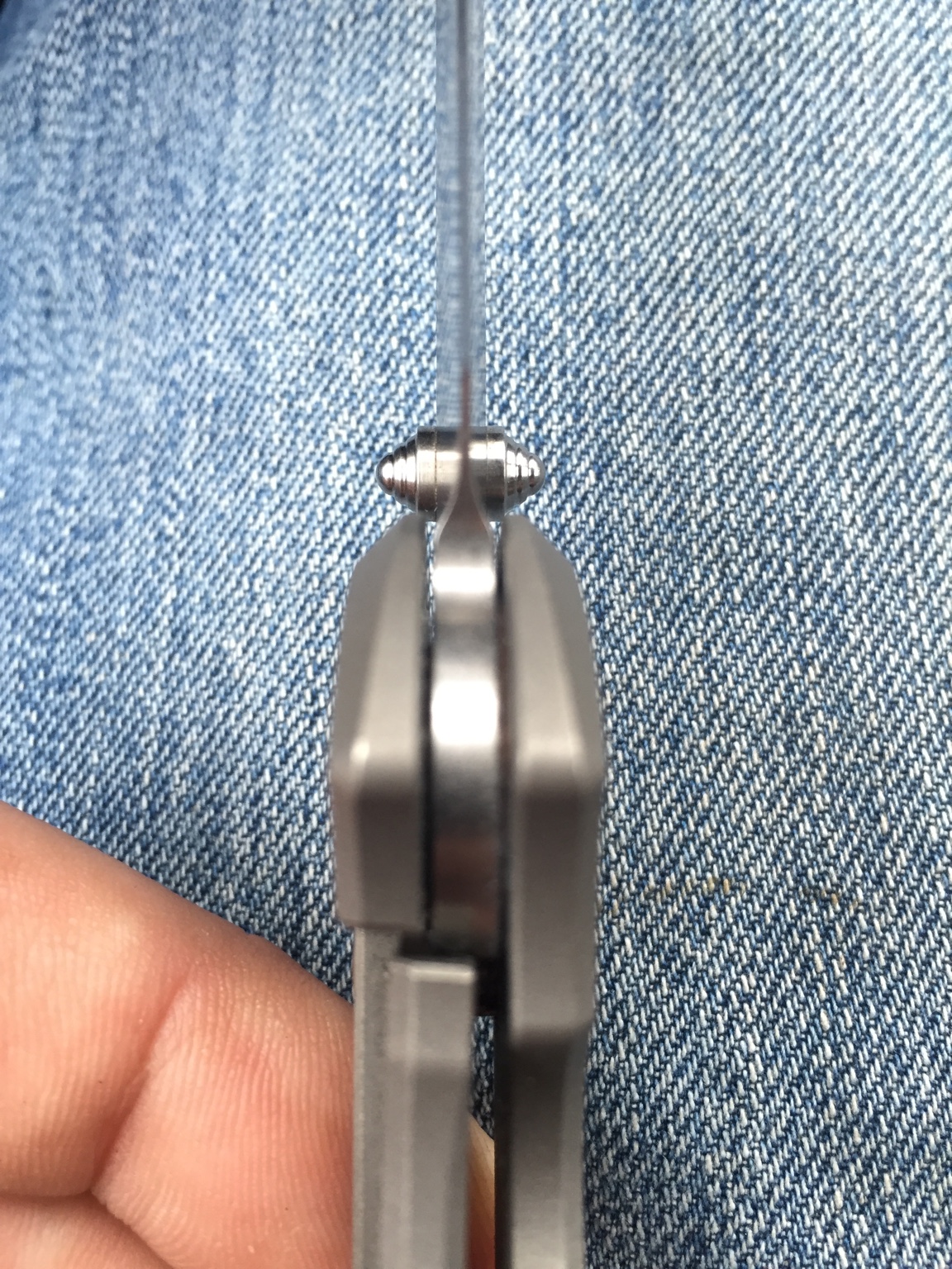

How does this look?
Do you see a light groove/mark on the blade tang where the lock bar and blade mate? It's already been asked, what's the percentage of lock up ?
If its early, it just may need some time to settle in some more. I've got one with early lock up, I'd guess around 20%, but it's solid.
I've always taken the knife completely apart, the lock bar should travel beyond the slab. I can't tell if the pic shows enough tension on the lock bar even though it's hitting the opposite slab.
Even though the issue may be as simple as lock bar tension, I don't know if I'd try it on a CRK. I've adjusted the lock bar tension on two other knives that weren't CRK's. If you bend it too much, you will create lock stick.

How does this look?
Looks just fine, at least from the pic it doesn't appear that lock bar tension would be an obvious issue. I have a couple that would fall short of the opposite scale but still have rock solid lock up. Did you happen to notice if there was any deformation in the lock face before the blade change?
