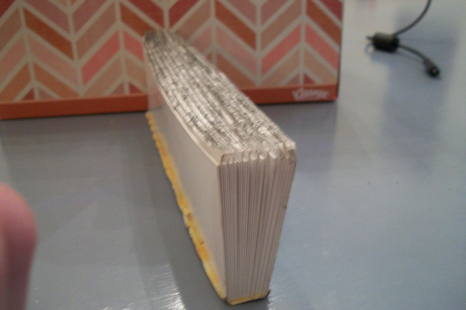

I do not go beyond the fine rods normally, but did make a widget out of heavy card stock to apply polishing compound to the ground side while sparing the tips of the serrations.
Basically a stack of cards, every third one cut 1/16" shorter. Apply compound along the edges, and when you run it across serrations the high points force the cards apart - the low areas get polished and the tips don't wind up getting partially melted.

Edit to add some pics of the serration - stropper
