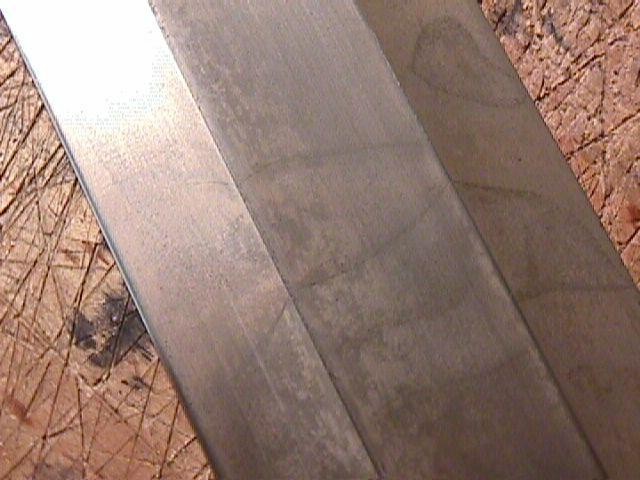

I have a sword that I have 11 hours in on grinding made of D2
I didn't even try to M/P it, I know better :confused:
BUT after foil wraped and H/T'ed
that ""matrix" type look"" I kept on it, it's c@@l as He!! I think..

I think the etch would remove the patern I'll take a picture of the blade
and post it..

this has 6 hollow grinds 3 per side
