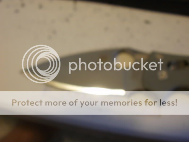

Okay, I think I've managed to make some progress.
Before:
After:
I've found that using the diamond paste on the slotted paper wheel was a hit and a miss at the same time. The paste would stay on the wheel, but the wheel didn't cover enough area to neatly polish the blade.
I once again tried the various rouges from Sears with no luck, those abrasives simply couldn't put a scratch on the hardened steel. Then I thought, "the white rouge that came with the paper wheels can put a mirror edge on my knives", so I thought "what the hoo hah".
I applied the white rouge onto the cotton wheel and it put a mirror finish on my knife in no time at all. Whatever is in that rouge is a far higher quality than the crap in the Sears rouge sticks. While the factory grind lines are still slightly visible, I think they'll disappear entirely if I give it a few more runs.
In the meantime I'll need to throw away the old rouge sticks, buy more white rouge blocks, and maybe see if I can't find better rouges that cut faster and can fix up those messy lines I put in my Endura 4 ZDP-189 blade.
its hard to see what the blade looks like since the picture is blurry but it does appear to be shiny :D. i tried once to use the slotted wheel to polish a blade and it was hard to get an even finish that looked good which is why i said it wont work. thats when i done some experimenting and found the method i used on kalama. keep the old rouge sticks, they are good for softer metals and polishing wood and antler.
