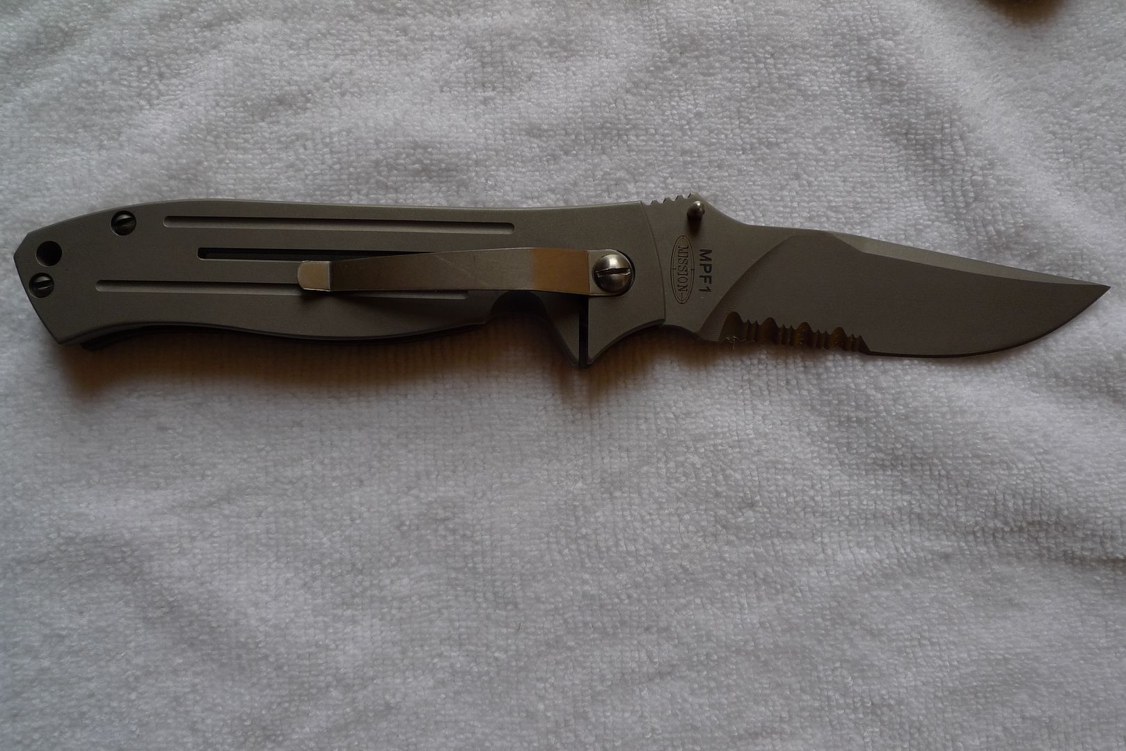

I noticed his and my markings are different. Is mine just older?
(just saying, that's not a swastika. :P Came on the knife when I got it.)
It's funny how the word fake has become such a prominent word in the knife community. I was thinking the same thing Military Issue, I think your going to like this one.
The knife was issued to the USAF bomb squad EOD and passed the magnetic flux density tests required by the Department of defense in order for this item to be used in the field (Non Magnetic per MIL-M-19595)
When this mandatory test is completed, Items tested must be engraved and verified as seen on this knife. (;’ 2.99)
