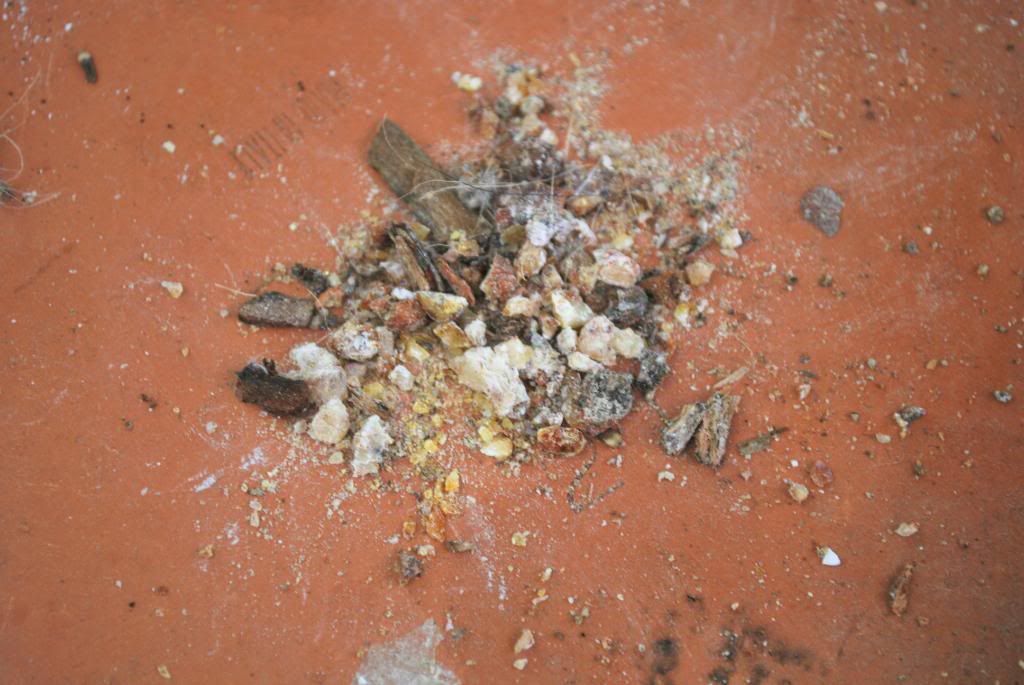

Okay, resin bearing trees are not a plenty in my parts, but there are a few around and I tend to know where they are. There is a lonely scotch pine in my prairie and on my way back I took some of the resin found in this little hole.
I brought some of the scrapings home and just this afternoon I was fooling around with it using a firesteel. I practiced in a terr-cotta pot holder so that's the red colour of the background.
Broke up the chunkies into a bit of powder

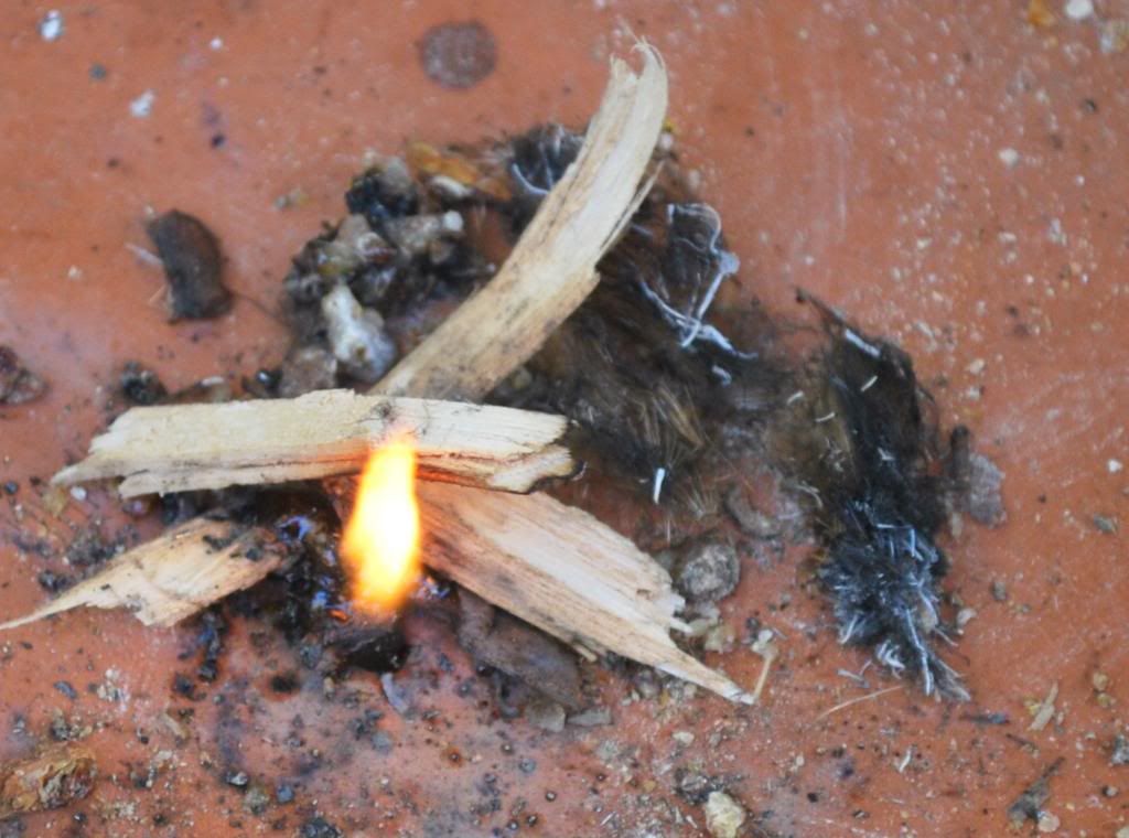

This stuff wouldn't light on its own with the fire steel, but it did liquify and turn into black goo
I smeared the goo on some wood chips and continued to scrape at the fire steel. Once I got flame, the goo then acted as a pretty good little fuel, sustaining the flame and helping get the wood chunks on fire.
I imagine that the water content of the resin plays a big role in its flammability. However, lesson learned here is that if you can get the stuff warmed up enough to spread it then it seems to work very nicely. Fatwood is much easier to light than this stuff but then again it really likely depends on the quality of the stuff you harvest.
