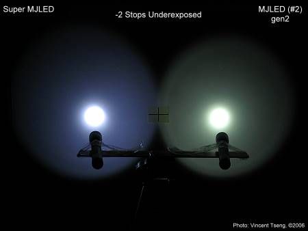

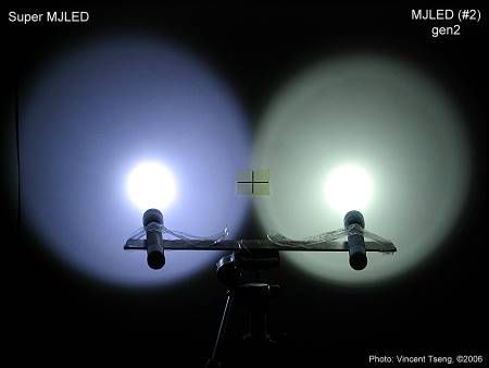

This is what I got from my review
super MJLED drop-in for MiniMag 2AA (link)
current draw readings using 10A scale -
Duracell set open-circuit = 3.03V
PairDeer set open-circuit = 3.06V
Super MJLED
D = 0.03A or 25.7mA on 200mA scale
P = 0.03A or 22.7mA on 200mA scale
gen2 MJLED (my #2)
D = 0.03A or 26.3mA on 200mA scale
P = 0.04A or 27.5mA on 200mA scale

The Super MJLED's are definitely significantly brighter than the original (gen1) MJLED -
the gen2 MJLED's were quite a step up from the original.
I could not see much if any any difference in brightness of the Super MJLED over the gen2 MJLED's
superMJLED vs. gen2 MJLED (my #2) (link)
The brightness seem about the same - if anything the gen2 might be very slightly brighter - and it's on good but used AA alkalines and the Super MJLED is on fresh alkalines.
Ref: super MJLED drop-in for MiniMag 2AA (link)

Yeah, I've seen that comparision on CPF. But looking at those pics and comparing to my beam makes me think mine is actually an SMJ. Its the Arcmania MJLED drop-in sandwich.
But it could just be color descripencies on my monitor (laptop)...
With all due respect to you Vincent, and those are fine beamshots my friend- allow me to counter with my own comparison of the three gens of MJLED as profferred to me by Kevin Fritz of Lambda fame >
http://www.imagometrics.com/FLReviews/FL_Stuff.htm
As we all know, the term 'brightness' is vague. In the case of the SMJLED it seems to be the combination of the blue-er hue and slightly bigger hotspot combine to make the whole beam seem brighter. I still prefer the Gen2 version my self. BTW, I've never seen the MM drop ins- mine are all MODs to the Keymate or bare emitters that I drop into MM's ;)
