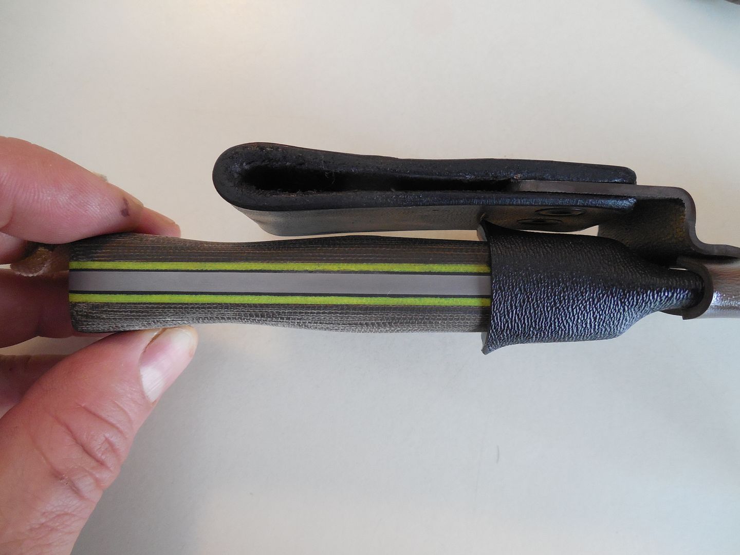

The handle is micarta with liners.

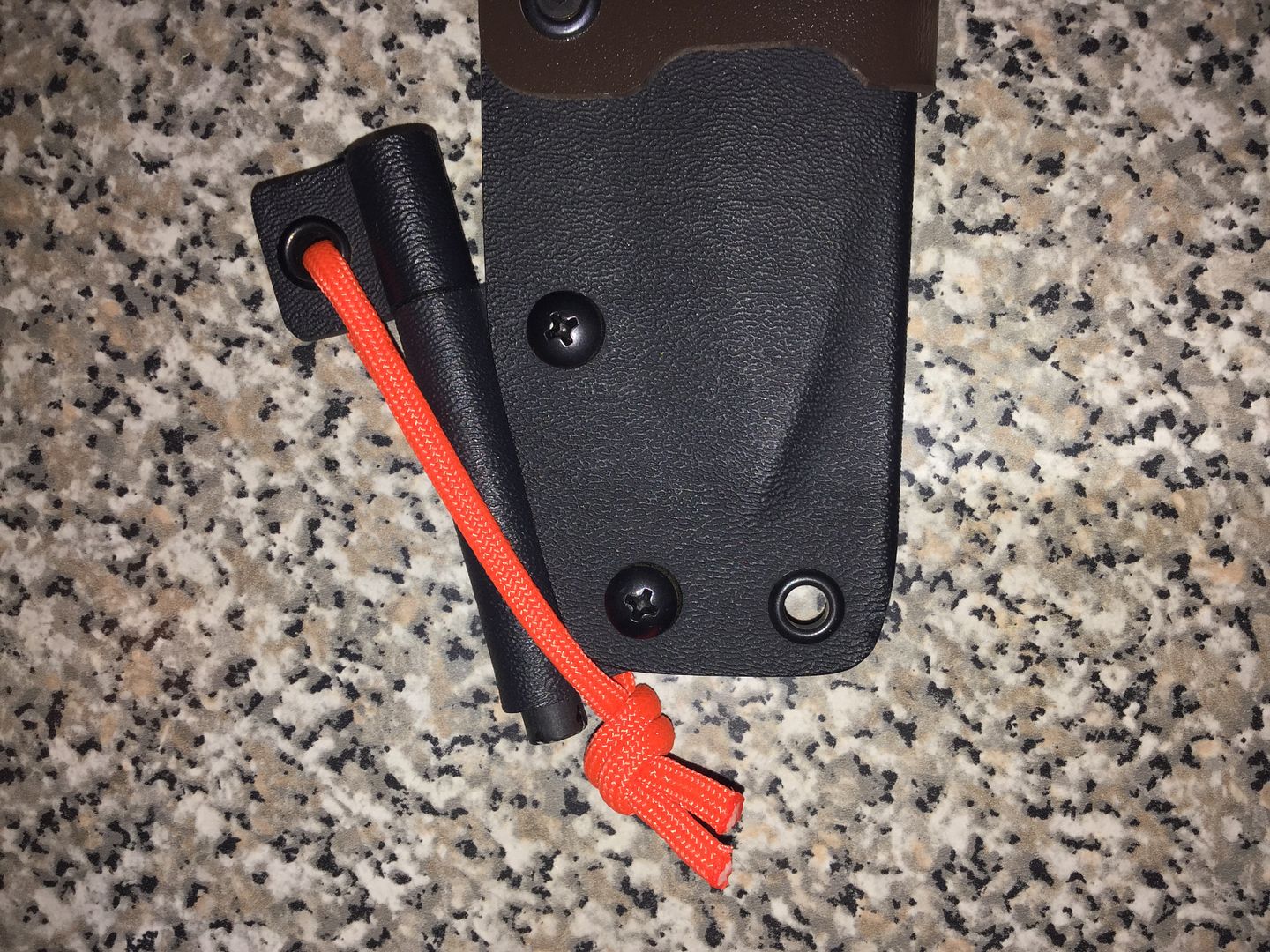

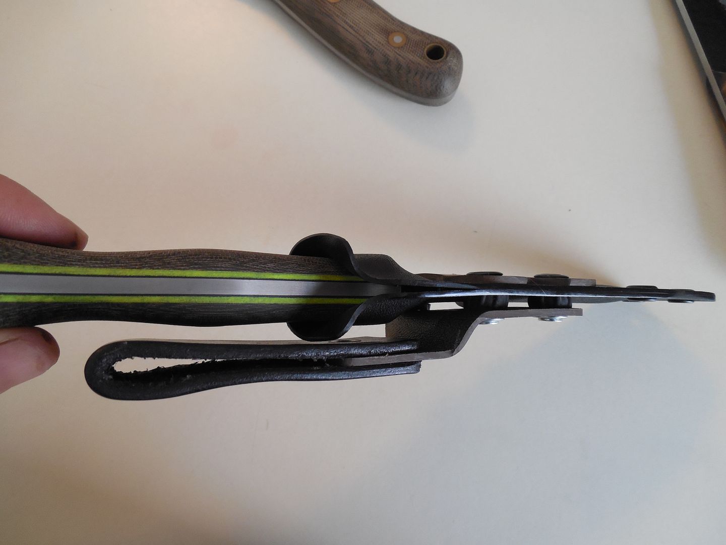

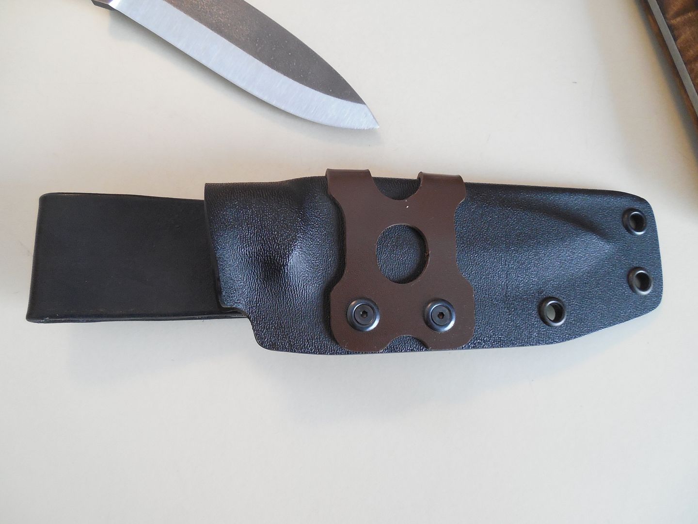

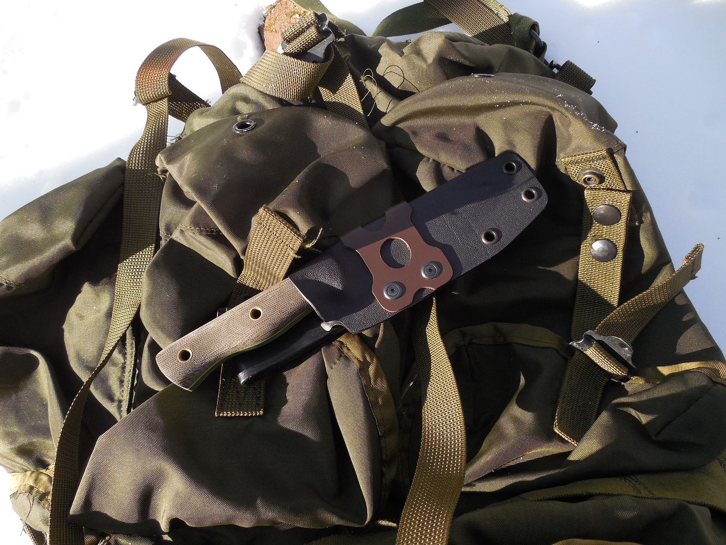

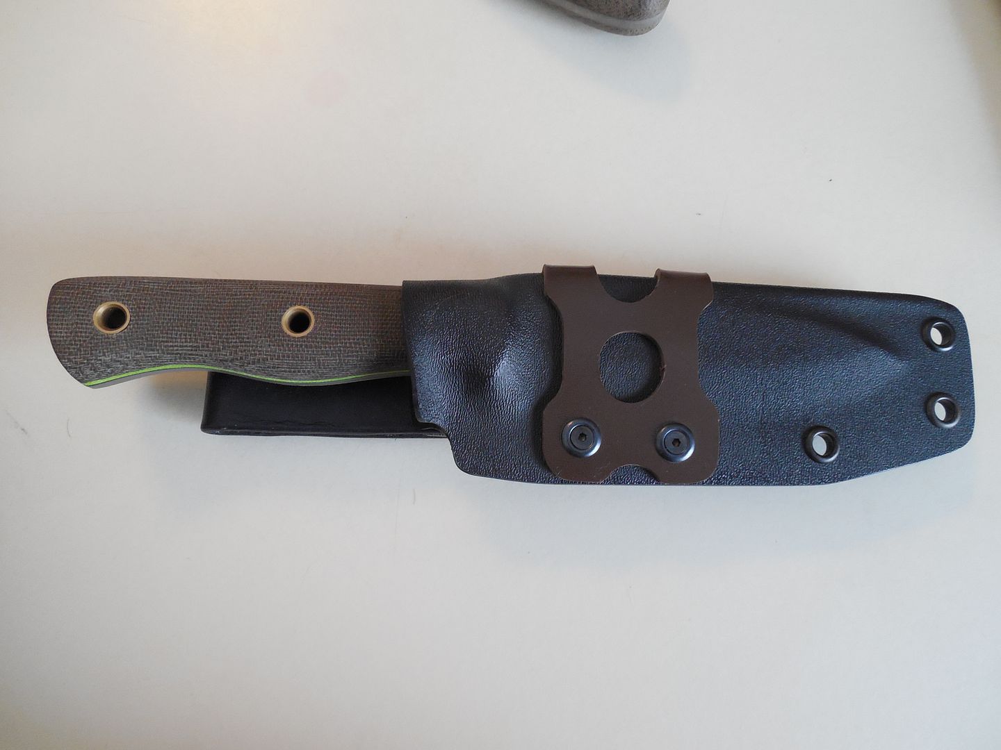

The sheath is Kydex with a leather belt loop. Seems like .060 Kydex.
Nice job.
The grommets are properly spaced for standard 1.5 Tec Lock. This means some accessories that I bent for standard spacing will work.

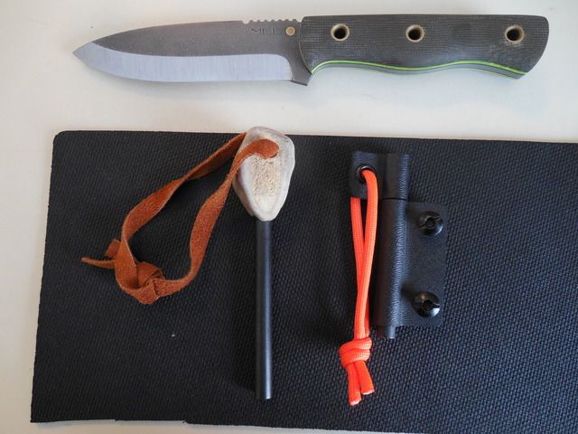

But for this initial field test and the challenge outings I decided to honor the spirit of generosity by using a ferro rod which was gifted by Keyser Söze also of Bushcraft USA. I feel humbled by such generosity and hope to do right by these tools.

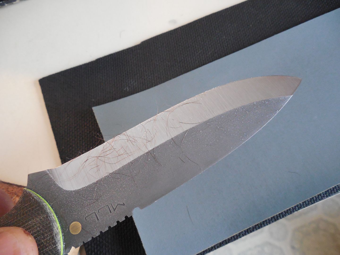

The knife was brand new but didn't come shaving sharp. The guessing saber grind seemed even and well done so nothing more was needed that a little touch up with 2000 grit and soft pad plus strop. There is what looks like a fine secondary bevel so convexed that a bit.
Now that's what I like to see.
Lower blade.
Upper blade.

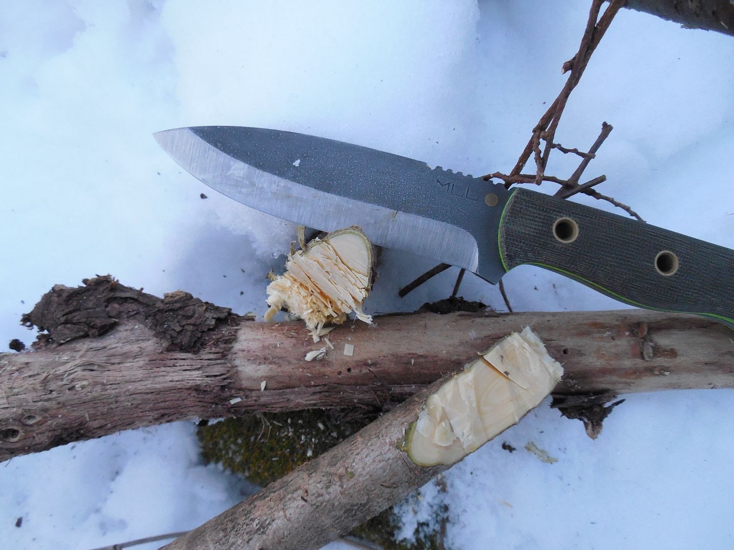

A sick and beat up looking hardwood sapling. I will be needing this for two uses. 1. Hiking staff that won't break. 2. Pot hook support that won't burn.
Knife took it down in short order.

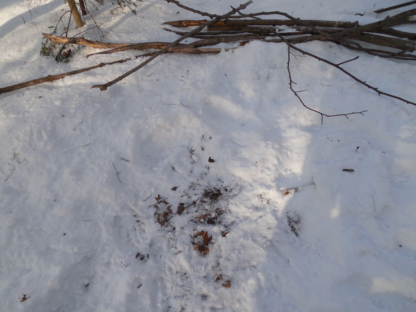

Starting a twig fire platform. I will use wood of lower quality such as stuff found on the ground for this if supplies are limited for the base.
A twig fire employs what's in nature to save on work. Rather than thin split wood and/or feather sticks thin twigs and other smaller kindling are often used along with fine tinder. That said split wood fires, shavings and feather sticks are good skills to practice as sometimes the pre mentioned materials aren't around but this wasn't one of those times. Less work in the cold wind the better.

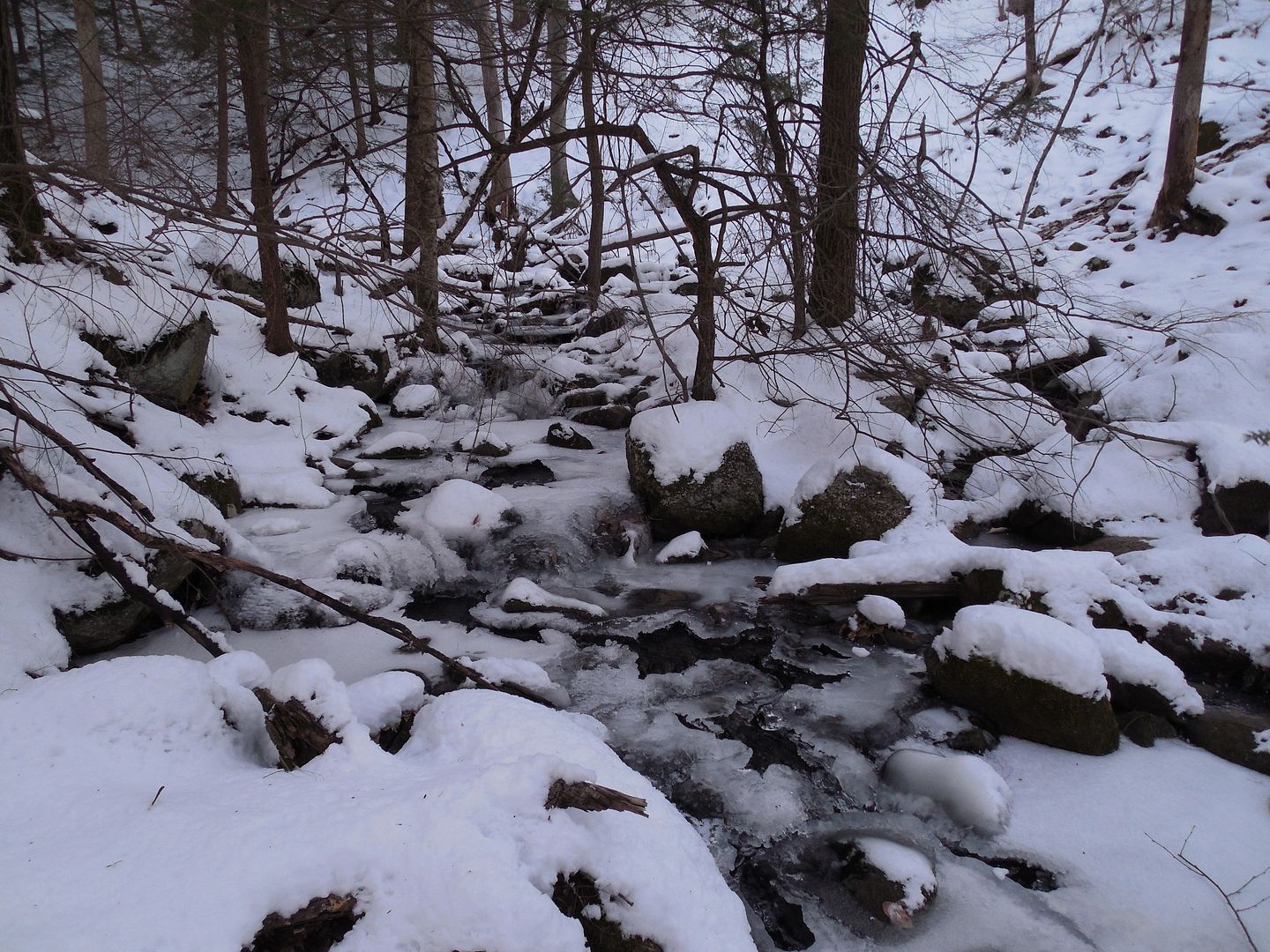

I started to think about my kettle. Was surprised to see flowing water not totally covered over by ice. No doubt it would soon freeze but maybe I could save some time by using the kettle as a canteen once the fire was going? I didn't feel like trying to walk around with water so considered coming back later. Cold is a stern but beautiful mistress.

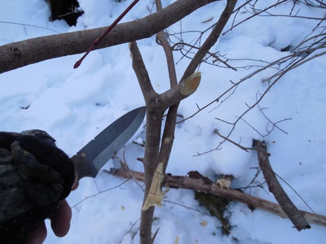

I think this shrub thing might make for a good addition to the pot hook support.
Using the tool for exactly what was needed and nothing more.

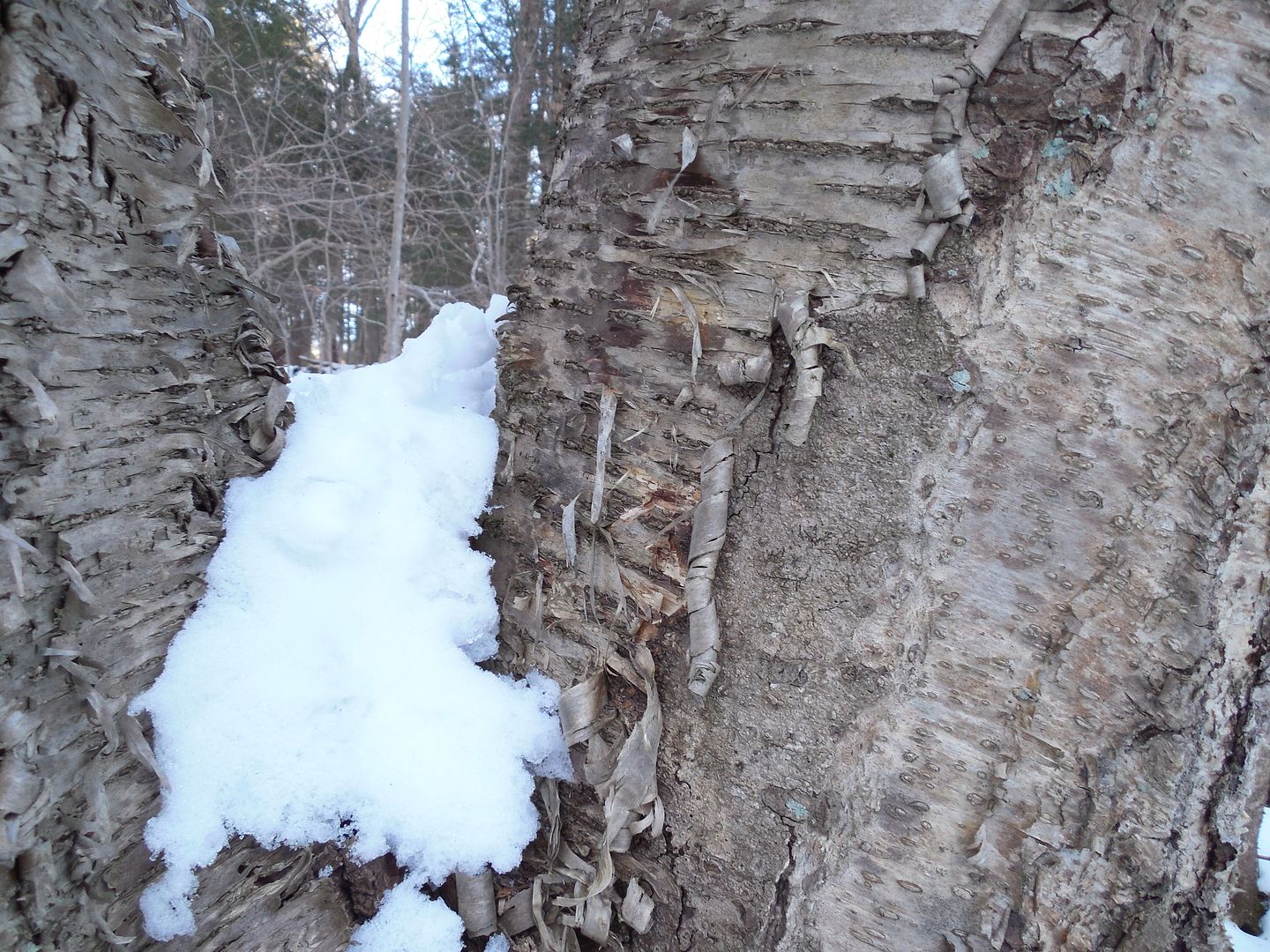

Now this is what I wanted. Yellow birch! I don't have any packed tinder but nature's very own aromatic hydrocarbon are nearly unbeatable.
I will be taking some of the hanging bark.

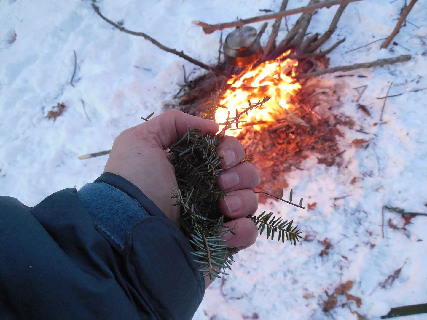

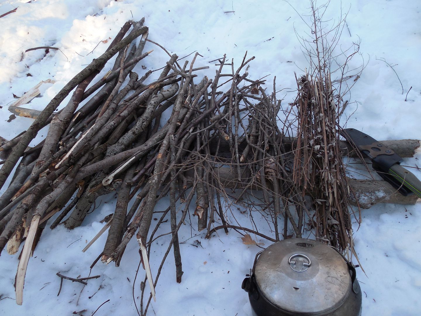

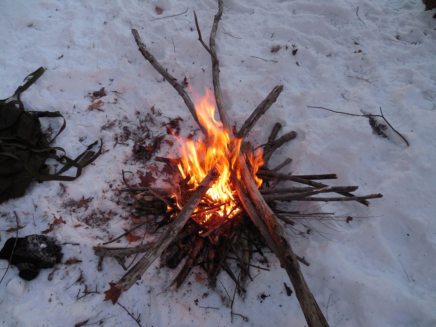

Back at my day camp with wood prep done. I used my hands and feet to break up the wood.
I used the knife's spine to strike the ferro rod. The maker did a good job by leaving the spine sqaure enough to toss great sparks. I don't like when field knives are sold as bushcraft blades with rounded or coated spines. Just more work for me getting the knife ready for use. So giving MLL an A+ in this department. All that said if someone really needed they could use the blade. Done that for years using other knifes and the world didn't end. Heresy, I know....
A short video of the fire starting using the MLL knife and gifted ferro rod. In firecraft the prep work is every bit as important as the ignition IMHO.

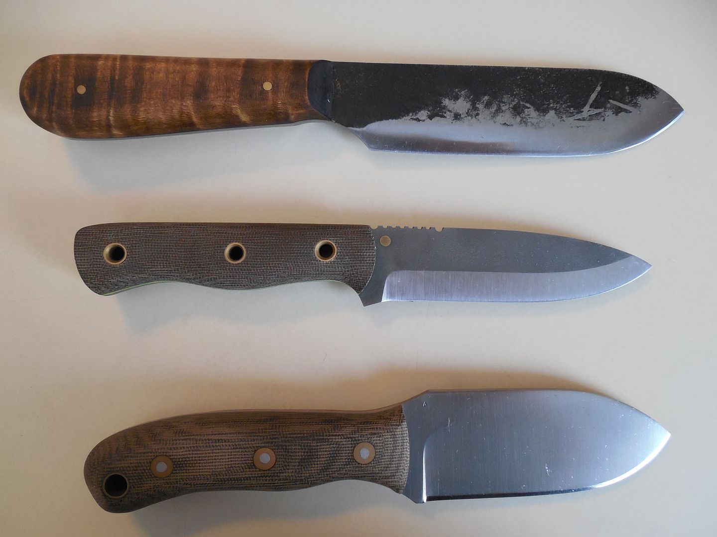

Size comparison with some other Bushcraft knives.
The JW curly maple on top is at the larger end of the midsize class of what I carry for a bushcraft field knife but it's a user. The BHK Bushpig has been languishing in a safe. A wide stout knife that after a few outings just kinda got left behind. Not sure why as it's a great knife. Maybe too heavy for it's intended purpose? Not sure. LOL! Might just take it out for another spin. The MLL Amazon is small enough for easy packing but IMHO has enough blade for work.

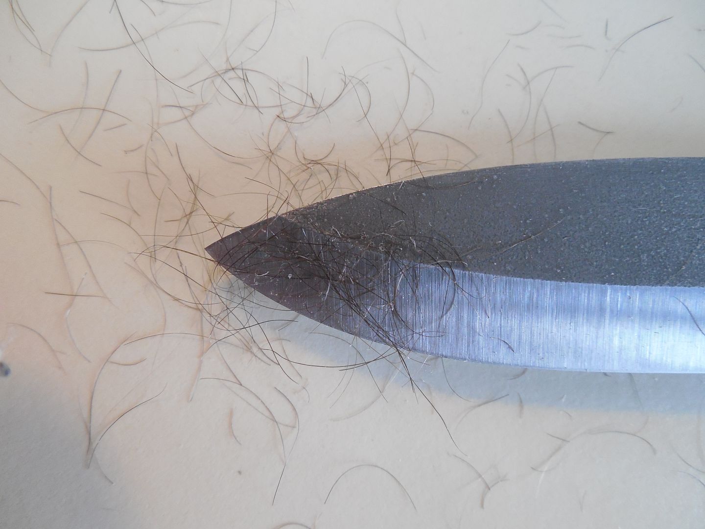

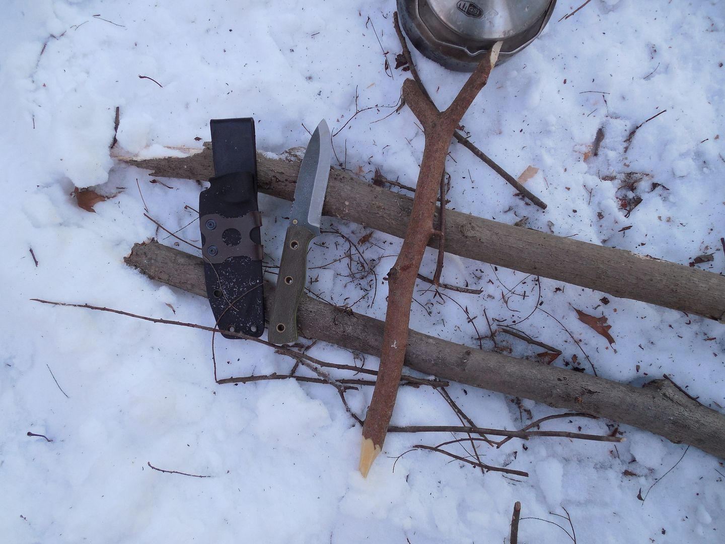

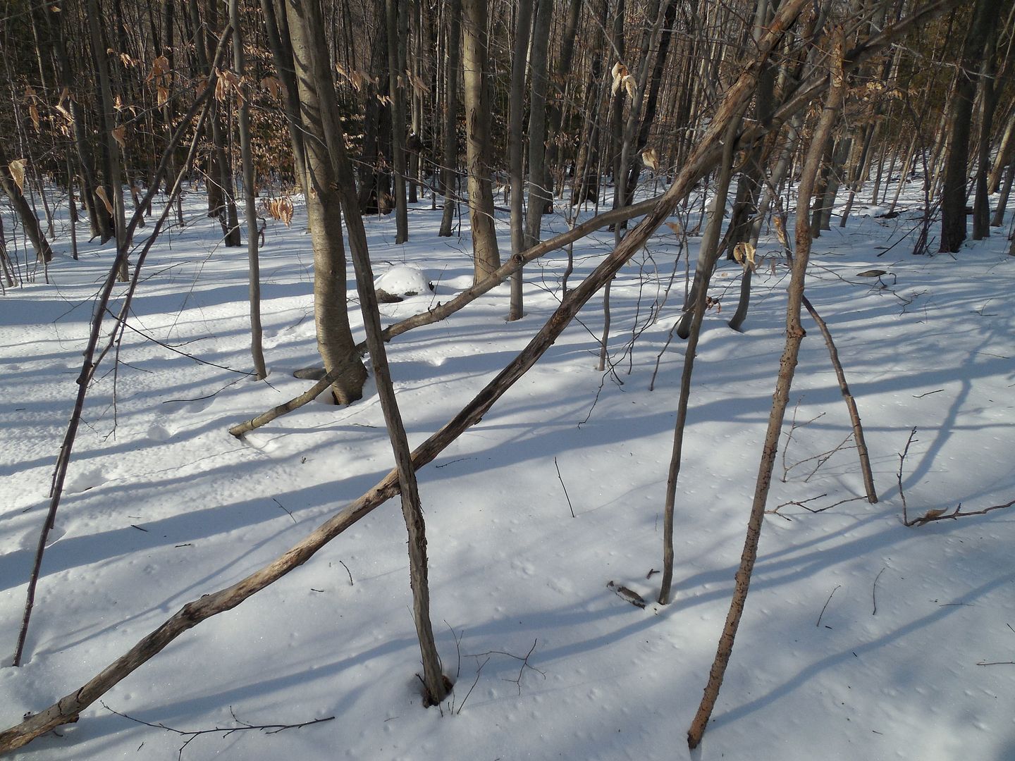

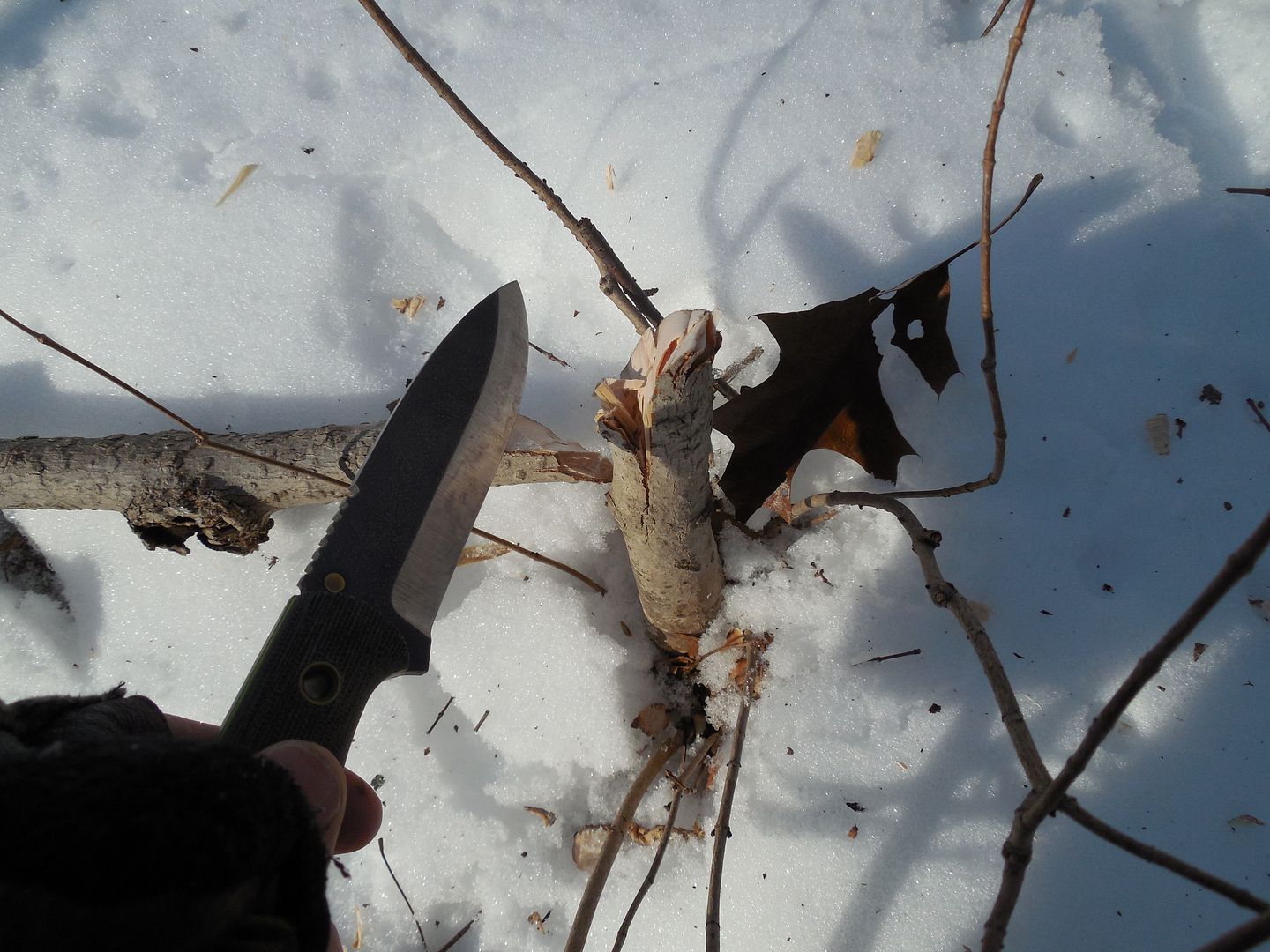

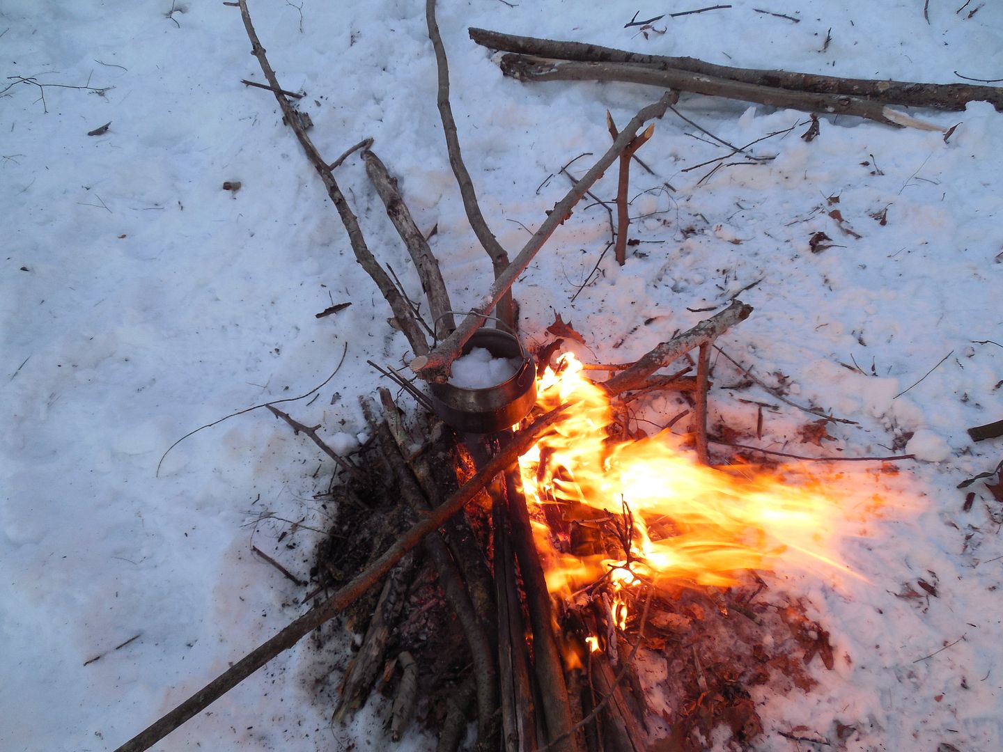

Lower blade.
Upper blade.
