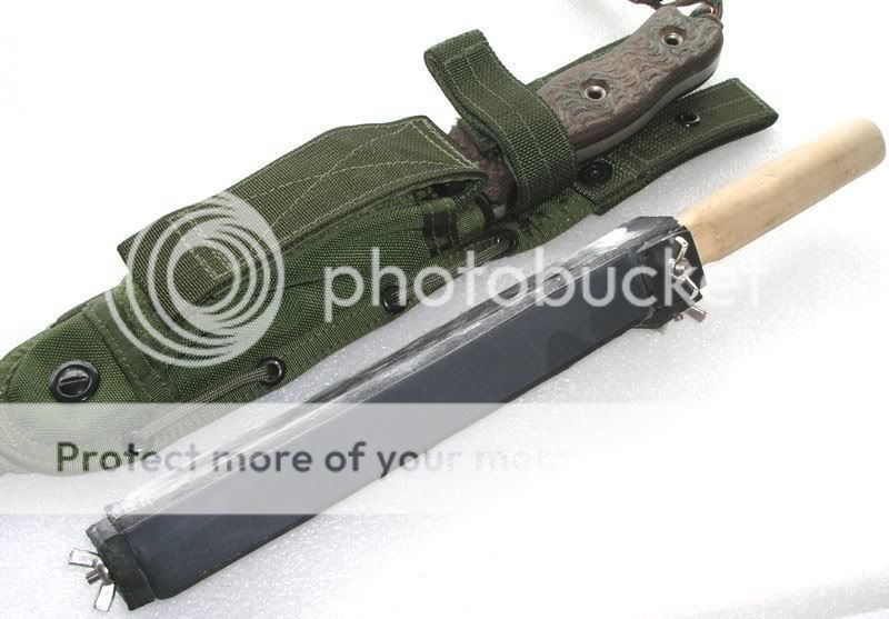

I tried the mouse pad and sandpaper approach sharpening my knives some time ago. Since it has worked great for me, I wanted a slim mobile solution I could bring with me in the backpack. :p

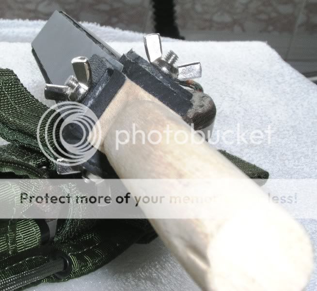

So I took a rectangular piece of wood, rounded off a part for handle and then glued strips of mouse pads on 3 sides and a piece of leather on the 4th side.
Then I added some screws so it’s easy to attach and remove the strips of sandpaper. I have so far used 220, 400 and 1000 grit. Then I use something called Autosol Metal Polish. I apply it on the leather and let it try before I give the edge a final workout. Works great! :thumbup: :)
But pictures say more than words:

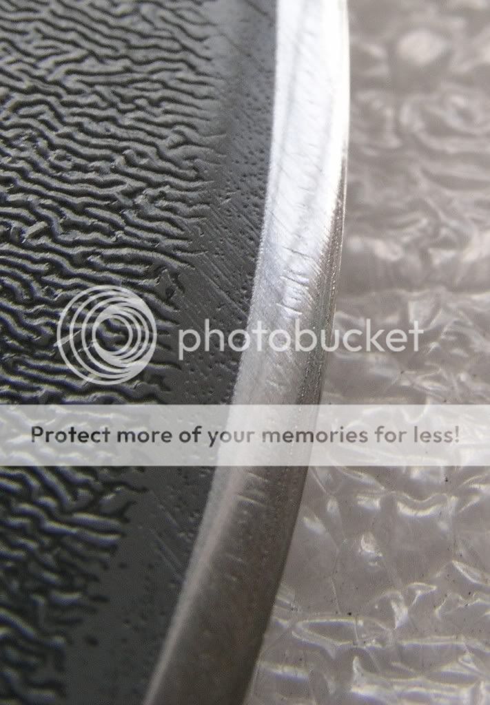

Then here is a picture of the edge as promised. This is my BATAC CG since my FBMLE, BATAC LE and Custom AD- all still have the factory edges. All are users, but have so far only required light tough up on the leather strop. :thumbup:
I have not gone for the most beautiful edge here, but as long as it’s shaving sharp- I am ok.
