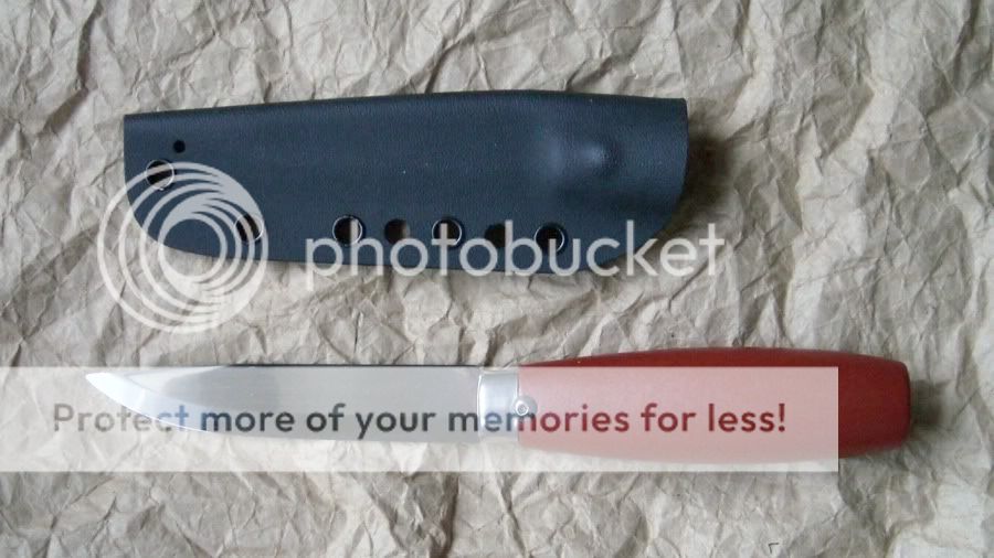

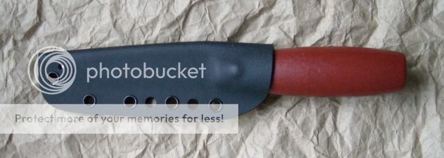

So, I have had a number of requests to know if Kydex would work with traditional Moras...
And the answer is, as stock, not really...

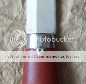

But, with this mod, which I had seen a guy do, Kydex can work pretty good. Basically, it is the addition of a Button Head screw to the handle, in the wood, right at the ferrule. Pretty easy to do with a just a few tools.
