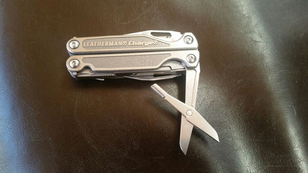

Modded another LM, this time had a pretty good injury. The wingman scissors I was drilling slipped and spun around cutting my finger pretty bad. Here are the pics, basically same setup as my moded waves.
Charge tti
wingman scissors on outside in place of saw

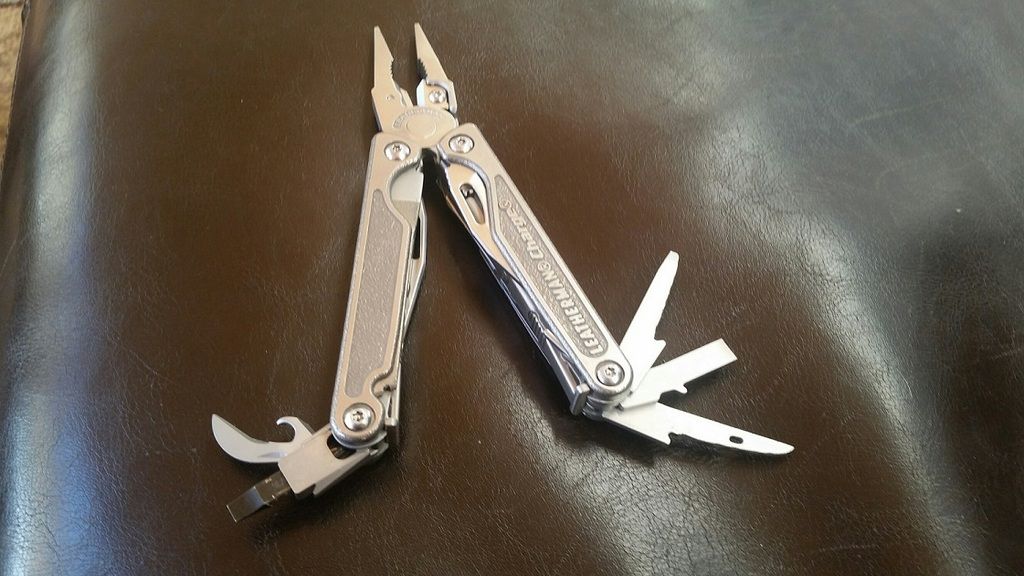

rebar awl
rebar plier head
rebar small long screw driver
removed stock internal scissors
removed eye glass screw driver(you can use it with out the driver..)

Sorry about the injury but the mod looks cool. I was wondering how hard the pliers swap was--I was considering getting a Wave and doing the same, and I've already got a Rebar.
Swap is pretty simple, need to either remove or trim the scissors and the awl if you add it so the handles close fully. Also may need to trim the detent on the outside blade as on some tools it will catch even with the tool closed. If you need a hand shoot me a pm or let me know here and I can post more pics or try and explain more if needed.
Josh
Nuts. I was hoping it was a drop-in, like the knife blades. I'd have no problem losing the scissors, but the awl would be a loss. Thanks for letting me know, though.
