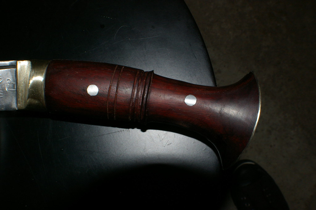

Just thought I would share in case anyone has had or is having the same problem I came across.
I decided to mod my Tirtha M43 handle to remove the rings that were a beauty to look at but not so comfortable for practical use. As per a previous thread, the rings seemed to be made more for looks than comfort and felt as if they would cause blistering in the hand after extended use. I also trimmed down the handle enough to fit my grip more.
Tools used:
Dremel Pen attachment
Sanding wheel and Grinding wheel
100 grit sand paper
250 grit sand paper
400 grit sand paper
Tung Oil
Before the modifications
After the modifications and 1st layer of Tung Oil. I plan to use another 2 then do some sanding with 400. Notice the reddish color of the wood after just the first layer of tung. Almost blood red ;)
I'll post a pic of the final product and review in the next few days.
Looks great! I was actually afraid of how it would turn out when you expressed some trouble you ran into in another thread, but it looks perfectly done. Cheers!
Pretty Rosewood (or at least what looks like rosewood) grips! You're doing a good job. Please keep the pictures coming. In my opinion, an M-43 should have a curved handle and no rings. Me Likey!!

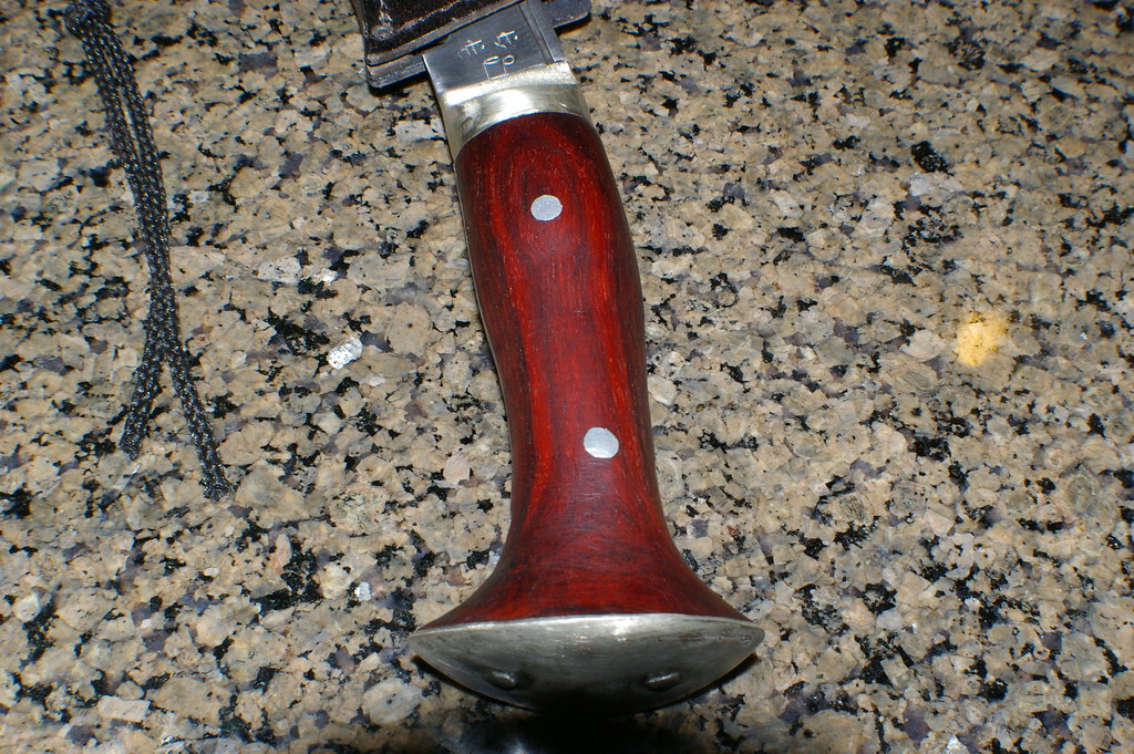

Thanks for the comments folks. I'll have a review in the next day or two after I put it up against a tree on my hill. Here's the finished product. Just got done buffing it by hand. I went a 4th coat of tung and used a run of the mill clean kitchen cloth for the buffing.

Your right. It was fairly easy sanding the handle down to preference given how thick it already was prior to removing the rings. I really did think about keeping the grooves on the handle but my hand wasn't steady enough on the dremel for me to keep them straight and I tend to try to perfect something like that to the point where I make it worse than before I started. Now that I know the original M43 had them it makes me want to turn back time by a day or so!
The new grip is extremely comfortable. In my garage I actually test swung it forward a handful of times and noticed my hand no longer felt as if it would lose grip on impact like it did prior to the work. The buffed Tung on the wood adds a little grip onto the handle as well. I think I now know what the M43 is all about.
