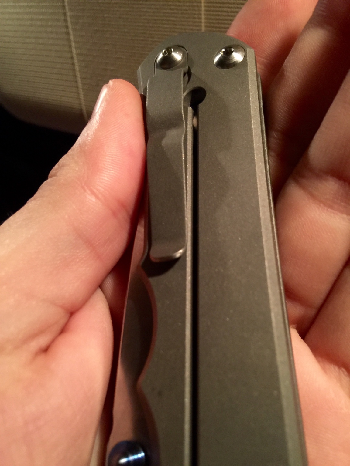

So, after posting the thread a few weeks ago about what options, I was considering a few things. Either the Hawk clip from the Ti lock, a third party deep carry clip which I didn't like, and didn't really want to bother making one since it seemed harder than it looks for this particular knife after closer inspection and thinking about it. So, I decided to order another sebenza clip to try to mod. I did love the extra bend in the sebby clip.
I have been meaning to get a sand blaster, so this gives me a reason to go ahead. I was hesitant to grind the clip without the blaster, since I didn't want a polished edge on the tip or to ruin the finish and make it look horrible. I did ask Alicia at CRK and she told me they don't want to re sand blast a modded part, which I completely understand and probably a great business decision, so I gave it a try. I was figuring on buying the pressure blaster for other uses like I said, so if I didn't snap the clip bending it or anything, I am planning on blasting it all to match again but I don't think it came out too bad for now. In a few days I'll get around to it.
While waiting for the clip in the mail I was doing a lot of figuring with the clip on the knife in hand, to see exactly what I needed to do to make it work for my fingers. I thought I was going to need to bend the clip more than I did, actually I only needed to put in in the vise and bend the tip just a hair up. This was after sanding some off the tip with my belt grinder, then finishing carefully again at the end with 220 by hand with paper on granite, just to be extra careful not to mess up. Since I think the 220 gave the better of the finishes of the edges for now, I finished with that. Obviously a higher polish would show more of a contrast with the dull grey blasted ti clip. It seems the extra long tip of the clip was what needed to be shaved down a bit.

Actually, I am rather surprised. I kinda tend to screw things like this up sometimes, but this came out perfect for what I was shooting for. The tip still raises just enough to get my finger tip under if I need to help it over a thick pair of pants, but won't have to risk of getting caught on stuff like it was before. Seems to work fine going in and out of my pants, and as far as difference in hand.........Oh man. This knife went from 99% perfect to 110%
The knife just melts into my hand again now, as if there was virtually no clip on it at all. I literally can not even feel its there. Actually fills the hand a bit more now than without the clip, and it is just what I wanted. I still have the original clip just in case, but man, I think this is going to be it. I will try her out like this for a few days and let you guys know how its working in every day use, but I am so happy with it right now.
No more pocket slip, and the comfort of NO clip.....equals perfection!!! The clip seems very secure.
Now, no matter how I grasp the knife, even if I try to get the clip to press against my finger, I can't! It's really feels like its gone.
Anyway, on to the pics. Can't get my crap phone camera to focus at close shots, so sorry but these are the best I got for now. Thanks for looking.
