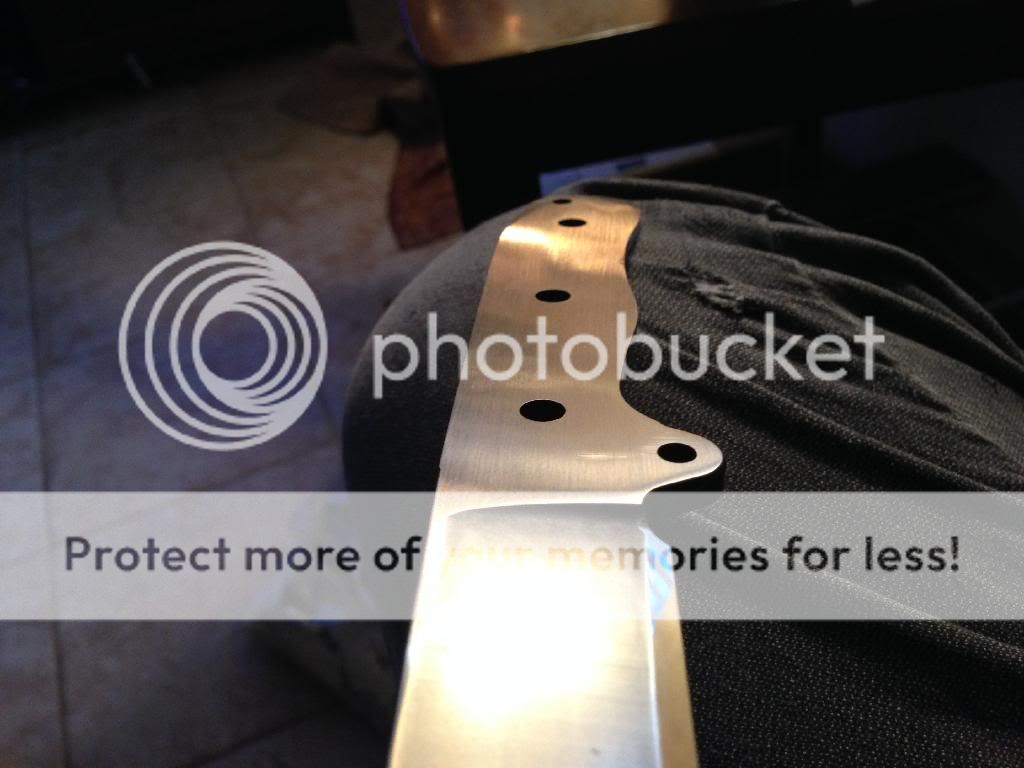

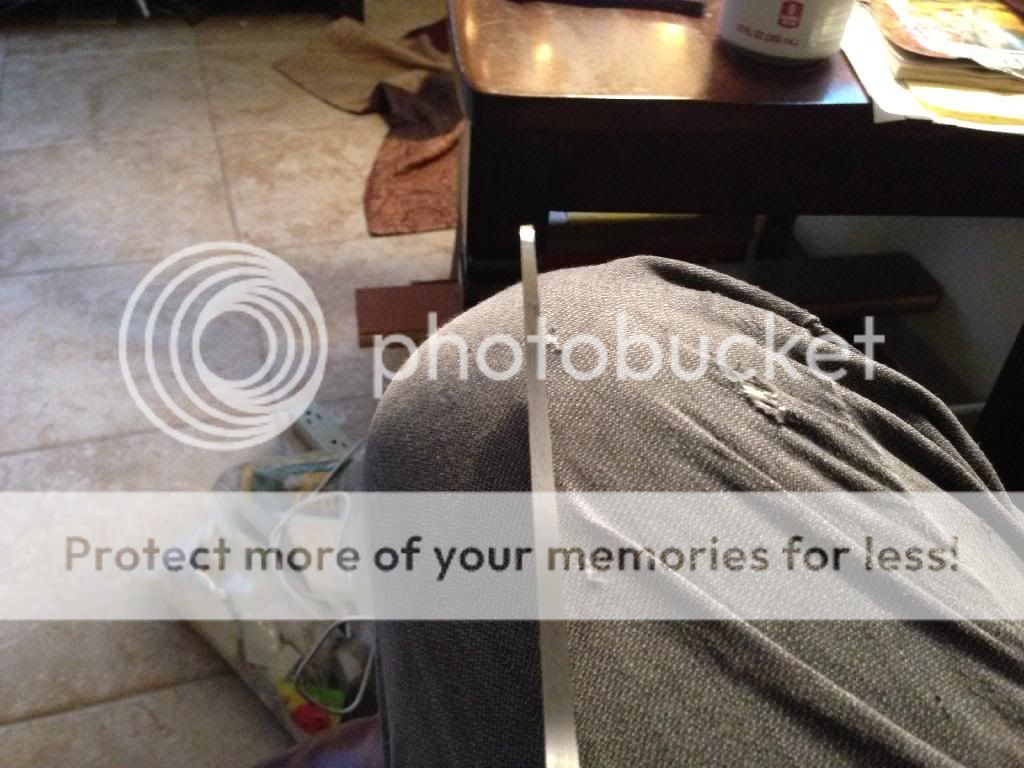

Lots of doubters out there lol. I finished with the initial stock removal last night. I ended up tapering the tang and it came out great. I worked slowly and dunked the blade often, so the cutting end of the blade never got warmer than room temperature. The knife started out weighing a very tang heavy 8.6 oz. Post grind weight is 6.8 oz, so I ended up removing about 1.8 oz just from the tang. It really improved the balance and feel of the knife. Point of balance was moved from midway between the 1st and 2nd pin hole, and ended up just in front of the first pin hole near the ricasso. I still have to finish hand sanding a satin finish, and re handling, but so far it's turned out great. I'll post wip pics when I finish. Thanks again for all the help.
Tapered tang
Looking good so far. You've got the right idea about keeping it cool. That's the key. But I have to wonder about drilling the handle. You're going to need carbide drill bits at a minimum. I worked in the Busse custom shop for 7 years and we always finish the knives out at 58-60 Rockwell. So the handle is as hard as the edge, and Infi isn't some simple carbon steel you can just draw the temper out of the tang with a torch.
