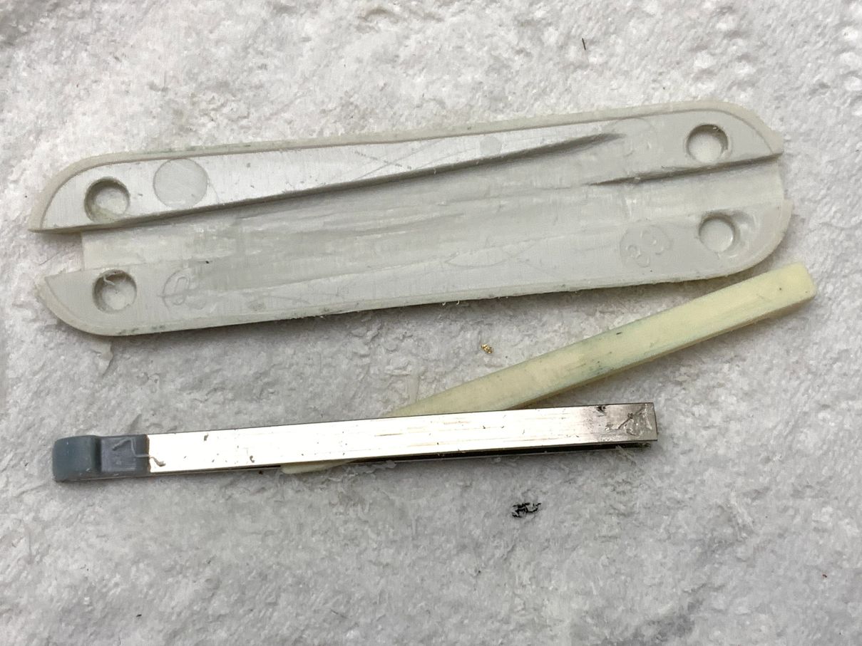

The tweezer holder is custom made from G10. The tweezers are held in place by their springiness. It should be possible to create a separate holder for the toothpick, but I think the tolerances would need to be a lot more precise to properly friction fit the toothpick.

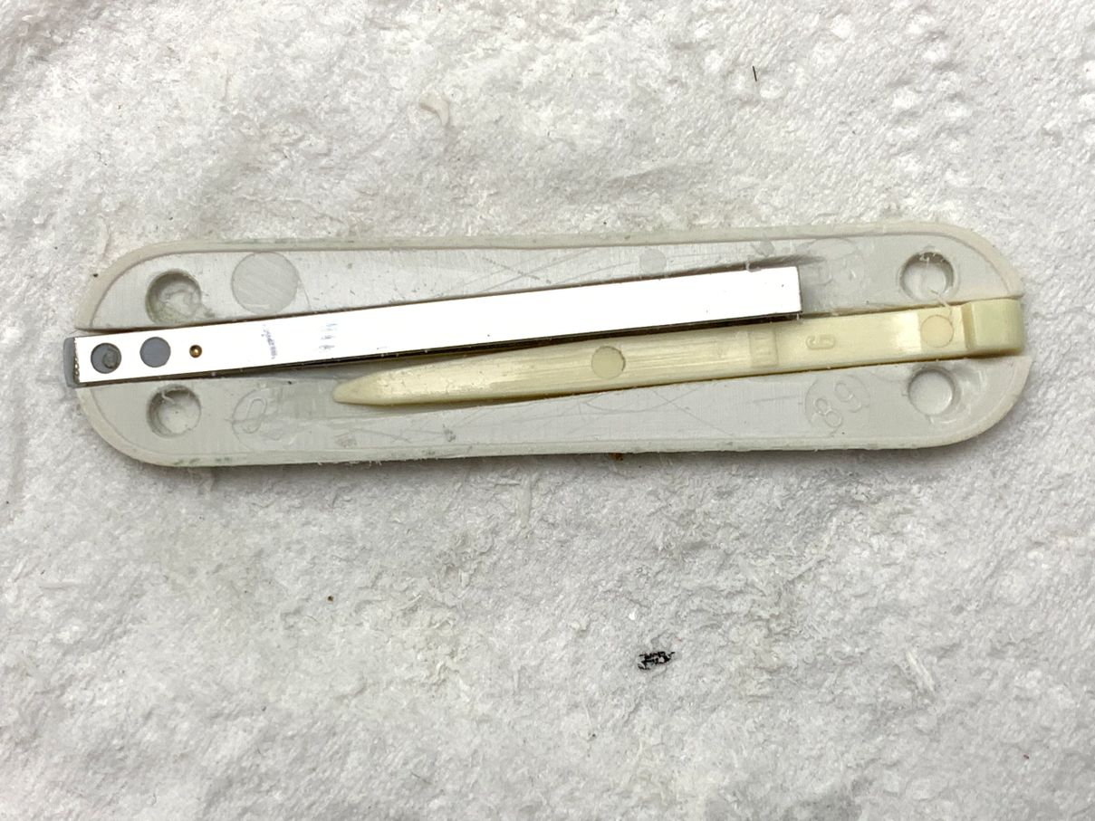

Did some measurements and the space could be made with a range of about 1.5mm-2mm increase in thickness overall. So 3 or 4 OEM nickel silver spacers could be modified to make the space. 4 would make enough room for the OEM T&T heads to sit flush with the cutouts needed in the alox.

My primitive cellidor example of the angled arrangement:
